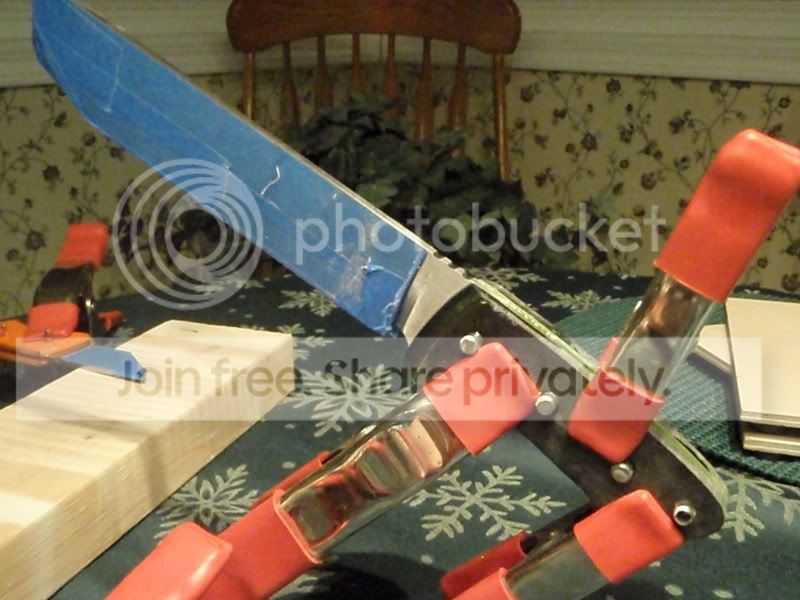

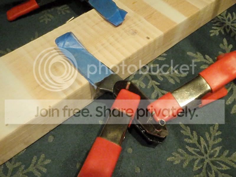

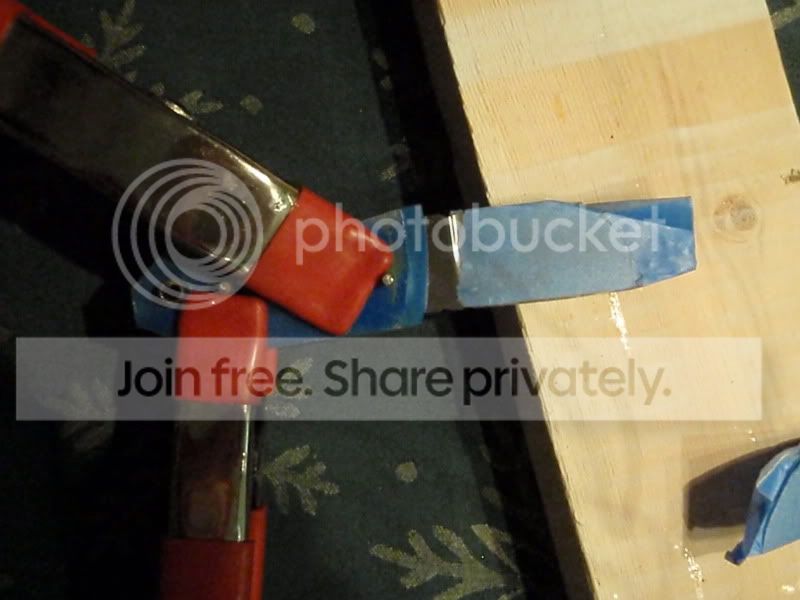

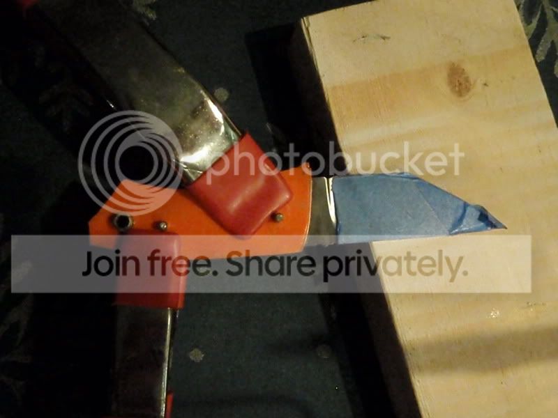

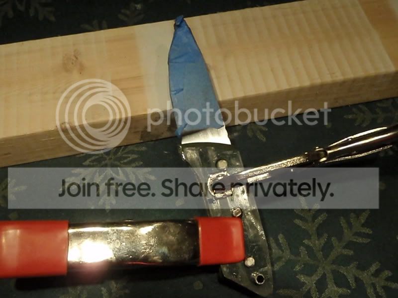

Another little update... So I figured I would spend "about an hour" in the garage after dinner tonight drilling and gluing up handles... that kinda turned into 3 hours.. and I only noticed because it got dark out lol
Anyways, these guys are glued up, cleaned with acetone in the ricasso areas and curing until tomorrow night! Should have 1-3 done tommorow evening... with the rest done by sunday so I can start bending some kydex and calling them complete!

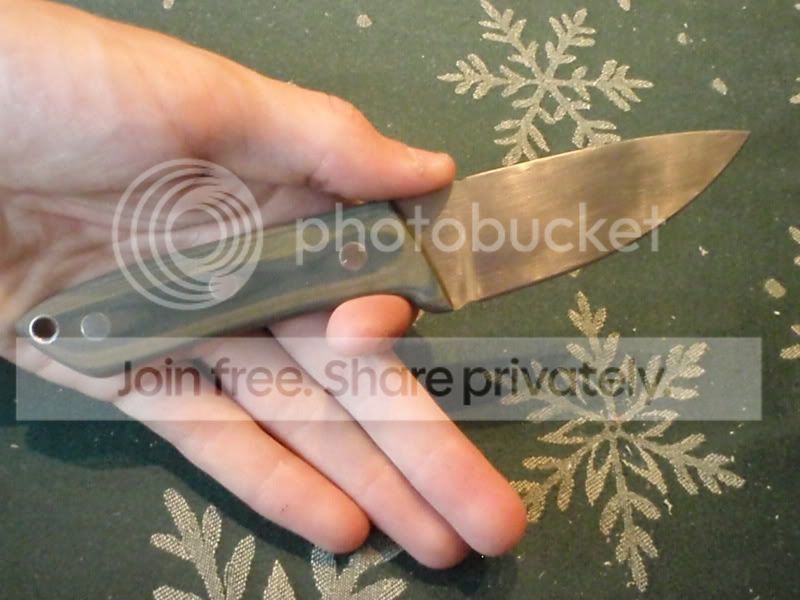

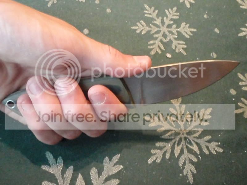

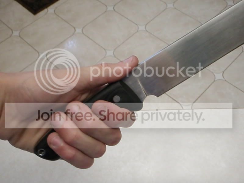

Cool, look forward to seeing those handles shape up. Something irks me about where your index finger will grip. It's like the finger choil area's angle is a bit gradual and doesn't look all that comfortable to grasp. It's probably just fine. I'll draw a picture to illustrate what i mean.
Frank and Tim, your advice has been heard/seen and used!
I added more relief cut to each knife suggested... and wouldn't you know it they feel that much better in hand. No more tendency or fear of your hand slipping onto the blade. Thanks for helping make my designs more functional!
Well my dad is back in town for 2 weeks so I've kind of been kicked out of the garage while he paints doors and whatnot... I did want to work on my handle finishing though so I set up around the side of my garage and went to town. 2.5 hours of filing, sanding... more sanding... and oh a little bit more sanding. The chopper is 95% complete! I did lots of the "shoe polish" style sanding at 220-400g which helped me get away from the "blocky handle" syndrome. That was a problem on my first two knives, and I think I remedied it this time around and you can tell it is a MUCH more comfortable handle.

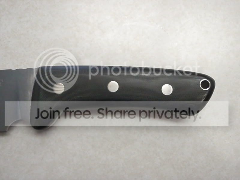

There are a few areas that need to go back to 220g and 400g again, but overall it is looking pretty good. There are also a couple spots with epoxy seepage... will address those when I get back to the shop, just too tired after today *phew*
I lightly countersunk the lanyard hole, since it had a fairly sharp burr on the inside and if there was paracord or any cord through it that would've snagged and torn it.

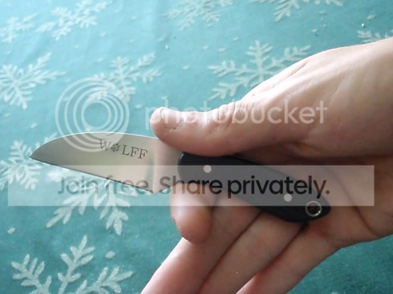

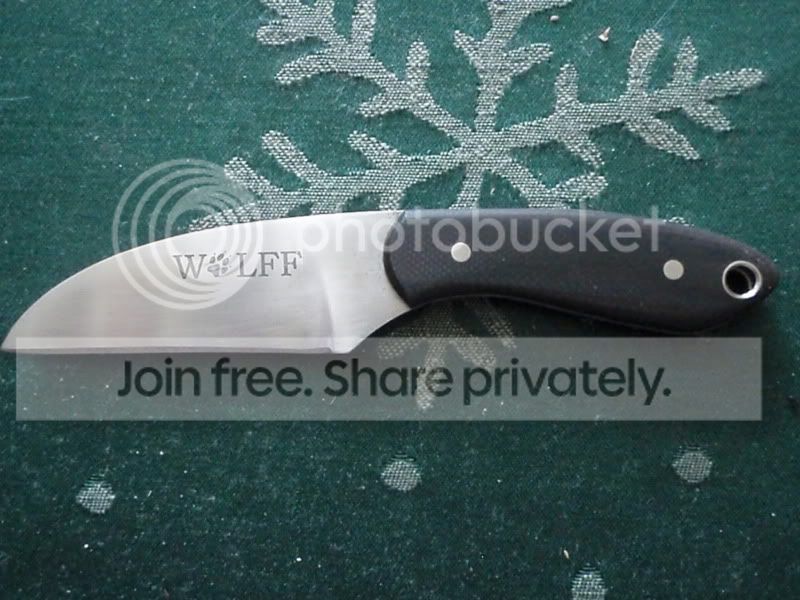

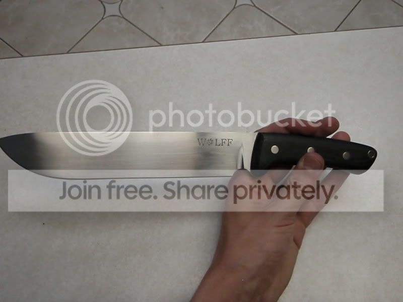

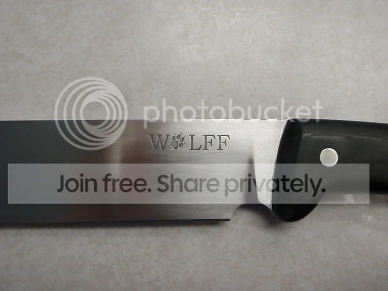

My etch turned out nicely. I got a bit of practice on a few scrap pieces of metal and I think I've honed my etching procedure to yield the results that I want.

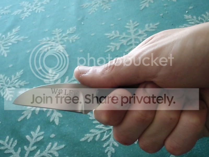

A few in hand pics... the front choil is great as a finger rest for choking up on the blade. Big enough that you don't cut yourself on your fore finger

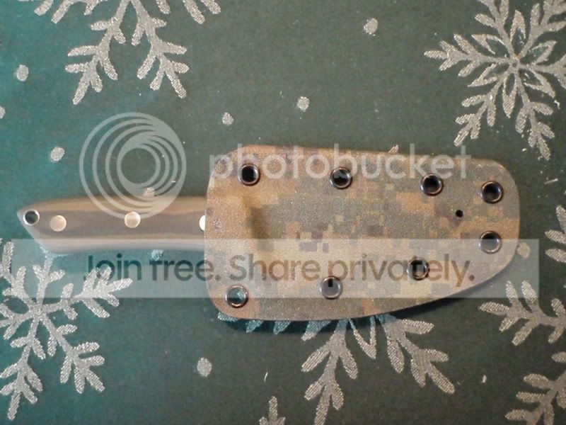

Once I get my heat gun later on in the week at KMS I will fit a black kydex sheath to this baby.... and then decide what the heck I'm going to do with it!

That looks excellent Johnathan. Your Mark looks super clean too. Which etcher are you using? And congrats on your new status.
Thanks Tim!
I'm using "the personalizer"... got it from Jantz. It's the basic model without the variable voltage
Here is my process:
1: Clean area thoroughly with acetone
2: Tape on stencil with electrical tape, and tightly press down the tape joints to prevent electrolyte leakage (had problems with this on my test pieces)
3: Etch on the "etch" setting 5 times, 4 seconds each, lifting for 1 second between each etch
4: Etch on the "mark" setting 8 times, 3 seconds each, lifting for 1 second between each etch
5: Etch on the "etch" setting 2 times, 3 seconds each " "
6: Etch on the "mark" setting 3 times, 3 seconds each " "
7: Remove stencil and clean with provided cleaner, and then acetone again on the mark
8: VERY lightly sand over the whole blade again at the last grit.
I found that the second etch kind of "locks in" the dark mark (even though it is technically removing metal again) and the final mark sharpens everything up. The final light sand just cleans up any discoloration around the etch. Just what works for me, I know everyone has their own process... and I'm sure I will have to adjust it when I move into different steels. I also found that using thinner makeup removal pads (that I swiped from my sister heehee) work a lot better than the provided pads. The ones it comes with are too thick and soak up too much electrolyte causing lots of bleed.

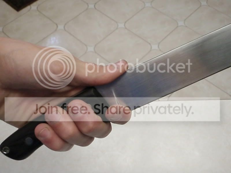

Unfortunately real life has kind of taken way too much time out of my day to get any real shop time. The chopper is 100% finished with a kydex sheath... just contemplating what to do with it haha

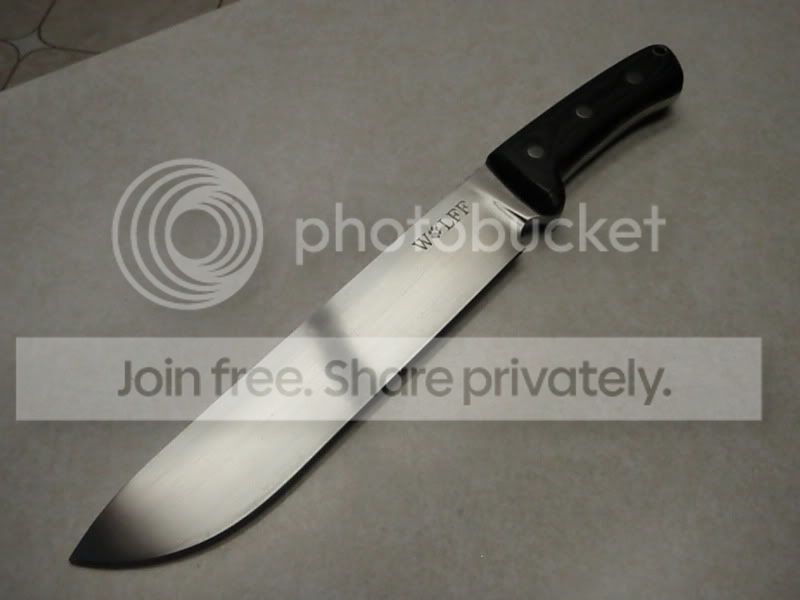

Hey guys, time for the update I promised!
The wharncliffe is all done! All except for the sheath and final sharpening that is haha.
I am absolutely in love with this knife... I just can't put it down. I had my buddies over today for a few brews and they were confused as to why I couldn't stop fondling it and just holding it in my hand :D This design definitely has a place in future batches, and hopefully in a bigger version at some point too! This is my perfect EDC utility blade, I will carry this all the time once the sheath is made!
All I am disappointed with on this one is the supposedly "red&black* G-10 that I got from Jantz. I can't see any red in it... and it clearly doesn't show in the pictures. It is only when held up to a bright light that you can sort of tell that it is layered in a very deep and dark crimson red. Not the look I hoped for... but I'm happy with the knife anyways. Methinks AKS is my new go-to place for handle material. Great selection, great prices and you can't beat their service (not to mention fast shipping from just a stone throw across the pond!)

Looks good Wolffy. I'm yet to make a warny. It looks like a real handy little blade and I think the plain black looks good.
Thanks, it looks like the Harbour fright version, but without the US to Canada shipping and customs-

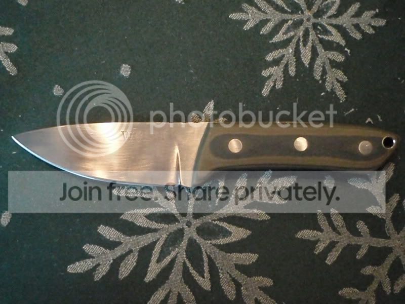

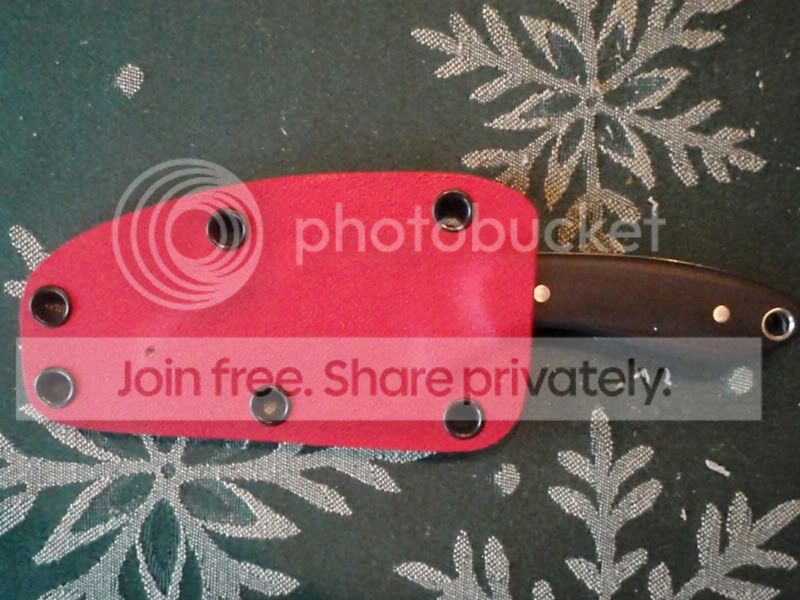

Rained out of work today (oh yes I was sooo disappointed to get shop time :rolleyes:) so I put some red kydex pants on the wharnie and got the bushcraft model all finished up and with a sheath too!

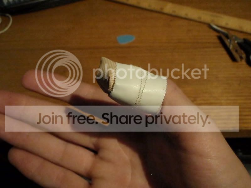

I also took a good chunk out of my right thumb... doing something very stupid. The knife wasn't even sharpened yet, but kind of pointy... so while fiddling with the initial tight fit on the kydex sheath I tore into my thumb about 1/4" and had basically a piece of it hanging there. Zero pain to start, then it started gushing.... and gushing.... and my sink looked like a murder scene. Unlike most injuries I get I wasn't thinking to take pictures... I know how much people love to see them :D. But here I am... still alive... thumb throbbing O_O. If I get brave enough later I'll change the bandage and see what kind of picture I can get for you guys lol
That's all for now. 2 left, then the batch is done! As much as I like the one I finished today... I may sell it... or I have a friend with a birthday coming up so he is going to get one from this batch most definitely
