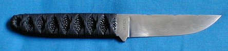

Wally Hayes was the author of my first forged blade from a Master Smith. I had ordered one of his stock removal (neck) knives from an ad in one of the knife rags...but he got in touch with me and asked if I would mind if he made a forged knife for me instead (no price increase) from some of his damascus he had on hand. And so, a friendship was forged. (Pun intended.) What a great guy.
Sorry for the diversion, Lorien, but I figured your fellow Canadian deserved some recognition for being a great guy.

it's always cool to see Wally's work, no apology required
