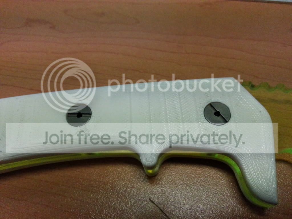

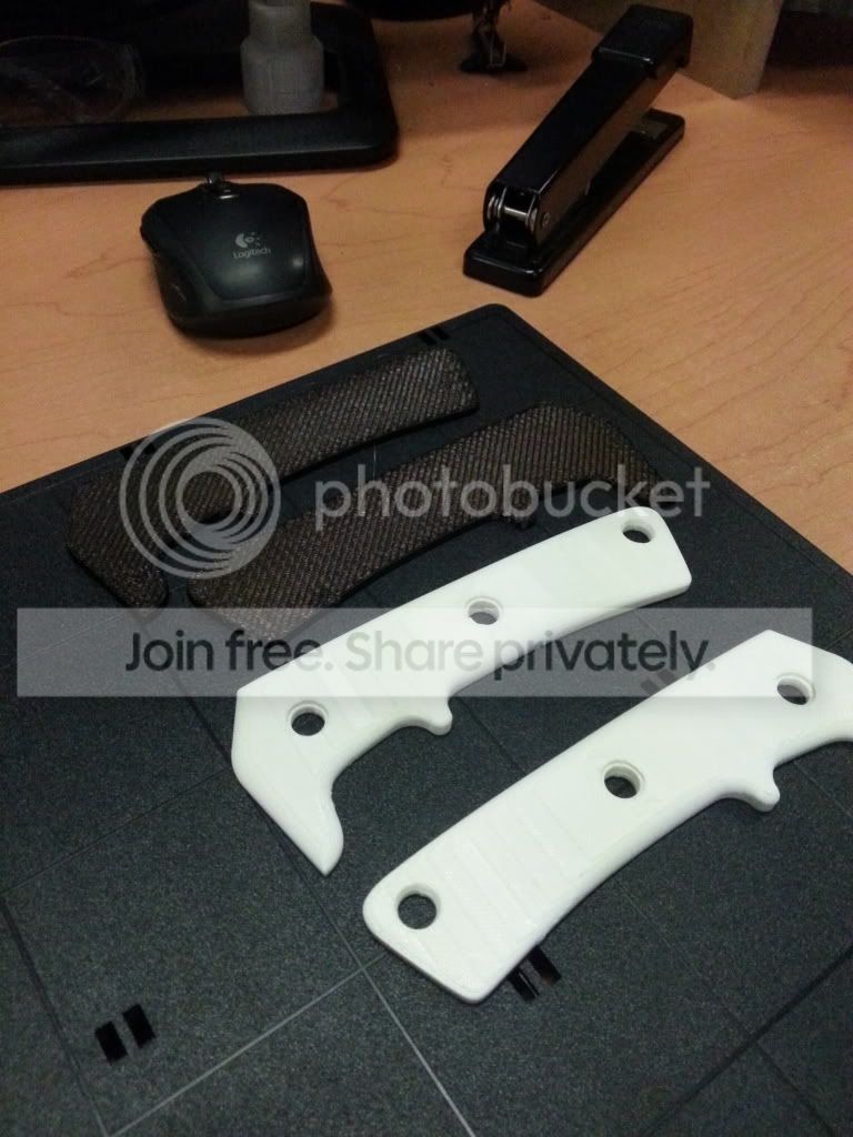

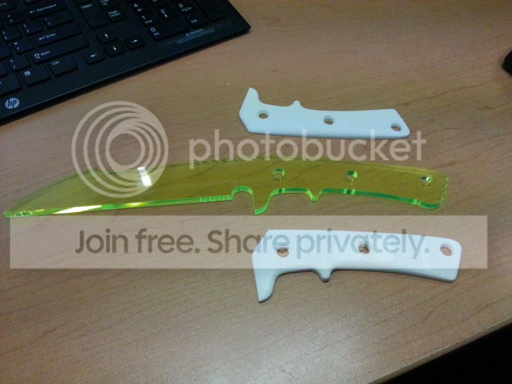

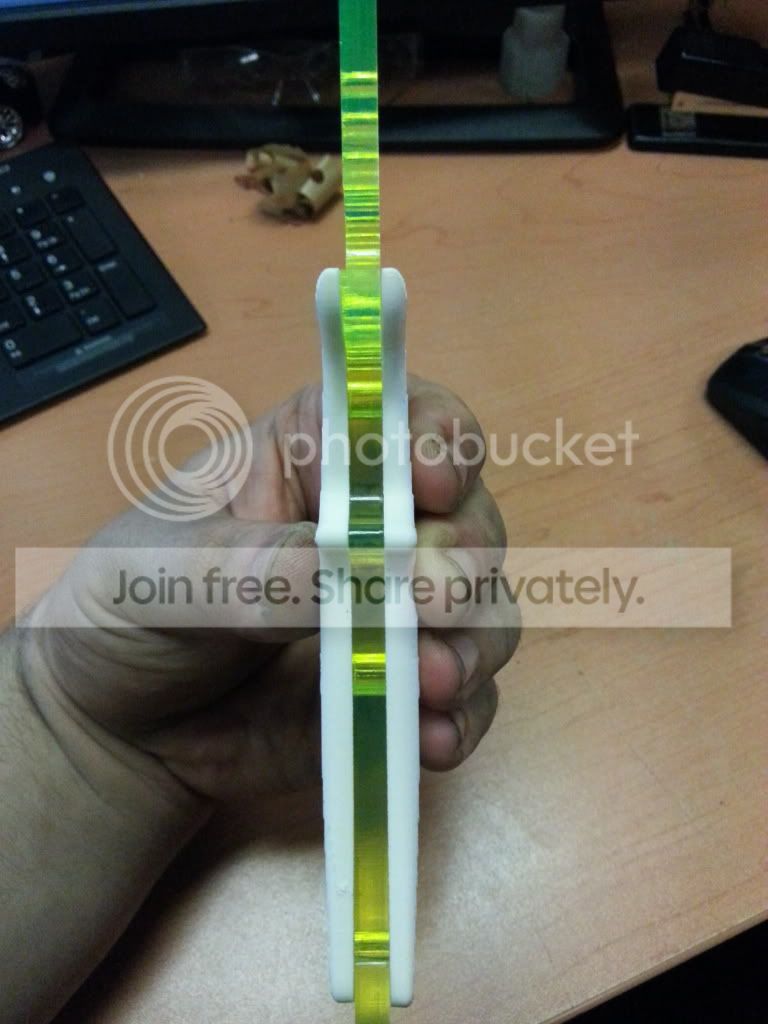

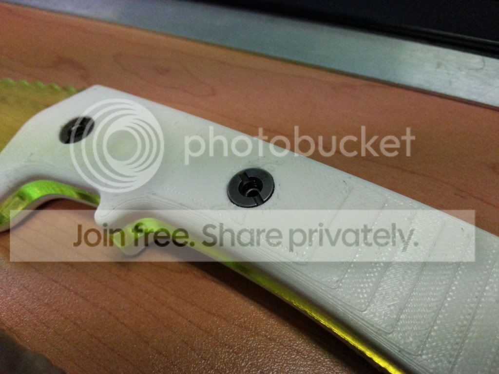

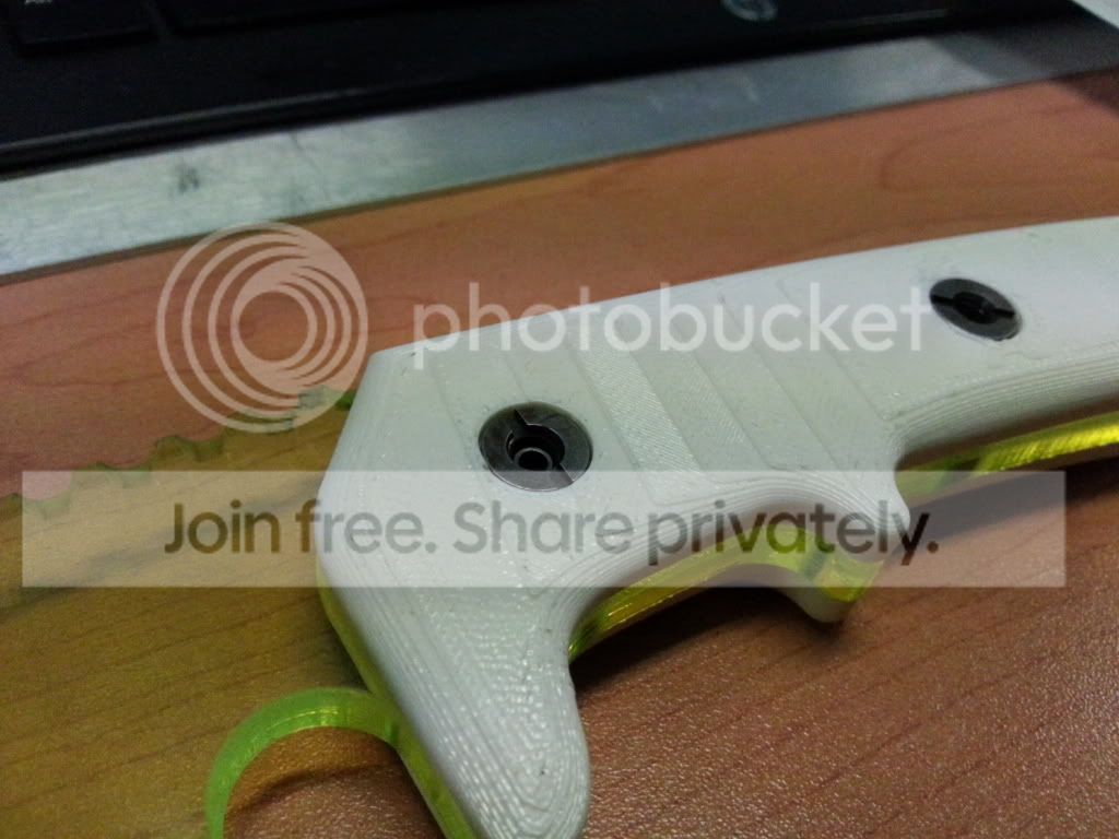

Next step was to get a feel for the design and the handles so that I can assess the ergonomics of the prototype and look for weak points in the design. I laser cut some scrap green acrylic and used a 3D printer machine to "print" 3D scales out of ABS plastic. They are not strong enough for "real" use but make prototyping an easy and accurate process. The 3D printed handles can be checked for fit with the hardware I choose and evaluated before any changes to the CAD drawings are made and sent to the CNC for machining from G10.

For those of you that are unfamiliar with the 3D printing process here is a quick video of the build. Basically tiny strips of melted plastic are laid down to form a 3D object very quickly and cheaply.

I model my CAD in Rhino5 or SolidWorks export my geometry as an STL file and clean it up with Magics. We have five machines from Dimension (the 1200es Series 3D Printer) and two Titan machines running Stratasys and one ProJet machine (I absolutely hate this one)

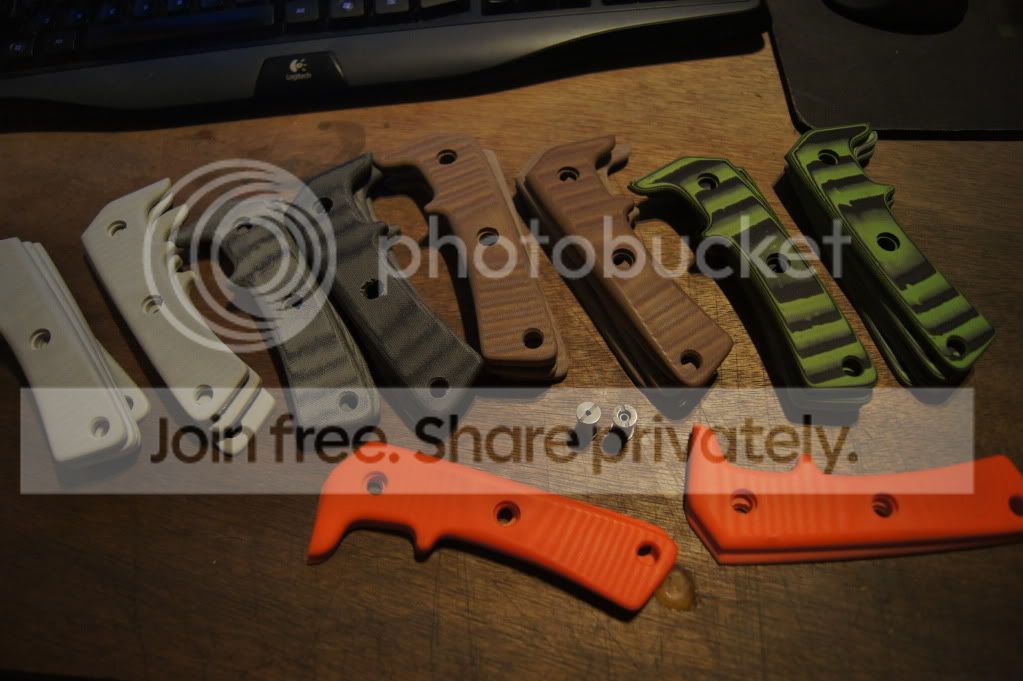

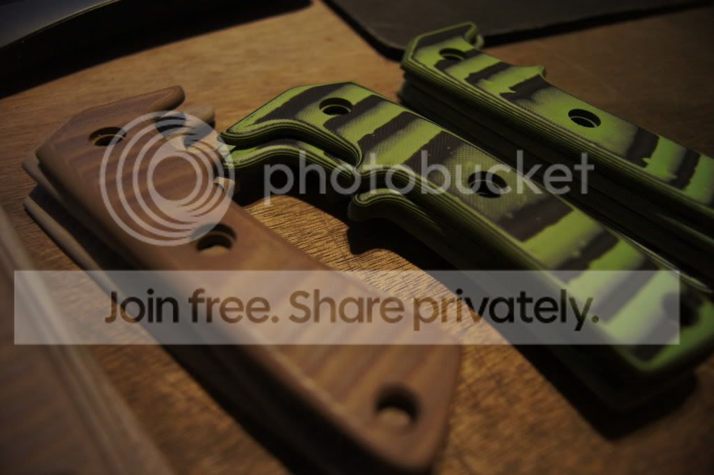

Well after testing the mockup handles extensively I took the plunge and sent the files to the CNC with plenty of .25" G10. The stepover was insanely low like .005 so I could test just how nice a surface quality was possible with carbide tooling. It took some extra time and burned up my tooling faster but ultimately was worth it... no sand finish! I have G10 options in Hunter Orange, Grey, Toxic green/Black, and a beautiful Earth/Coyote/Tan. I also experimented with a black micarta, i will look great once I put a little hand sanding time in. The steel is next...
