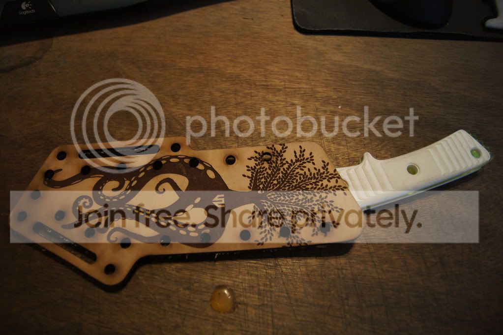

OK fellas I have just finished making 20 laser cut and etched leather blanks for the sheaths. Pics are coming once I get my camera out to the shop.

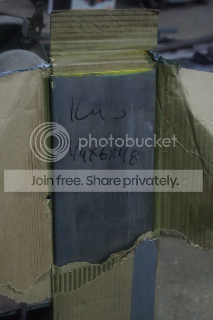

I have also decided on offering the Leviathan in TWO blade steels!
.21" 3V and .25" 1095
I have seen so much wicked stuff done with differential heat treats and hamons on 1095 that I just have to try my hand at it and see what happens!

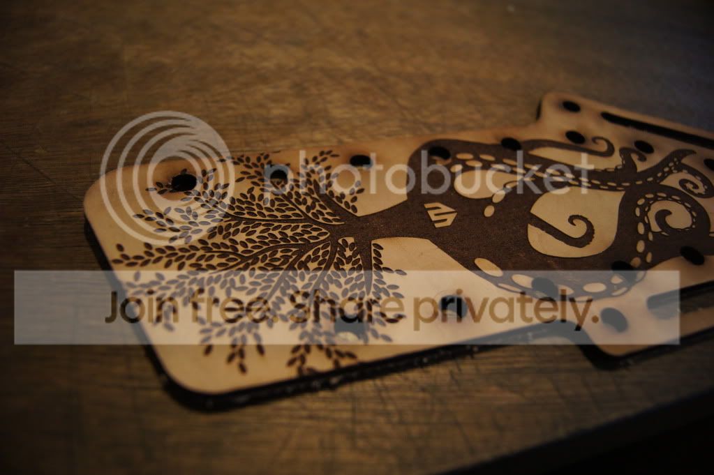

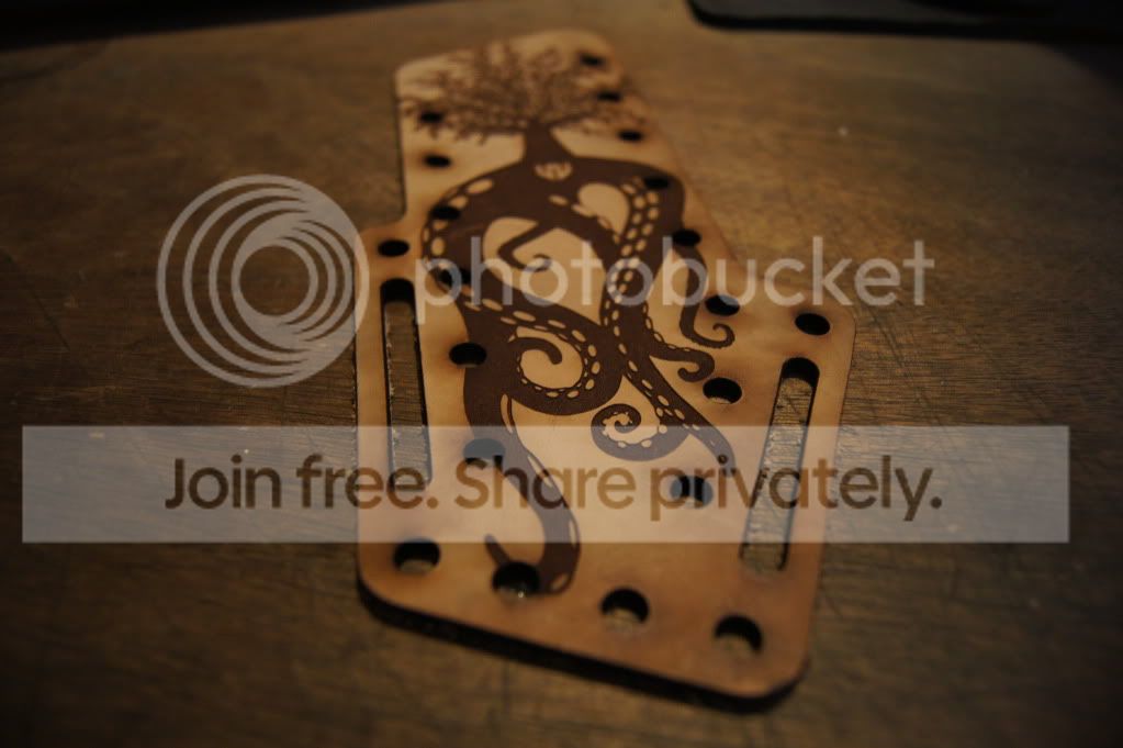

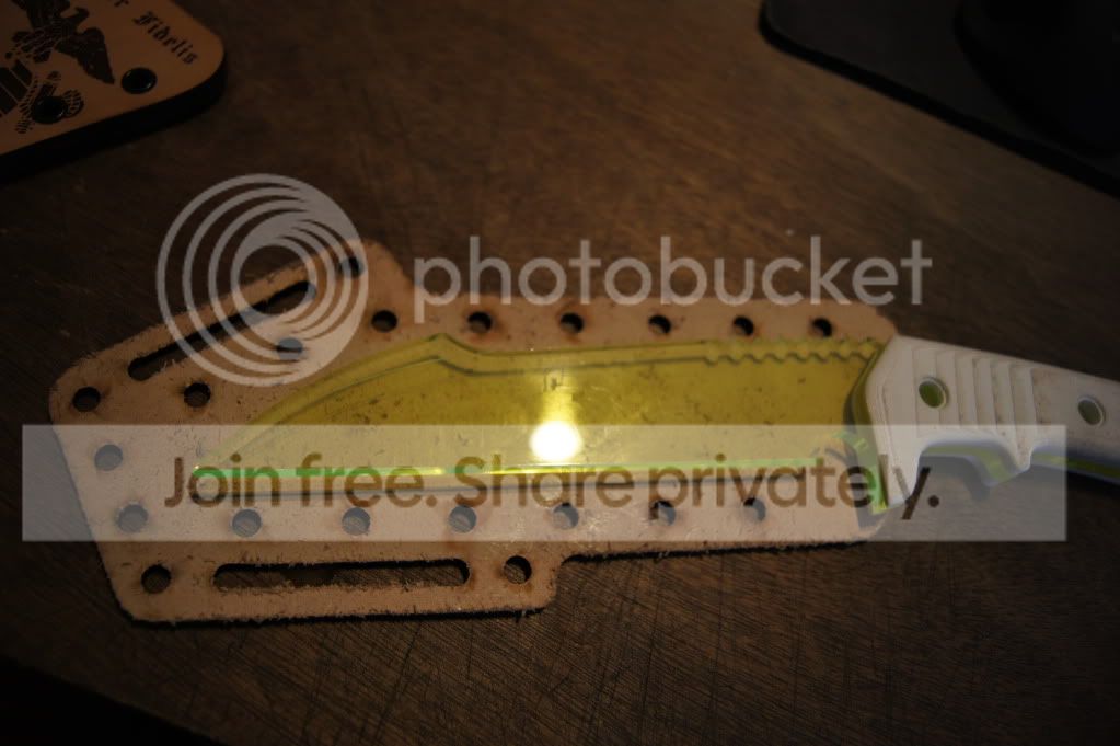

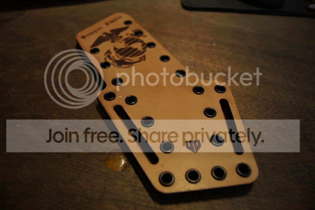

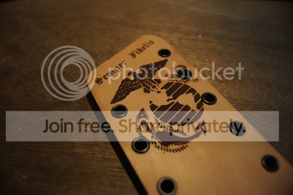

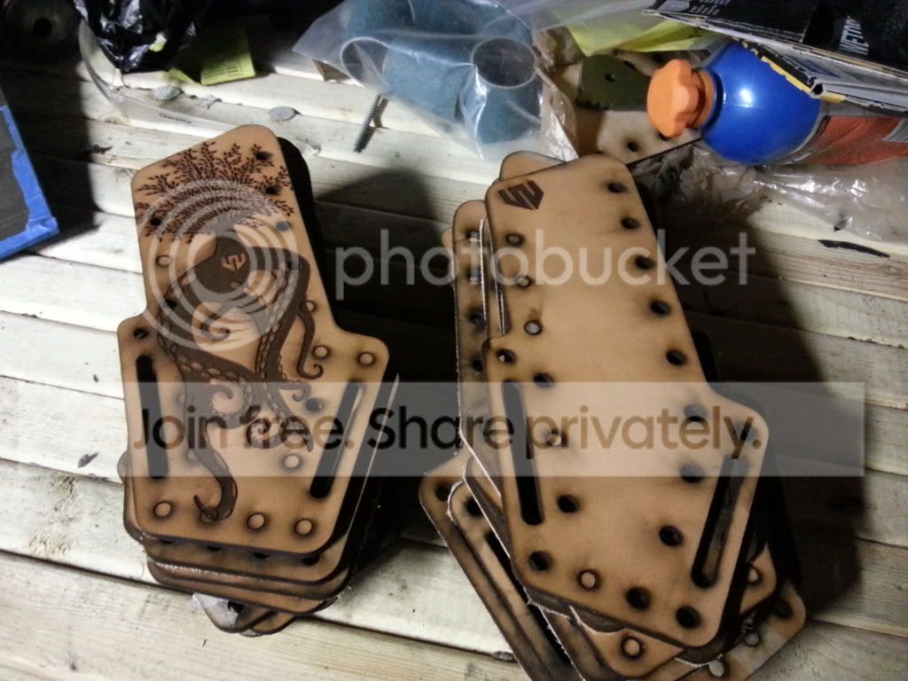

Got a double shoulder of vegetable tan 9oz cow hide. Trimmed it up and cut out the blanks. Here are a few pictures of the etchings available and one custom USMC version for a special customer. Don't worry about the burn marks on the leather a few seconds of acetone cleans them up nicely. These are ready to be dyed, assembled, and wet formed to finished knives.

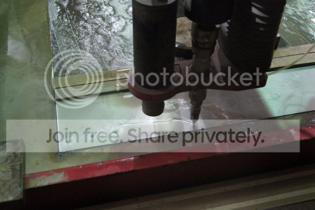

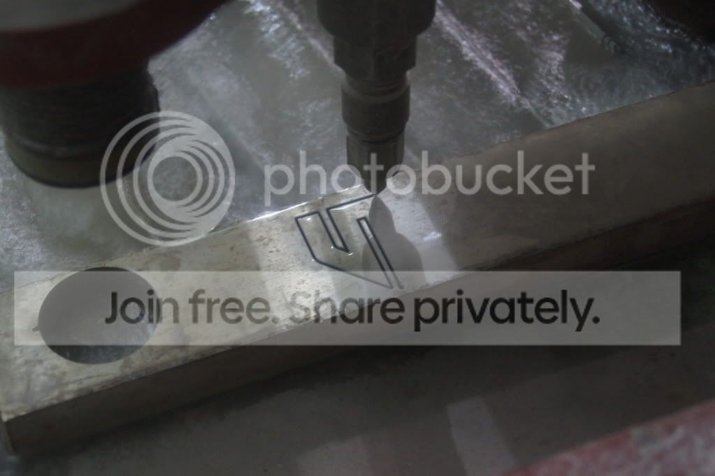

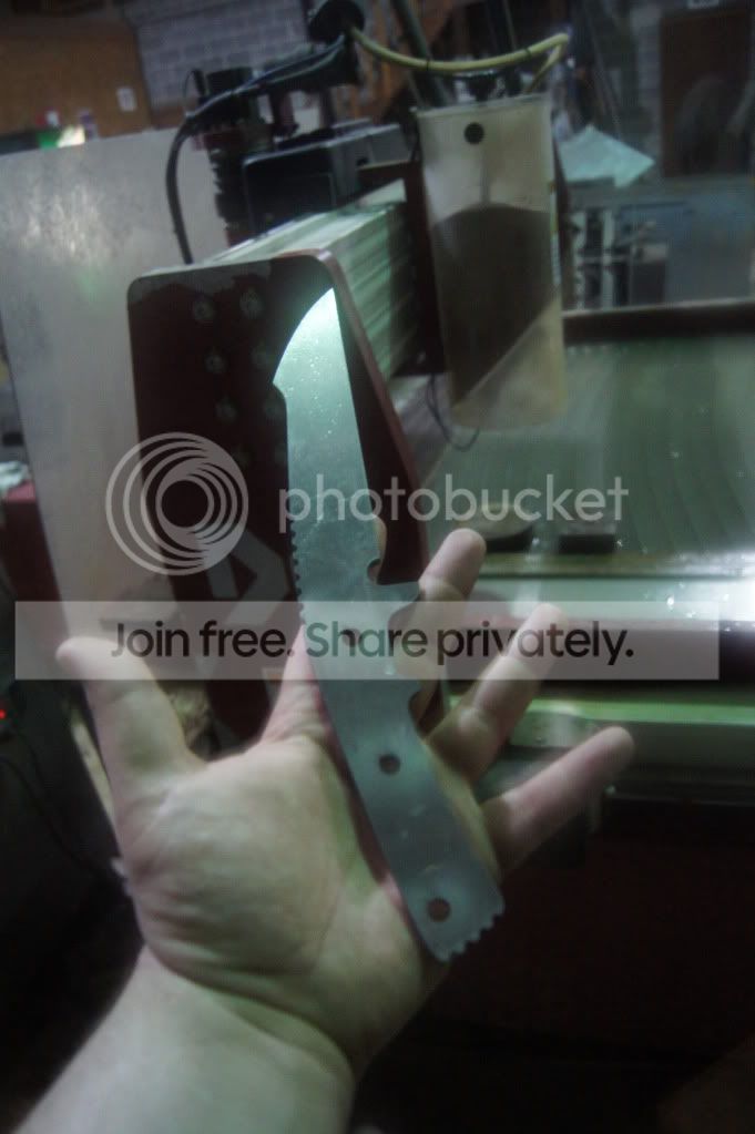

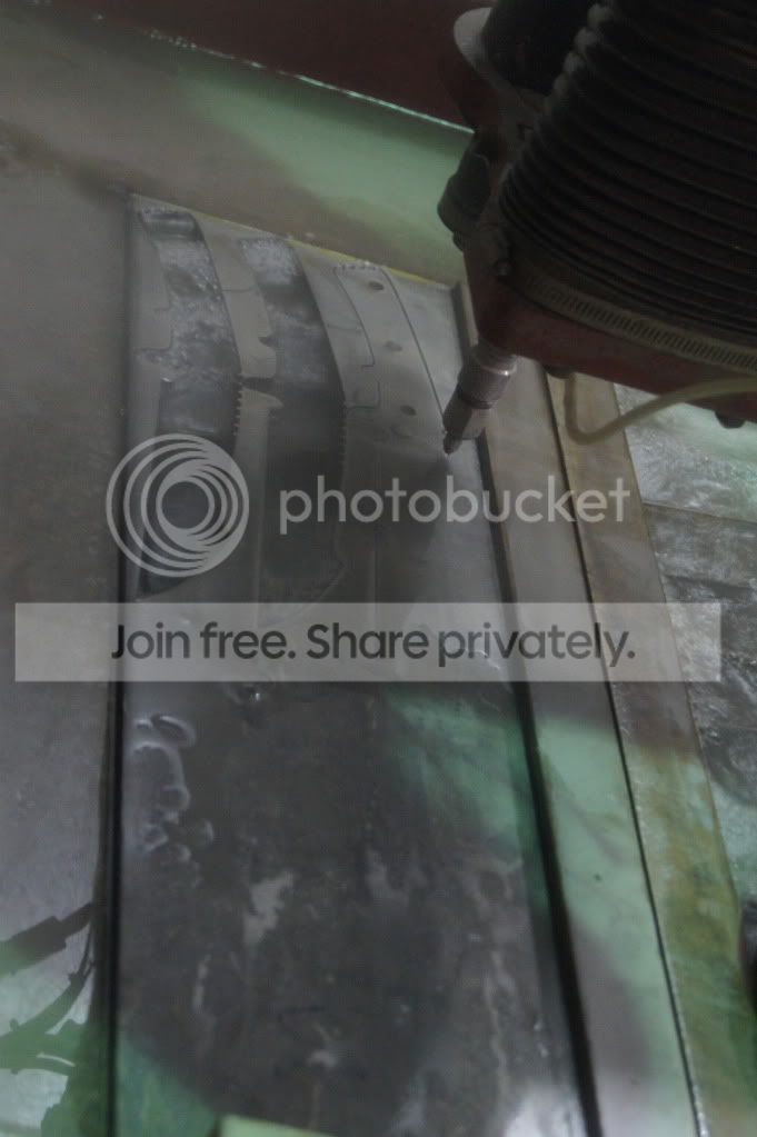

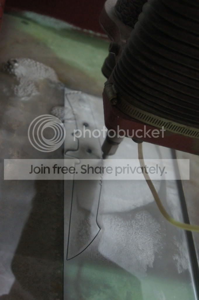

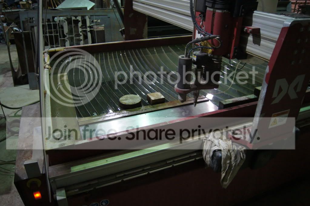

I want to be closer to a delivery date before accepting orders. Just got back from waterjet! I'll post pictures and video of these beautiful blanks ASAP.

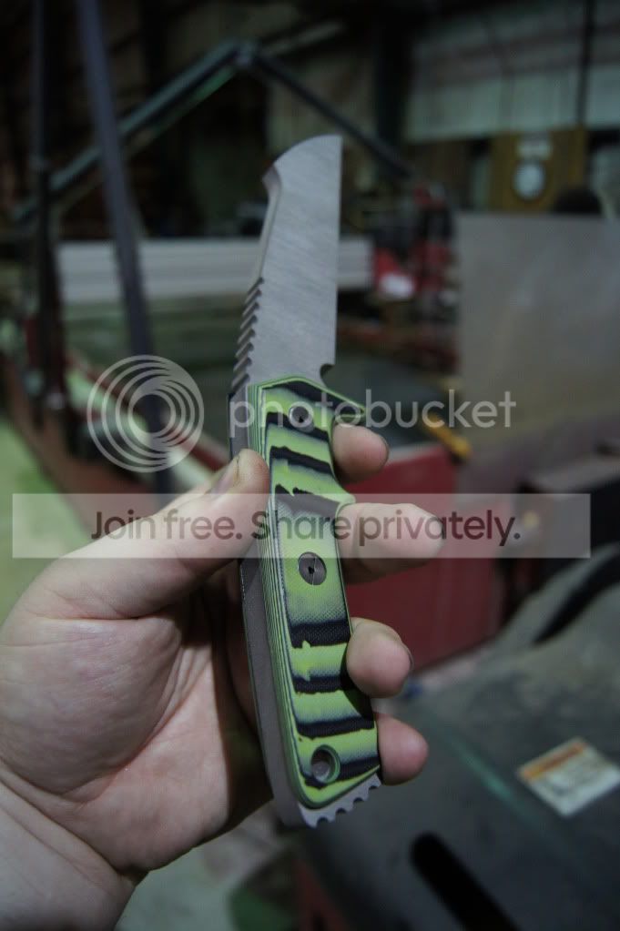

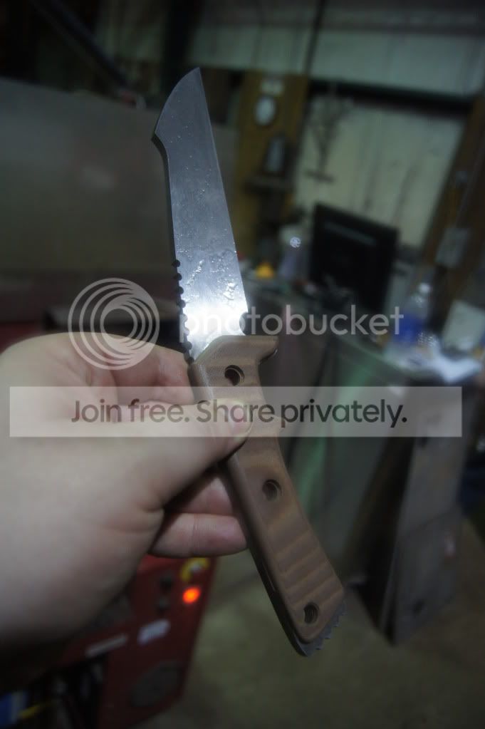

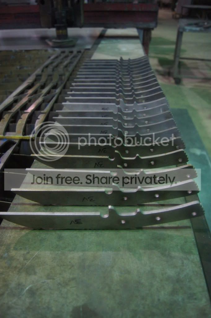

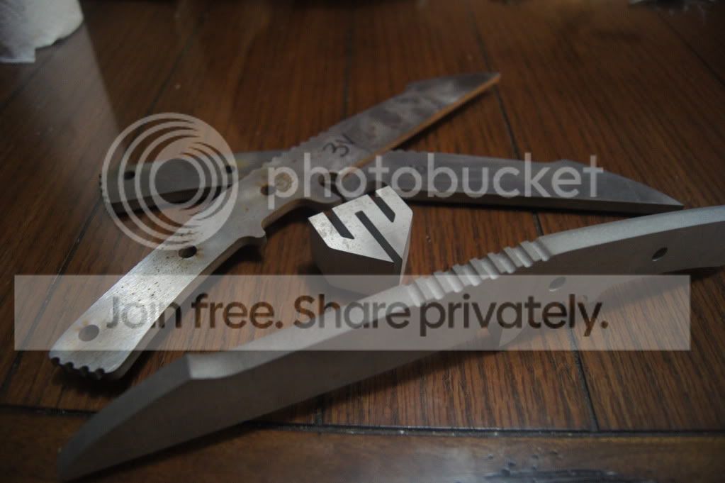

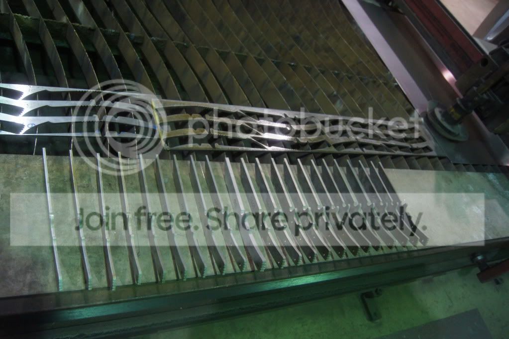

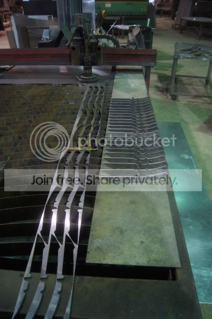

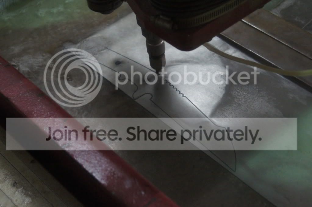

Blanks have been cut! 9 of CPM-3V .21" and 11 of 1095 1/4" and one very special .375" super chopper in D2.
The first run will be the wharncliffe harpoon design with drop point and spear point version coming.

I am jealous. All I have is a harbor freight bandsaw and a grinder. That water jet is pretty cool.
Seeing machines like this makes me feel so outdated and used up.. Very nice looking product you should have no trouble selling them,

Honestly I love water jetting my blanks because it saves me money and time. More importantly it adds a level of precision to the whole process that makes my work more professional and repeatable. Sure I could bandsaw all these out, drill the gimping, and ream all the handle locating holes but it would take WAY too much time and its worth me paying a buddy $15-20 per blank (I get a bigger discount if I bring bourbon :) ).
