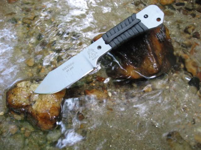

This knife was sharpened on the Spyderco Sharpmaker, packaged up and shipped out yesterday along with an email to Joe and the next participant that contained the shipping info.
I did decide to attempt a cord wrap just before shipping it out so feel free to take that off if it is not of interest. I made the one end easy to remove if desired.
The knife made one more feather stick before the sharpening, and I was able to get the striker on the but to work with the fire steel, thus further proving how effective it is since I was able to make it work (once I watched the video).
Overall, for a skeleton type knife, it works very well! If the knife was mine, I would have thinned the edge down the first time I sharpened it. Again, for Joe's intended use, this knife is outstanding, light, and worth your consideration.

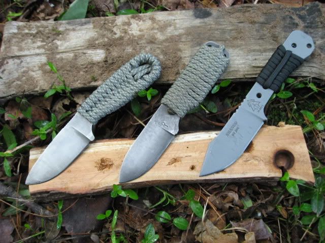

I was able to get out with the Shango this weekend and try it out, along with a few of my other neck knives. I'm a big fan of neck knives, not because I wear them around the neck (I almost never do), but because they are light and relatively compact, which means I am more likely to take them along, even on a short dayhike. I almost always have one in my pocket or buried in my pack somewhere when hiking. Here are a few of my favorites, an Izula and Gossman PSK, along with Joe's Shango.

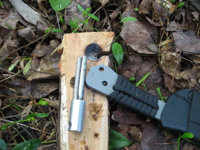

I like the blade profile on the Shango. The belly of the blade has a nice bit of sweep, and the 'hump' on the swedge makes a great place to lay your index finger, both attributes I think would make this a handy little skinner. I drilled a couple of holes in my fire board, and the clip point made that easy as well as giving some nice piercing ability.
The thumb jimping is well designed and worked down enough that it doesn't make hamburger out of your thumb during hard or extended use and the handle is long enough for my medium size hands to grasp with room to spare. Hand fatigue will probably be an issue during extended use, but that just goes with the territory when using a blade with no scales. If this one were mine, I’d wrap the handle a little more extensively, ACU paracord of course. :D
The magnesium/ferro setup works really well with the scraper. I was able to scrap off a good mound of magnesium in no time and was able to spark it on the first hit of the ferro. Heck of a lot easier than the way I usually use this fireboard. The shavings are pretty fine and would probably be prone to blowing around in the wind, so you’d want to use this in a sheltered location.
Didn’t know how I would like the combination of a coated blade along with stainless steel. Most my knives are high carbon, and as you can see from the pic of the Izula above, I can live without blade coatings. I think I like the concept though. I don’t worry too much about rust on the Gossman or Izula, if I see any I just clean it off. I don’t get around to changing the paracord wrap out very often though, so I always have that little worry about how bad it is getting under the wrap. With the Shango’s coating and stainless steel, I don’t think it is an issue. This could be a blade you throw in your backpack, day pack, or BoB, and not worry about for a year or 5.
The kydex sheath is nice and keeps things low profile. I like the thumb ramp at the top of the sheath that assists in the draw, well done. Blade retention is good, however on this one at least the fit is fairly loose, so the blade rattles around a bit in the sheath. Nothing a good blow dryer probably wouldn’t fix.
So all in all a very solid little performer. I had already convinced myself that I didn’t need another neck knife, but after using the Shango a bit I really think it has a place given it’s well thought out blade design and coated stainless steel. Thanks for the chance to take a look at your design Joe, well done! So off to the strop and the next reviewer.
