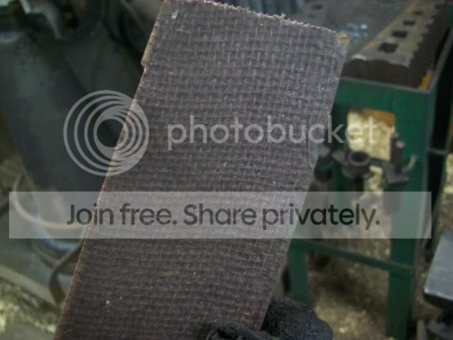

That's pretty good-looking! (reminds me of a giant peanut!)
Did you make it in vacuum, or with just a press?
edit: looks like you added a few more pics as I was writing. So you used a pan & press shaped the sheets?
i just noticed you edited your question. I am not sure i answered it.
specifics (for those that are interested)....
1) get some burlap from fabric store. the stuff i get is only $3.99/yd.
2) get some fiberglass resin from a hardware store (or wherever).
3) cut burlap into workable pieces. generally, i will do 2.5x11" or so.
** remember, that you will most likely need to cut the edges back after it sets. so, plan on cutting larger strips than what you want for your final dimensions.
4) lay a piece of wax paper down. mix your resin according to directions. lay down the first fabric strip. saturate with resin. lay down the next. repeat to desired thickness.
** do this in a well ventilated area.
** don't use just latex gloves. i busted my fingers out the first couple times i did this. use nitrile gloves.
** temperature plays a role in set time. plan accordingly.
** i use a lot of resin. i underdid it one time and i would rather use more than have too little. with that said, i have always used all of it. i use a full 16 oz of resin to yield about a 3/8-1/2" slab.
** the resin i use asks for 14 drops of hardener per oz of resin. with 16 oz of resin, well...that's a lot of drops. i convert drops to mL and find that a little cup that comes with cough medicine (e.g.) works well to measure it out. find one with the mL markings on it.
5) fold the wax paper around the mess you've just made
6) get some boards (or whatever that is flat and rigid) and press. i place the wax paper wrapped raw micarta between two boards. i then clamp with several c-clamps and various other clamps. i let sit overnight.
** leave some wax paper down on whatever workstation you are using. when pressed, the resin will ooze out all over.
7) cut into scales. i use a band saw.
one thing that i don't like about the scales after they are made is the smell. please know that does go away with a bit of time.

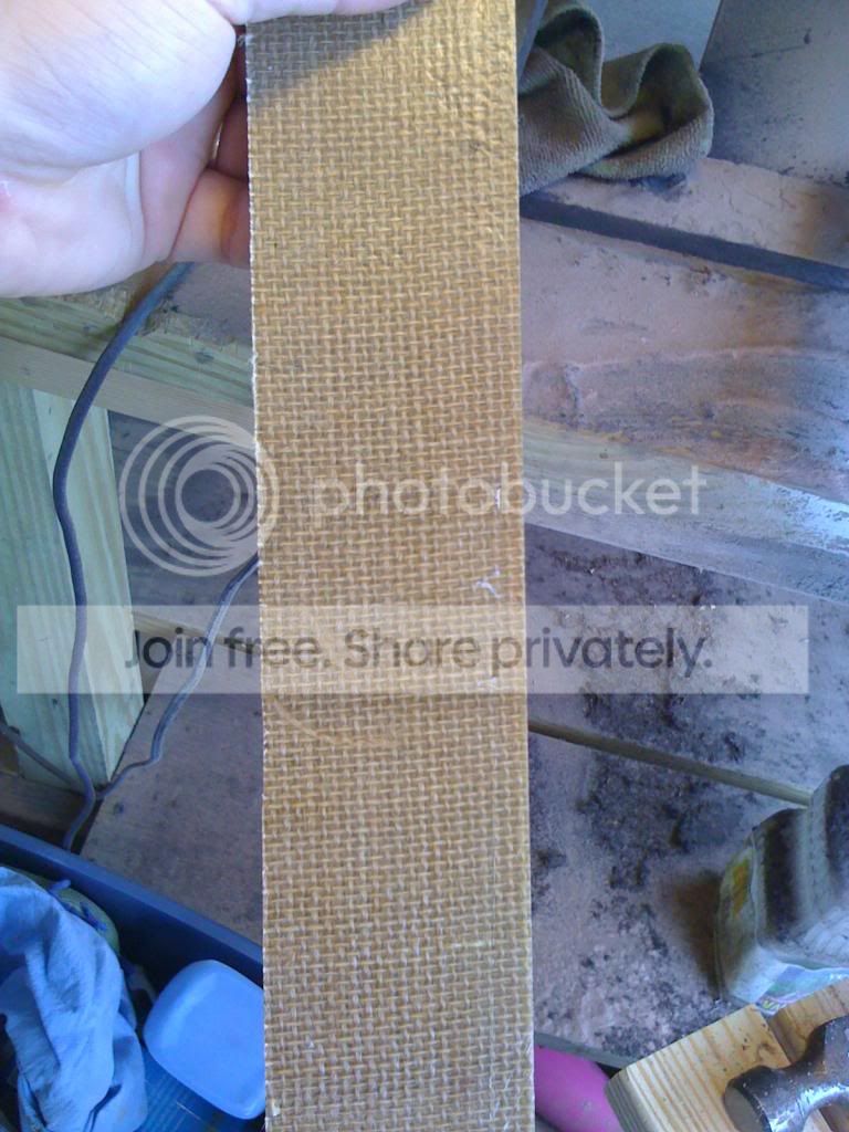

Well made a few trial pieces and learned a lot so far. Here is what I got that might help others wanting to play around.
Straight out of the press and cut to size. No cleaning up or anything
1) I made sure to cut my strips a good bit wider then I needed cause you lose a decent bit.
2) Used burlap straight from fabric store and cut along thread lines so the pattern looked "square"
3) You will need between 1/2 to 1 can of resin (I used 3m) for a piece 14 x 2.5 depending on thickness.
4) 6-8 layers got me right above 1/8" thick 12 layers was around 3/8"
5) make sure the wood or whatever you are using to clamp with is smooth and flat. Had a small piece of dirt about 1/5 the size of a dime on one and made a dent but luckily at the end of the piece.
6) for my piece I used 2x6 and 6 c clamps (uneven pressure from side to side can occur.
Now Ill prob play around just a little bit more but hopefully that saves someone some time and $
Id estimate cost for cloth and resin for a set of scales around 6" x 2" is about 15$. I'm sure if you did in bulk you could do cheaper but it is a fun easy project and looks nice IMO.
