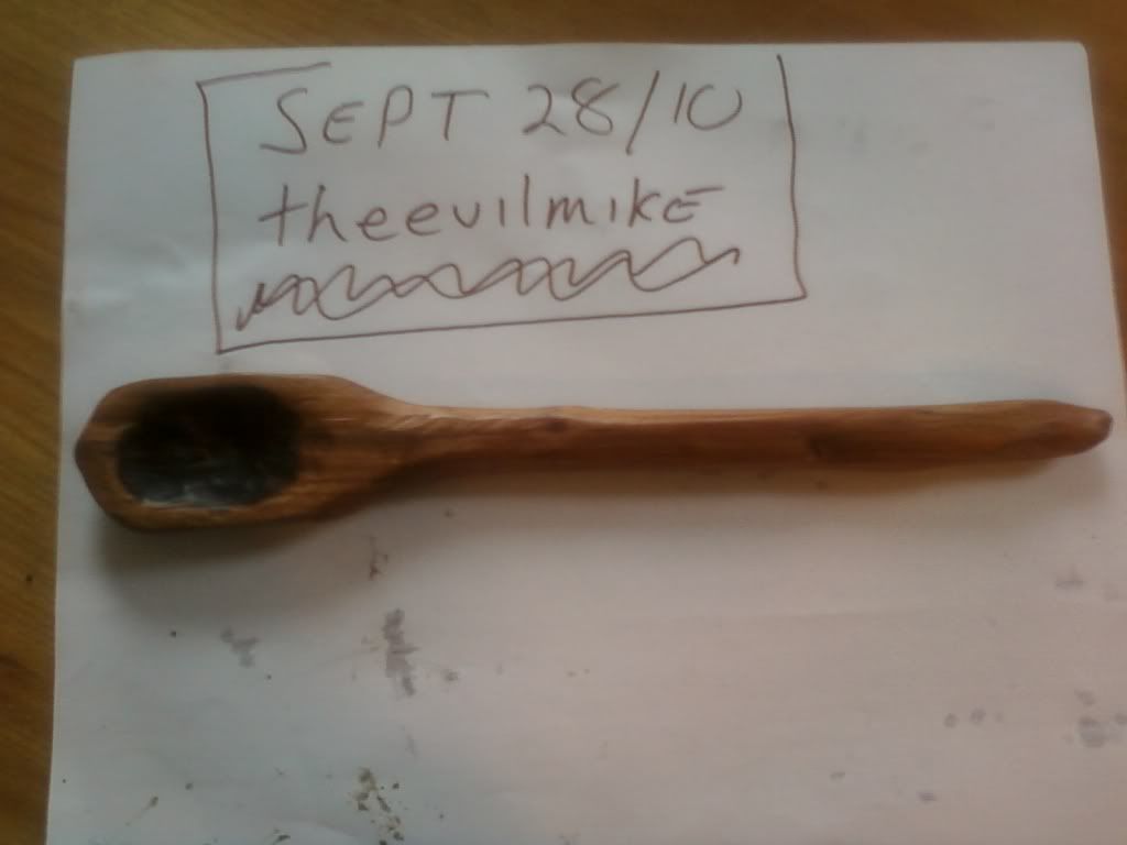

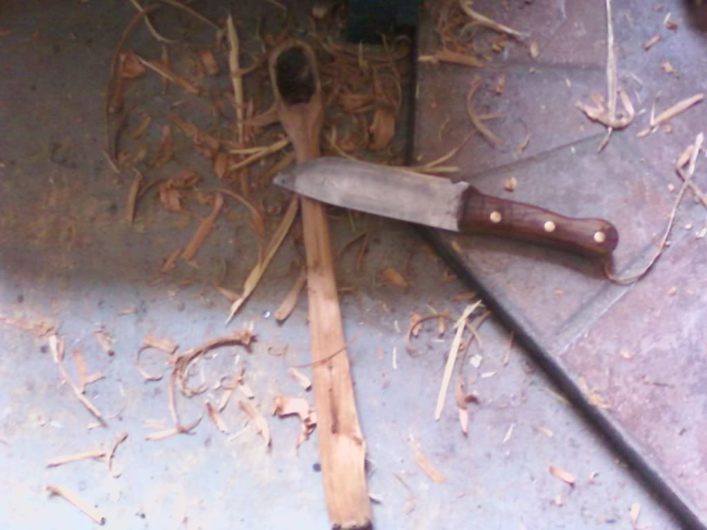

well, my spoon isnt very good, but i gave it a try today
i used my home made knife "my very first try at a knife"
and some coals from the fire to help with the bowl, a bit of sand paper and min oil
i will definetly give this another try some day soon, as it was alot of fun
the starting peice
during
finished

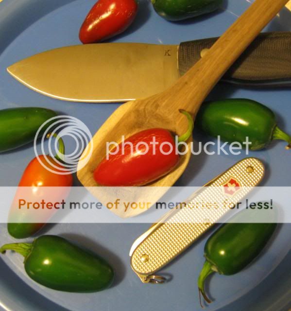

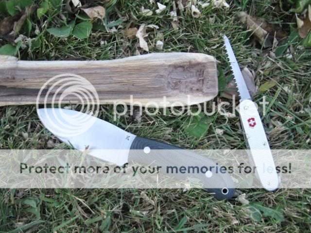

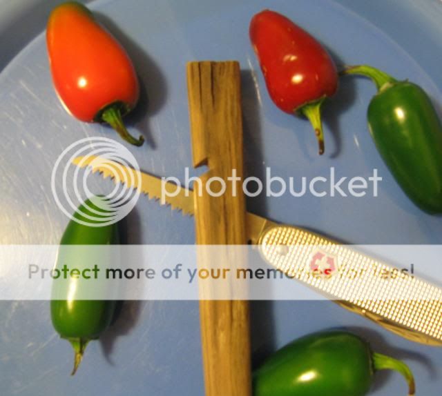

Here is my second spoon. Last one was a year ago and on green wood. I used some dried Walnut out of my yard, definitely made a difference verses the green wood. I used a Vic Farmer and JK Ky Woodsman for all the carving. Wanted to try a coal for the bowl but there is a burn ban on here now. I tried to think of a way to make it serve more than one purpose so I added a notch to use as a lid or pot lifter. It needs a coat of oil, but I don't have any yet.

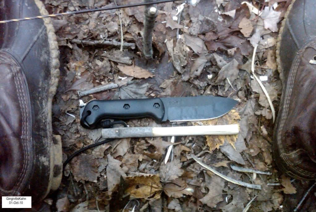

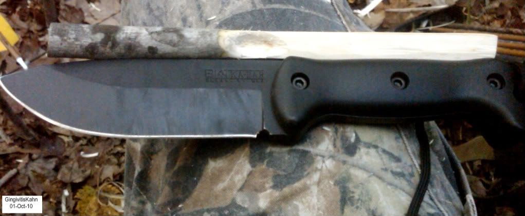

I love that tiny spoon. Love it so much I decided to make an itty bitty one with my BK-2. To be fair, I was actually using the BK-2 to make an impromptu bow rack for my Howard Hill longbow this morning out in the deer woods and an extra scrap of limb kept calling to me.
Here's what I got...
Here are the raw materials. Mostly I wanted forked stakes for a bow rack.
Here's the bow rack in action.

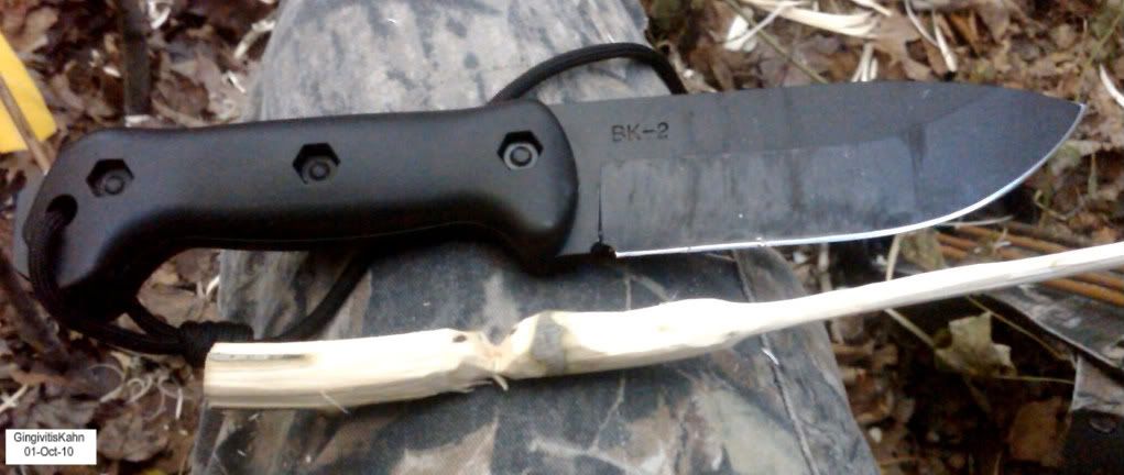

There's a tiny spoon hiding in that stick - I can hear it calling to me.
I was smarter this time. Left a temporary handle on it so I could work the bowl a bit more easily.
There's the spoon roughed out - now to remove the temporary handle.

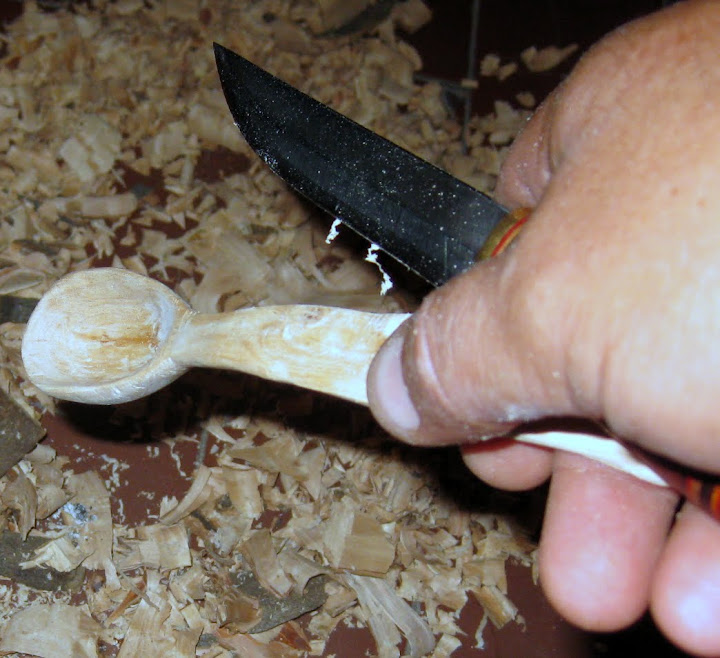

For the people that use just a knife (not a crook knife or other tool), how do you hollow out your bowl?
I normally drill, then pry or carve out pieces with the tip, but the bowls often don't turn out quite as nicely as some of the ones I've seen here....

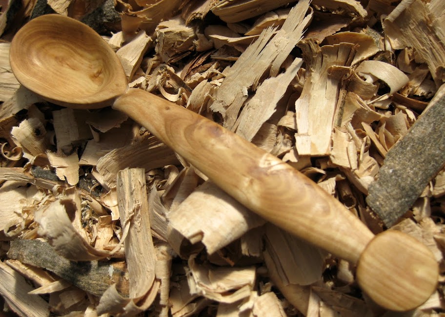

I did this spoon with the tip of a knife. What I did was I started by slicing a V with the grain and slowly moved it out to the edge following the contour of the bowl. Once I had it wide and deep enough I switched to cutting across the grain and slowly worked it to its near final shape. I just took little slices off at a time so I could round things as I went and then sanded smooth. I was lent a crook knife after that and I went back and dug a little deeper to get a consistent thickness in the bottom of the bowl.

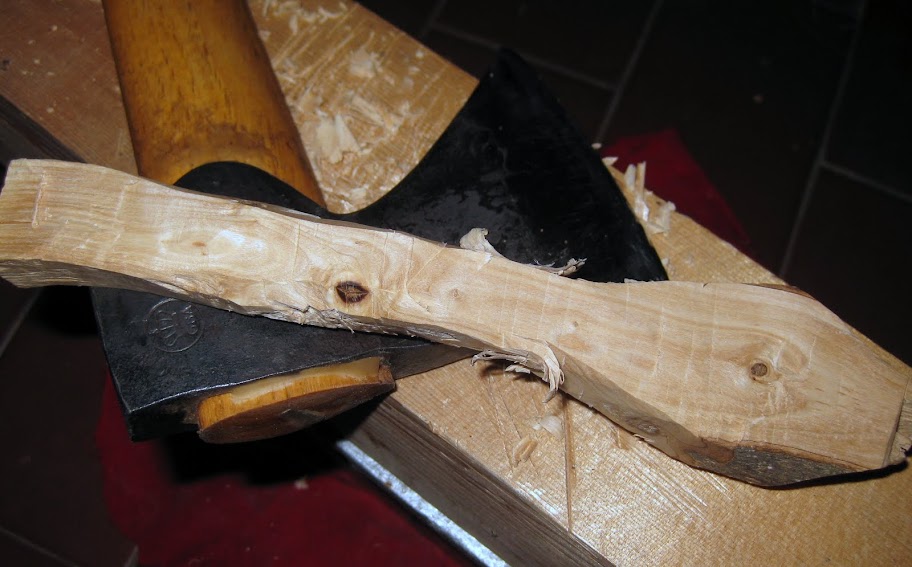

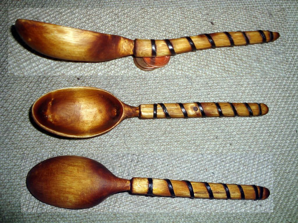

Well I finished my first spoon last night, its not bad but I can do better. I went with box elder because I have never carved anything before and I wanted something easy to carve. I didn't look at any of the how to's on spoon carving and I guess I did it backwards because the bowl of the spoon was the last bit I did. No breakage it looks like a spoon and works for now. Unfortunately I didn't think about the heart wood and that is slowly but surly disappearing. I am going to make another for the contest but this is what I did on a first attempt.
Notice the recessed leather wrap for positive non slip grip:p
This is not my entry, I just wanted to show the other newbies that it can be done.
My entry will be done with nicer wood, I am going to Tea stain it and finish with tung oil/beeswax so it will be food safe but have some depth and color. Look for that one next week.
I should mention that I was using a small knife that I made that has a lot of belly at the tip so that made it easy to only cut where I wanted to.
