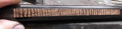

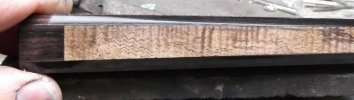

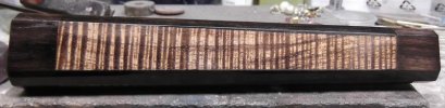

I cleaned up the handle a bit more. It is just about ready for assembly now.
Four side views.
This is only a 400 grit sanding without any real attention to getting it perfect. Even though the curly koa looks good now, it will look like 3D when sanded to 8000 grit.
BTW, I have been using the term "ebony" when referring to the dark wood. On the other handle in the beginning shots, I was using ebony. On this handle ,I used African Blackwood, as it matched the grain and tone of the koa better.

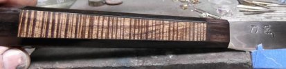

Front ,back, and on the blade.
A little hand sanding and then I will fill the handle hole with black dyed epoxy. I will slip the bolster on the tang, and apply some epoxy on it. Then I will slide the handle on and mate the pins to their holes. After wiping off the squeeze-out , I will clamp it and let dry. After about an hour, I'll re-wipe the squeeze-out, and check that all is aligned properly. If all is well, I'll let it cure for 24 hours. Then it will be some touch up sanding on the grinder at 400 grit........ and the final hand sanding to 8000 grit.

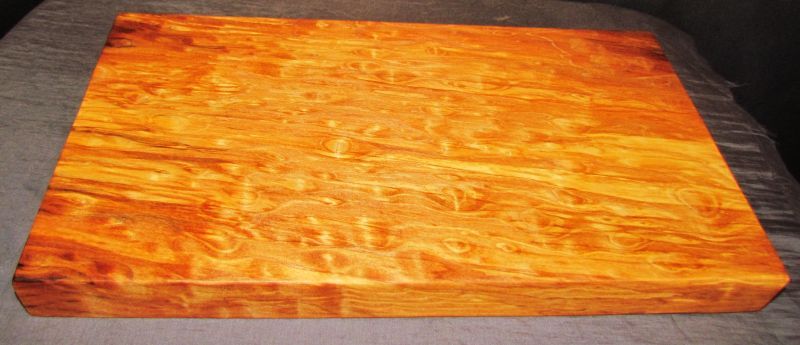

I made a new cutting board to use with this knife.
I plan on using the knife a lot, so it will get the care it deserves.
