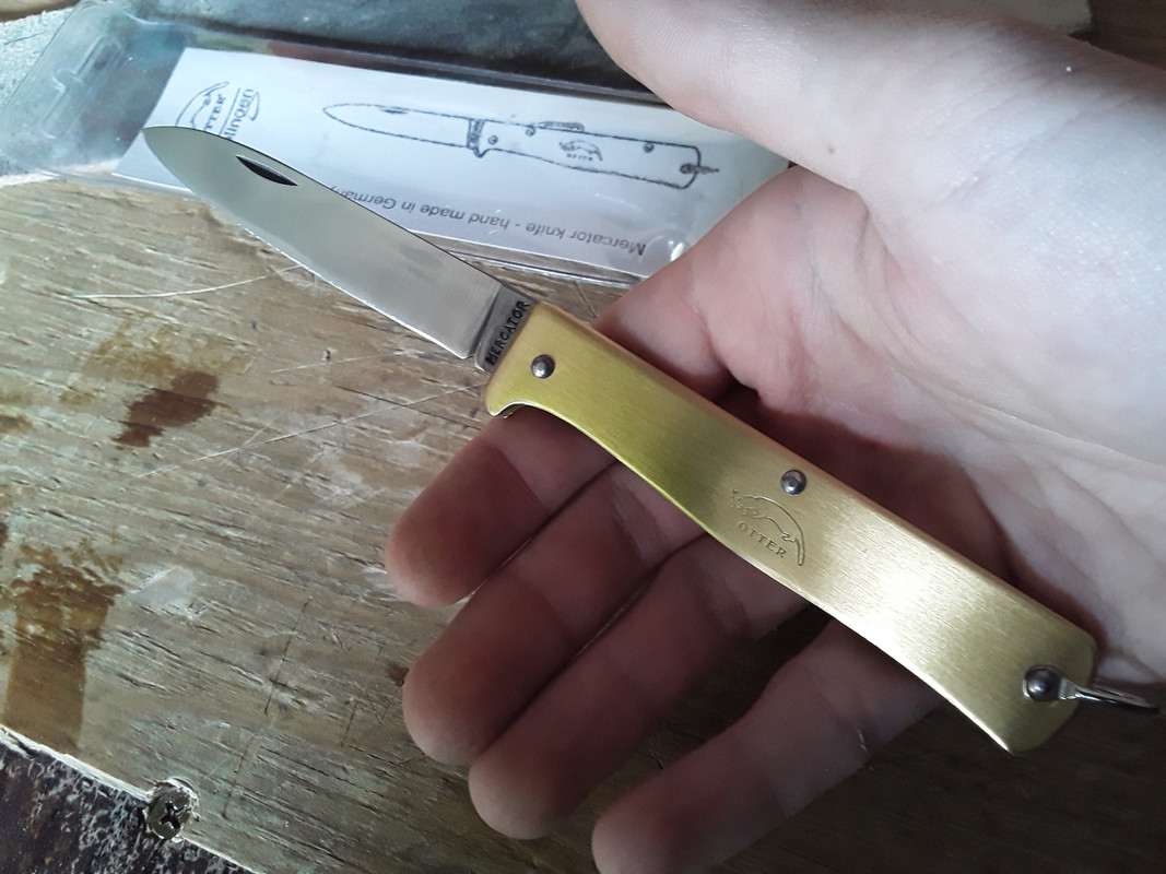

I just got this small brass Mercator in and it's definitely an interesting knife for sure.
Its not perfect but it has rustic working knife kind of charm that's quite pleasing.
It's very thin and fairy lightweight, but it fits the hand well.

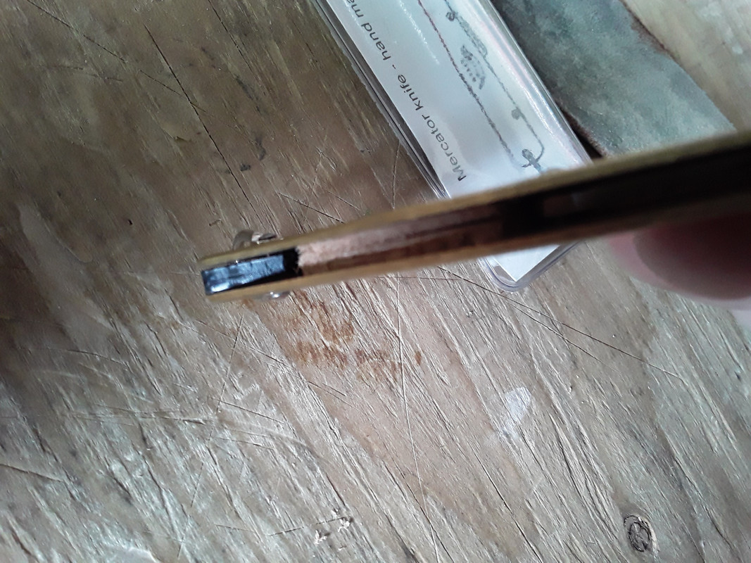

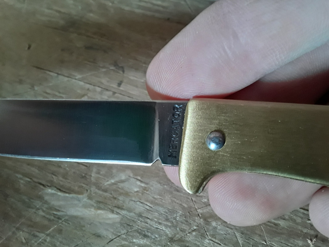

Now I dont know what they were thinking, but these have absolutely zero kick.

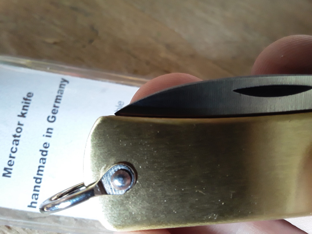

And the tip contacts the spacer, so a bit of 10oz leather was necessary.
Now its just right , the tip is close to being proud but just barely not. That's how it has to be for the edge to wear into the leather over time without the tip contacting the spacer.
