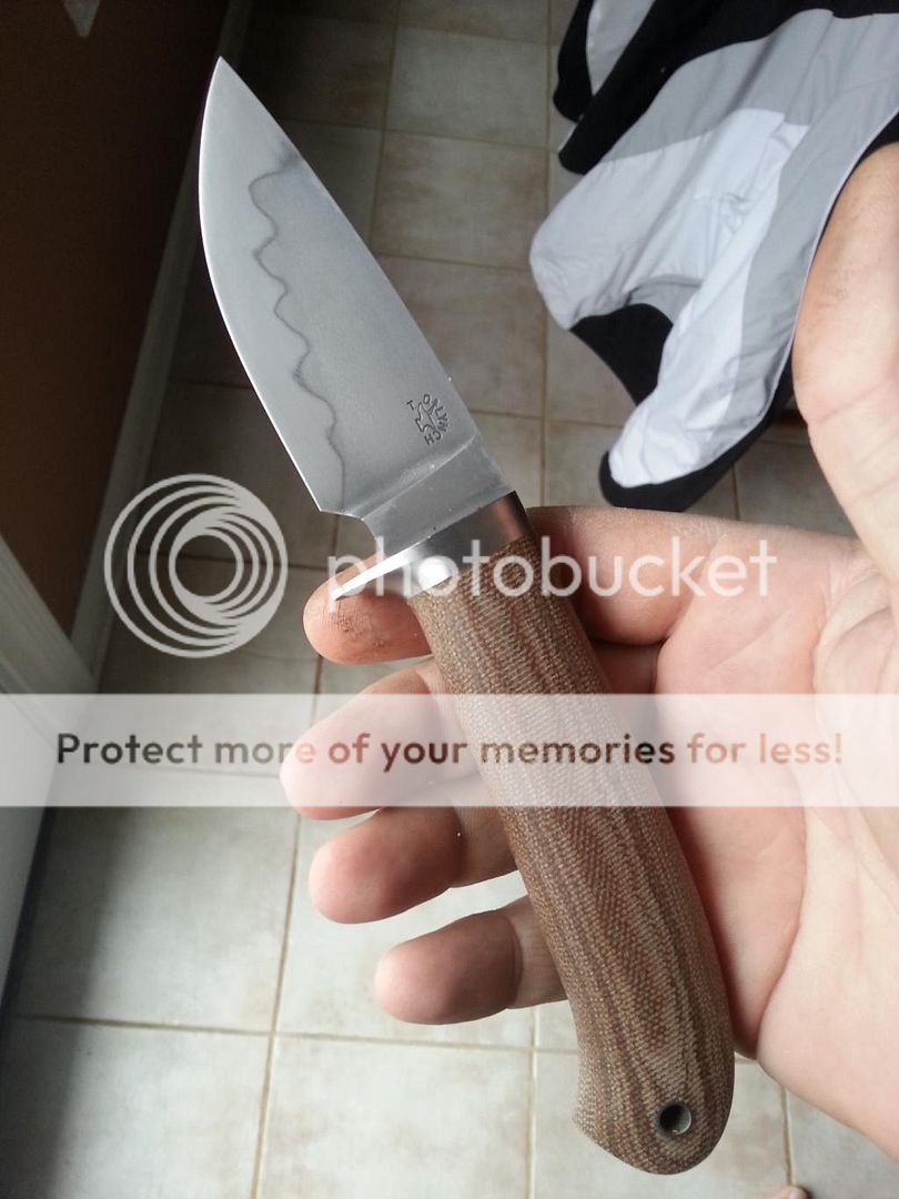

Here's a little knife I made to keep and personally use. I'll admit I've cleaned more than my fair share of deer since I was a kid. I like a 3.5" blade fine, thinner rather than thicker. Actually I like a pointier blade more like a puukko for purely game processing.
This one's more of a skinner/all purpose....1084 and micarta.

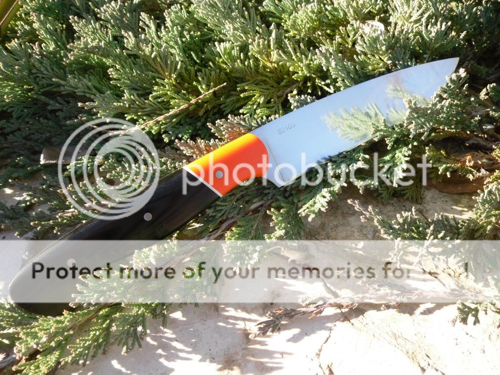

This is an example of how I make most hunters. As a matter of fact, my own is exactly the same, but with solid blade orange G10 scales, so I can more easily spot it once I've set it on the ground and then lose track of it!

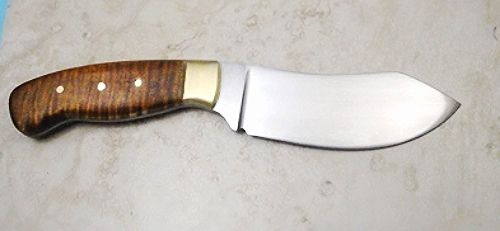

80CrV2, brass, and curly maple. Not everyone likes brass, but I like it fine. This was made for a good friend, and it is what he wanted. The blade/handle design is my favorite (sort of a Nessmuk, but a bit more curve).
works good for me. Excels at skinning (just under 1/8" at ricasso, with serious distal taper). O1 may have been a little better, but I can not be certain that it won't see some pretty significant lateral forces at some point with my buddy using it. He is the impulsive type.
