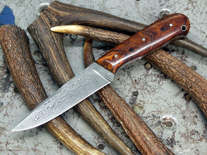

Here's a couple shots of my previous hunting knife, which I use more as a camp knife now. Cocobolo and CruForgeV. It felt too big for my tastes, at least for my style of field dressing...

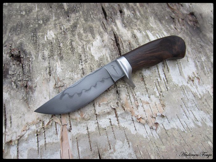

This is my personal hunting knife:

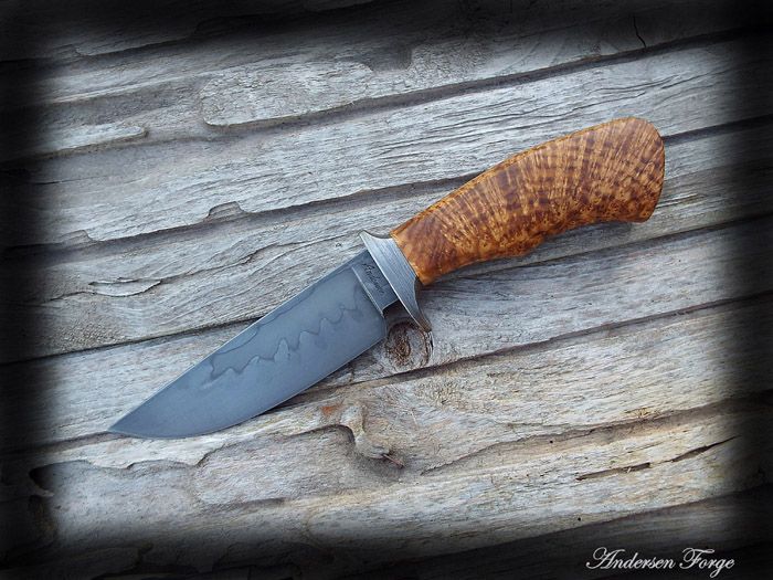

That said, I can not make these fast enough:

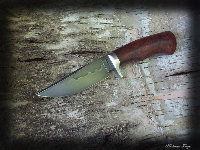

Please allow me to make a nuisance of myself - I just got this one done about 10 minutes ago.
Fella wanted a hot-blued guard and Ironwood. He said it's going to see lots of field use. :thumbup:

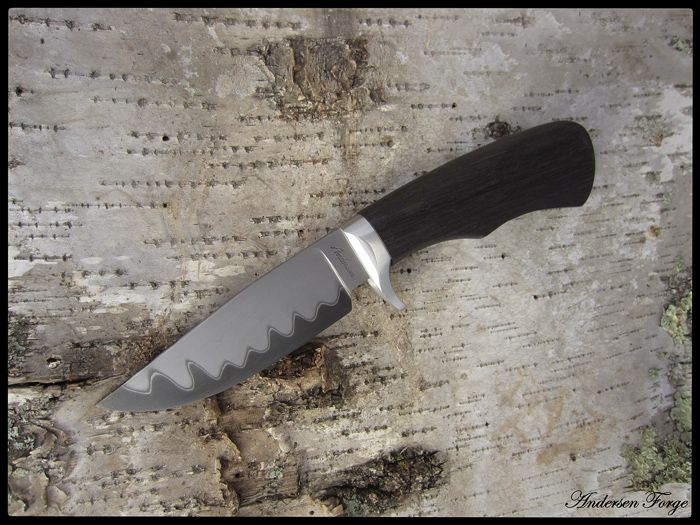

Karl, your 3rd pic in post #42 looks like an Ed Fowler blade design, I especially like that one. And I agree with you on a 4½" blade: best combination of reach and control.
Funny thats one of my favorite hunters Karl has made and I also saw the Fowler type shape.

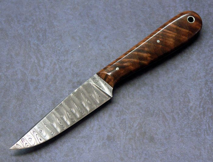

Fitch Hunter, DI 1084.
Fitch Hunter Skinner DI 1084
Matt Roberts Maple Hunter W2, blued guard w/elements of a Harvey Dean Boot knife.
I can understand the Fowler similarity.
However, that is almost a direct copy of a mid-1800s trapper's knife I saw at an antique firearm collector's show in Michigan.
Ed did not invent that blade profile.
I really like that one myself
Picture it with a black micarta handle :)
Just my style

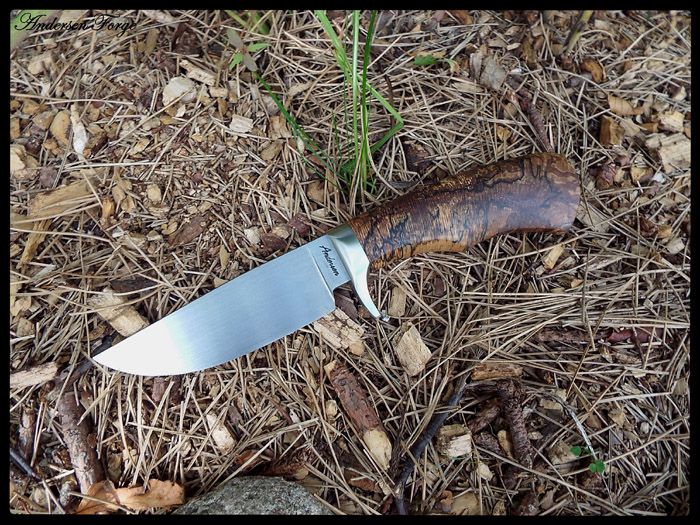

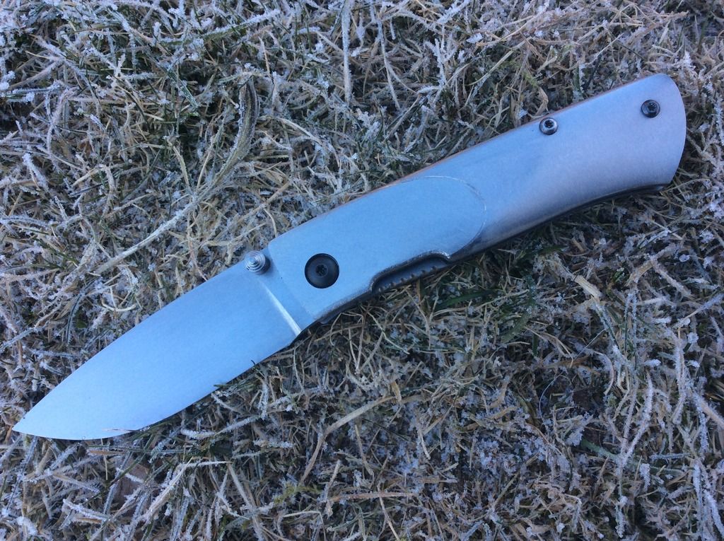

Most of the knives in this thread would work for me very well. I prefer fixed blades for their ease of cleaning and strength but since I´m a sucker for folders, I will show one I am making right now. With a 3" blade, this will work great as a folding hunter but I would choose a warmer handle material than Ti for hunting.
Still some work to do on this one but the overall shape reflects my thoughts.
