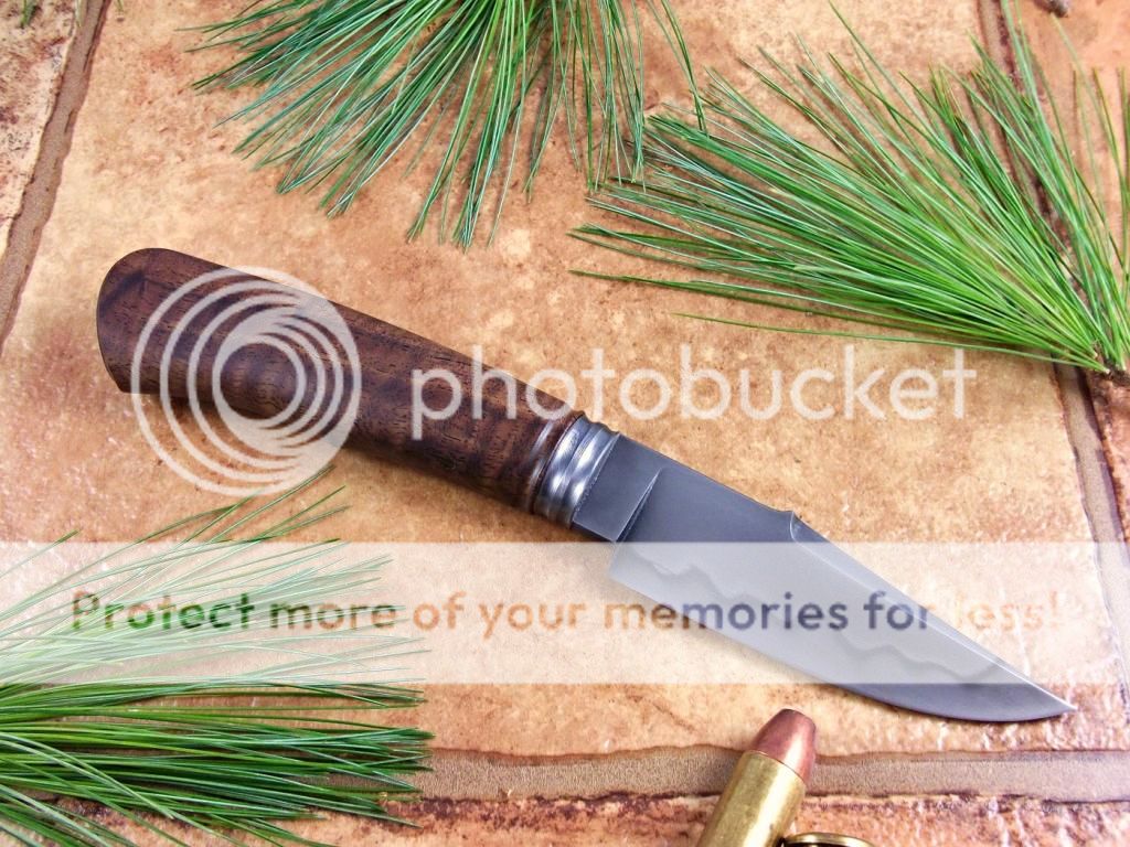

Here's one I made for myself this past season, mainly to experiment with a raised clip, not because it's necessarily my ideal choice. Used to field dress and skin 3 deer and it did just fine. This is 1095 and Claro walnut.

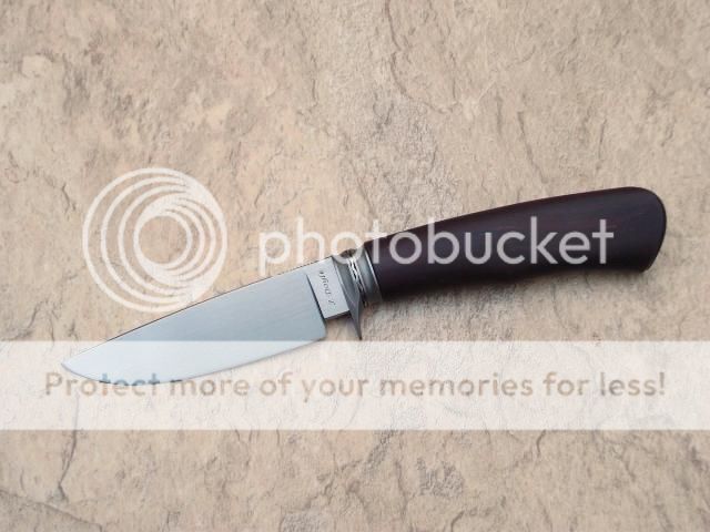

This is probably more my personal ideal hunting knife, only I'd have mine guardless. But for one with a guard, I like this a lot. CruForgeV and Madagascar rosewood:

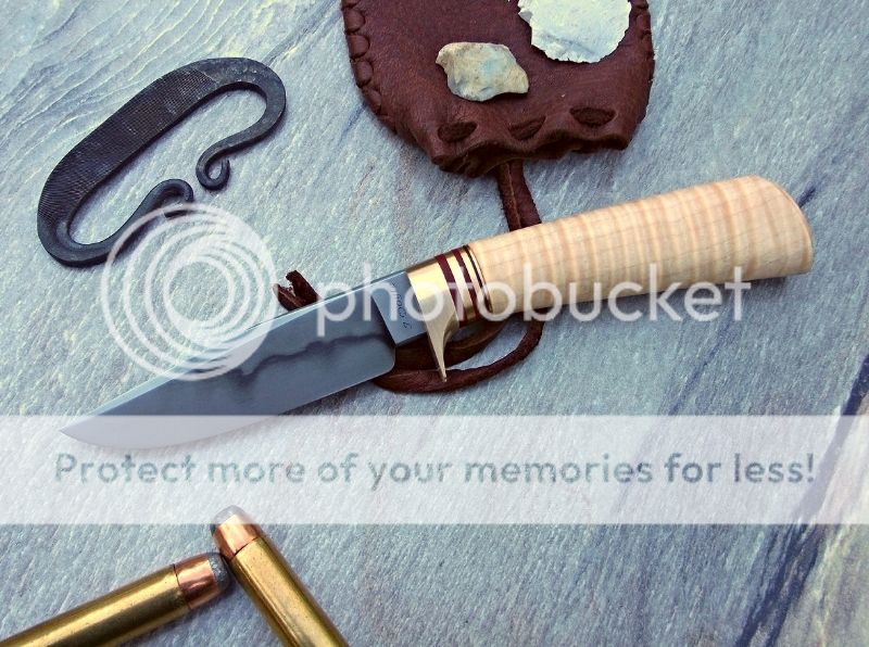

I also like these and they demonstrate some of the features that I like:
And for size, shape, and handle details, I like this one a lot. It may have a few more embellishments than most, including me, would prefer for a using hunter, but the other stuff is just right for me.

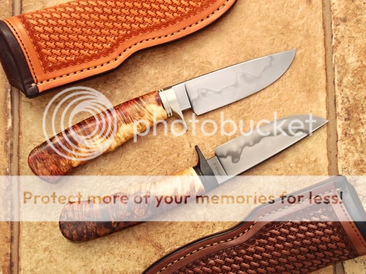

WOW! Who made those knives in your third picture down? I absolutely love them! Any info on them would be great!
Thanks for the kind words. I made them. Forged from 1075, box elder burl handles, stainless fittings on one and black g-10 on the other. Send me an email if you'd like some more info. jdoyleknives AT gmail DOT com
