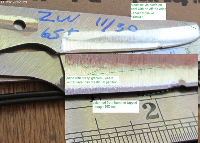

I stumbled upon one of my experimental zwear blade and only tested for toughness. 0.017" behind edge thick, 14 dps bevel. hrc reads from wheel ground tang (core hardness).
aust 1950f, cryo, tempered 325f 2x 15 minutes
* take this post as fwiw however lmk if it is noisy-garbage, I will blank this post...
Bluntcut, don't blank your post. Any info is good. This steel needs 6h of tempering, and possibly benefits from 8h. Your test shows a brittle steel in basically an untempered state.
It wasn't brittle at all, damage mode was deformation/dent, not fracture/chip. It could be hrc reading errors (guessed at edge) but I found this edge prone to roll/deform too much. keep in mind, this is way outside of the norm in term of ht.
edit to add comparison: same radical ht & specs - toughness among 3v, zwear and m4. zwear. zwear exhibited highest ductility, 3v, last is m4. for chopping blades - zw or 3v tbd.

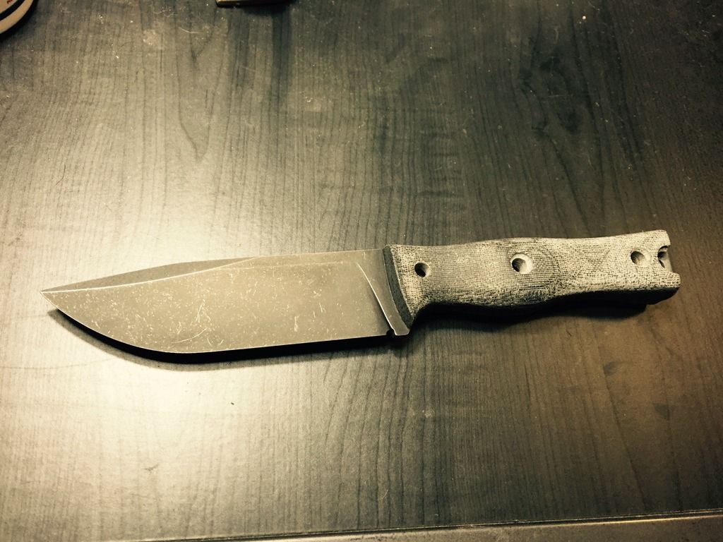

Z-wear scrap turned into a knife. It's the 1975 heat treat, cryo, 1000f 2hx4 heat treat. Rc63.5. It's great for breaking down chicken, or cutting raw bacon.
