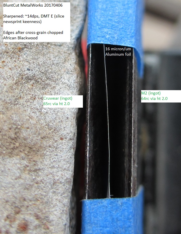

I bought a couple cru-wear(cast/ingot) bars from AKS. Made 2 test blades. Edges after tests (of 7" blade, 12" oal, cruwear vs m2)
*ignore lower half of cruwear (due to multiple deflected chops at the end of wood block).
* cruwear chips from too many repeated chops onto same area of rippled edge.
*cruwear: carbide & grain are more observable via eye-piece.
iirc: aust 1975F 45-60 minutes soak (over soak isn't an issue with my ht process) with cryo quench (2-5 minutes just to ensure blade equalize with LN2 temperature). peak hardness: 66.5-67rc.
On my next order, I might grab 1-2 bars of zwear for similar tests and compare. iirc (off brain rather than test log) zwear carbide dia(~2um) is a little larger than m4. That was the reason why I want to try cast/ingot version of cruwear. Results are excellent and as expected (at least for my ht process anyway).
