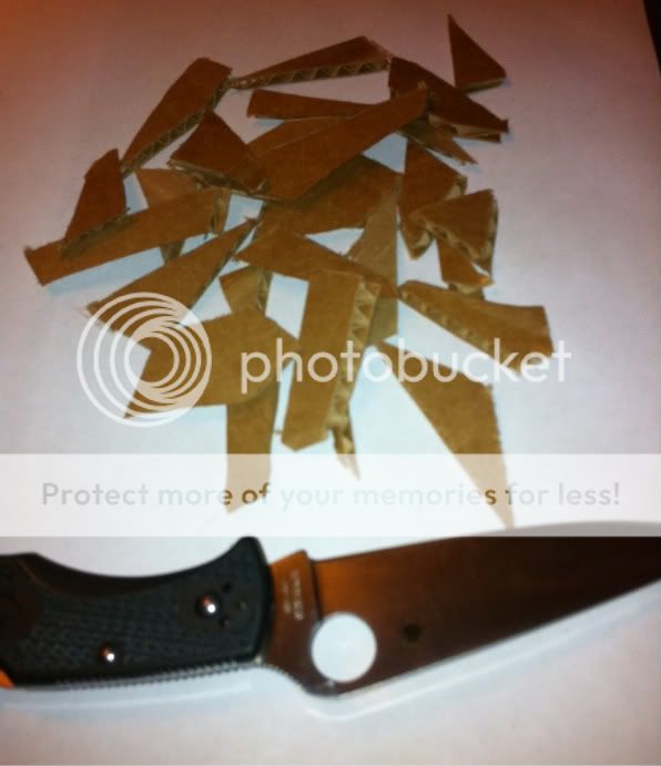

(post #55, i added another test where i cut a sneaker into many pieces.)

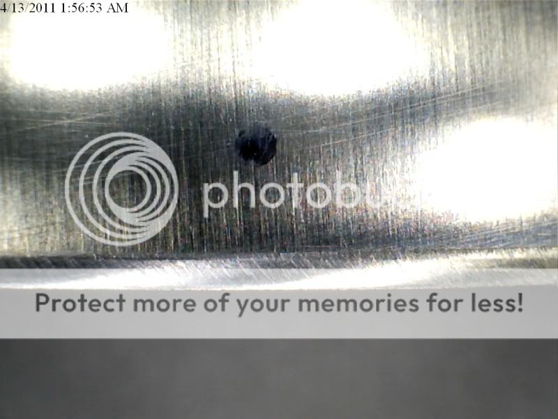

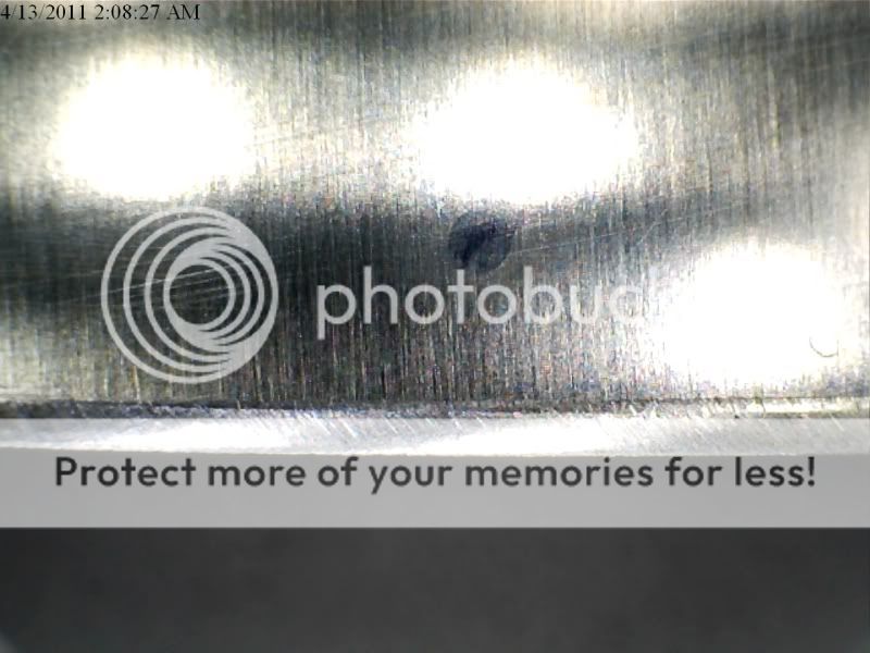

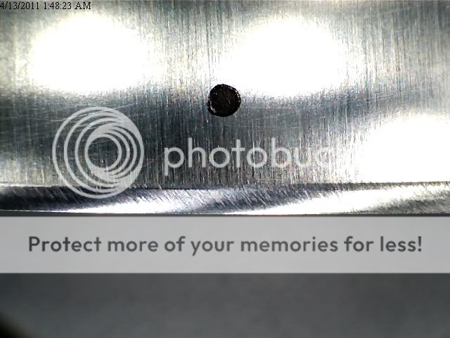

i just took my ZDP-189 spyderco endura 4 FFG and put a 18-20 degree angle (per side) edge on it. here are the pics of the edge before and after cutting up a coffee can.
all close-up pics of the edge are taken on my microscope at about 40x-50x. i used a marker to section off a part of the blade to i could scope the same spot each time.

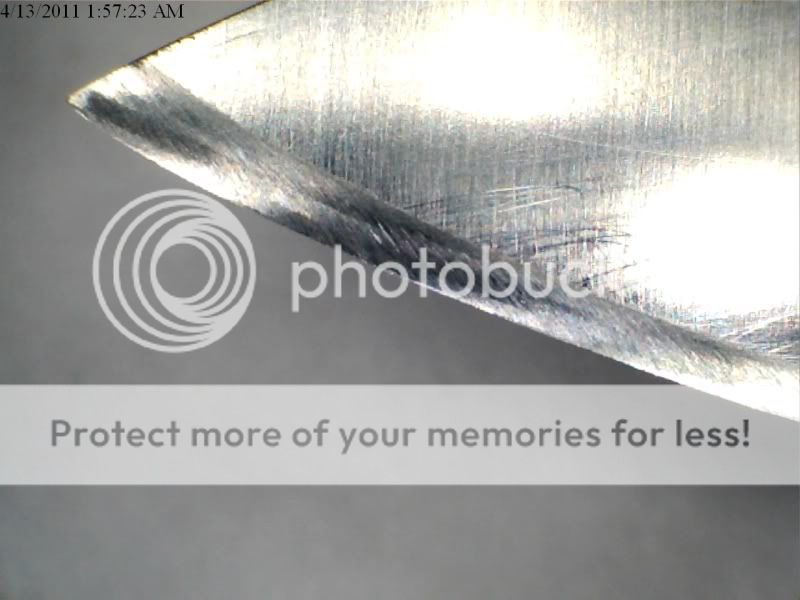

here is the edge right after i sharpened it, before i used it to cut:
ZDP-189

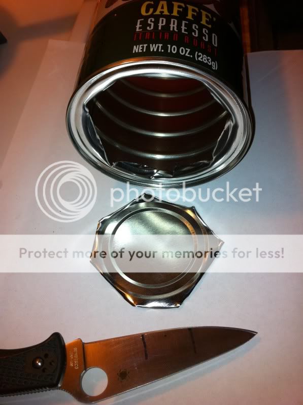

this is what i first cut with the knife. i believe i did 7 cut to take the top off of the can:
ZDP-189
here is the edge after those cuts:
ZDP-189

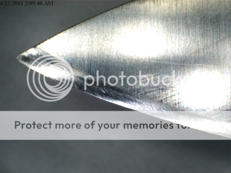

here is a pic of the tip after cutting the can (sorry i didn't take a before pic of the tip):
ZDP-189

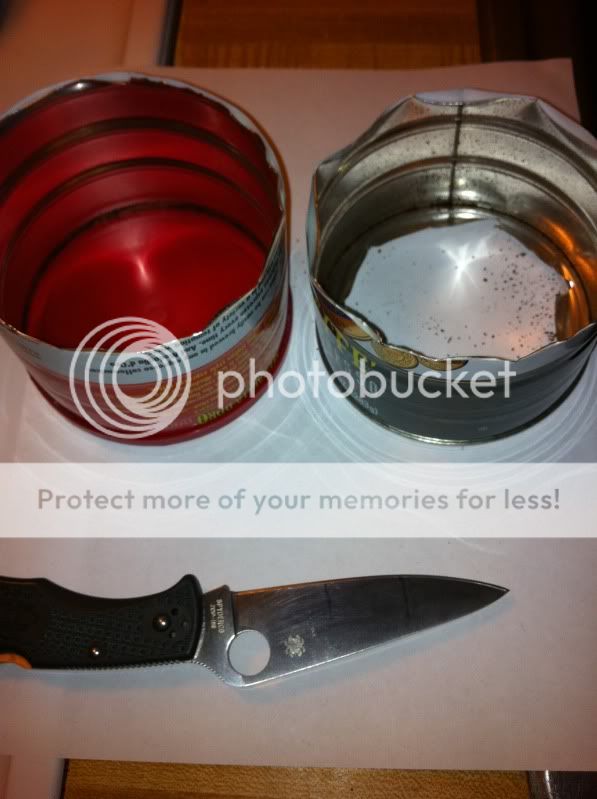

i then decided to cut the whole can in half (i believe i used 12 cuts):
here is the edge after both cuts (notice the marker is almost worn off):
ZDP-189
here is the tip after both cuts:
ZDP-189

i'll cut up a coffee can with my spyderco para2 S30V blade later on today.
no the edge didn't roll.

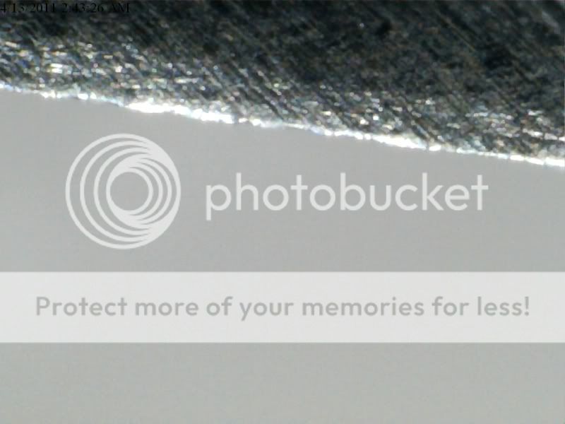

taking a pic of the edge straight on is nearly impossible for me. here is the edge (tilted), magnified at about 375X:
Hmm, looks a bit like micro-chipping, and I'd expect at least that level of damage no matter how super the steel is. Though I think it's fair to say that the steel will do well in a knife so long as it's kept to whatever a knife is supposed to be used for.
BTW, how dull was the knife after? Still cuts paper? Duller?
the knife would push cut newspaper against the grain before the test. after the test, slice cutting newspaper with the grain is a little difficult and cutting newspaper against the grain is not really possible, somewhat if i use a sawing motion. the knife still goes through cardboard easily and it would probably take me about 30 seconds to get this knife close to/at the sharpness i started with.

yeah, there is a bit of micro-chipping, but it's really only noticeable at higher than 50x magnification. like you said, i expect any steel with this blade geometry to sustain some micro damage after cutting up a coffee can.
