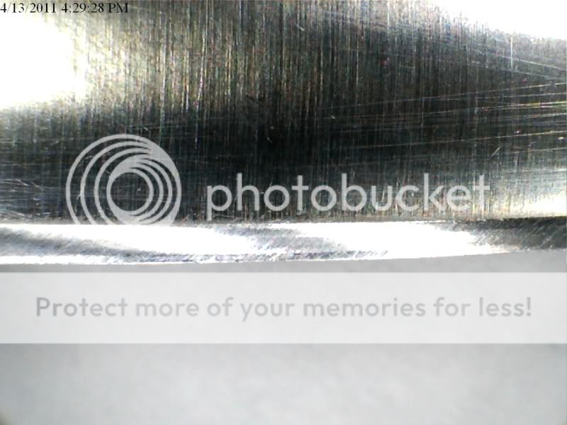

ZDP-189 edge chipping test:
very good edge retension, i see no problem with the edge after a strenuous workout. zdp seems to work well in regular pocket knives.--dennis

the thickness of the blade right behind the cutting edge plays a huge roll in that. the pictures im taking are at 40x-50x, the edge still looks excellent to the naked eye (and i have very good eyesight). if i handed you my endura 4 right now, you wouldn't even know i cut a bunch of metal with it (i cut even more metal, pics coming in a few minutes).

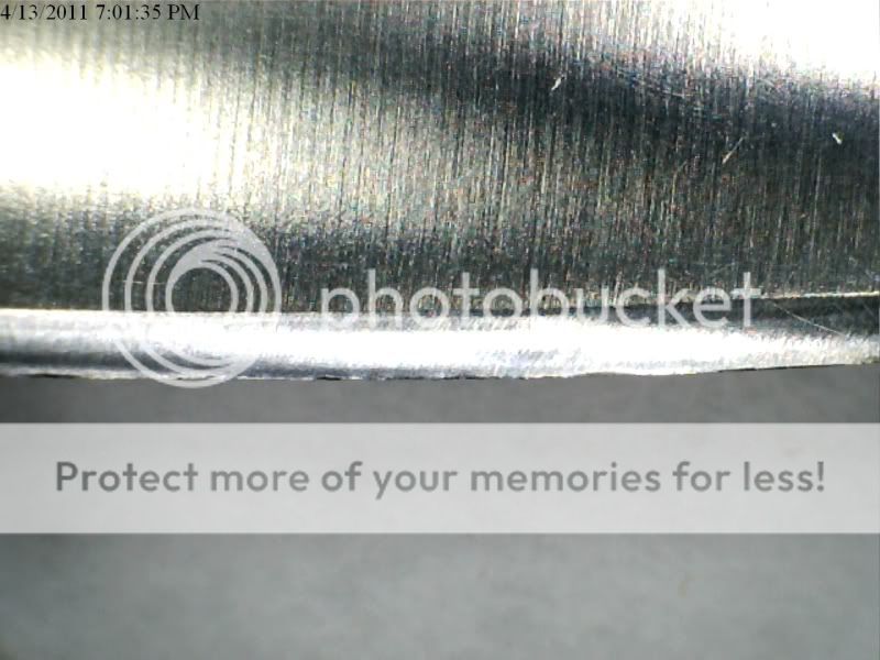

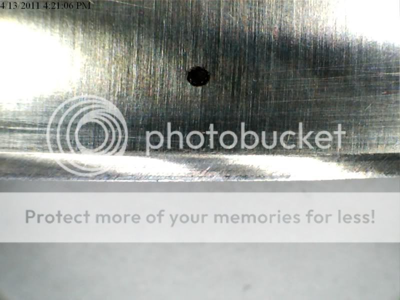

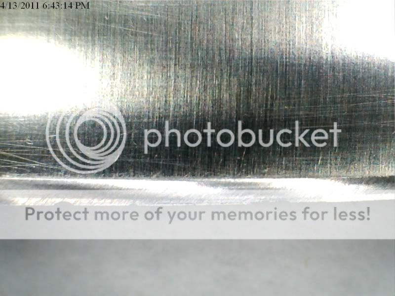

i decided to take the test one step further and use my endura 4 ZDP-189 and S30V para 2 (new thread coming soon), to cut lines in the side of a three liter olive oil can. these cuts were made in the olive oil can after cutting the coffee can (both knives) and some cardboard. i didn't sharpen either edge throughout the entire test. each line took about 4 cuts using only the 1 inch section of blade i marked off.
this is the ZDP-189 edge (40x-50x magnification) after 3 cuts to the olive oil can:
this is the ZDP edge after 6 cuts to the olive oil can:

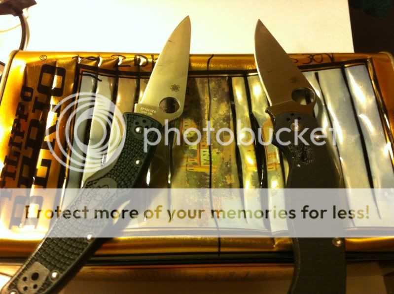

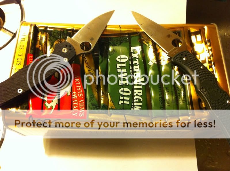

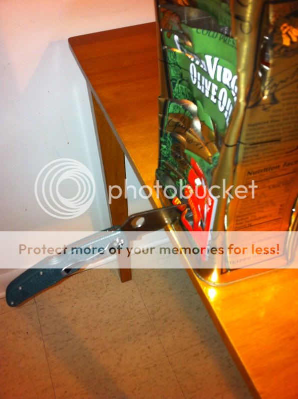

this is what the can looked like after 7 cuts with both the endura 4 ZDP FFG and S30V para 2:
i wanted to see how well each knife cut after:
1. cutting the top out of a coffee can
2. cutting the coffee can in half
3. slicing 15-25 piece of card board (about 2 inch long pieces)
4. slicing 7 lines in the side of the olive oil can (each lines took 4 cuts)

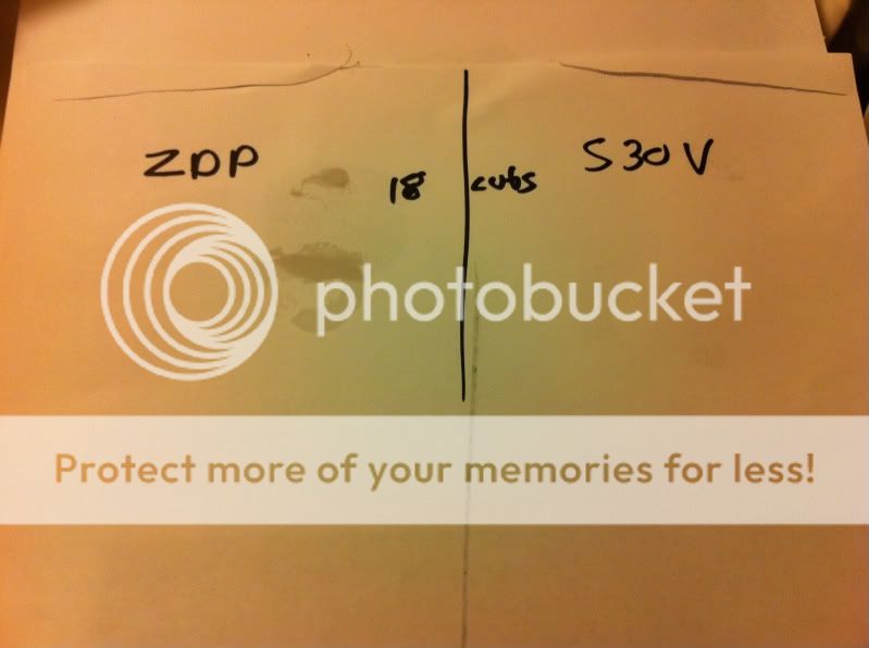

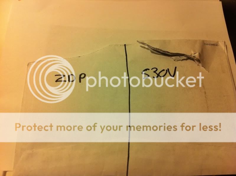

this is a credit card application (junk mail):

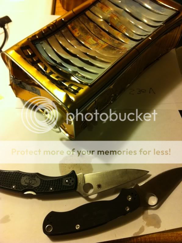

i took the test even further. i used both knives to keep cutting the olive oil can. each made 18 cuts in total to the can (after the coffee can and cardboard).
here is the olive oil can after the additional 8 cuts for each knife (15 cut's in total for each):

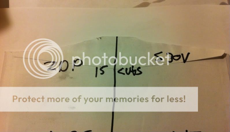

here is a credit card application (junk mail) after 15 cuts. i had to use a sawing motion for each, but the S30V required at least twice the amount of strokes to get a decent cut.
here is copy paper after an additional 3 cuts each into the olive oil can (18 cuts in total for each). again the S30V required at least twice the amount of sawing to achieve the cut:
here is the olive oil can after the test:
this is the last part of the test. i decided to try and cut through the rim of the oil can (after all the other tests). i pushed down on the spine of the knife with about 35 lbs of pressure and rocked the handle back and forth about 12-15 times.
here is the ZDP:
here is the S30V:

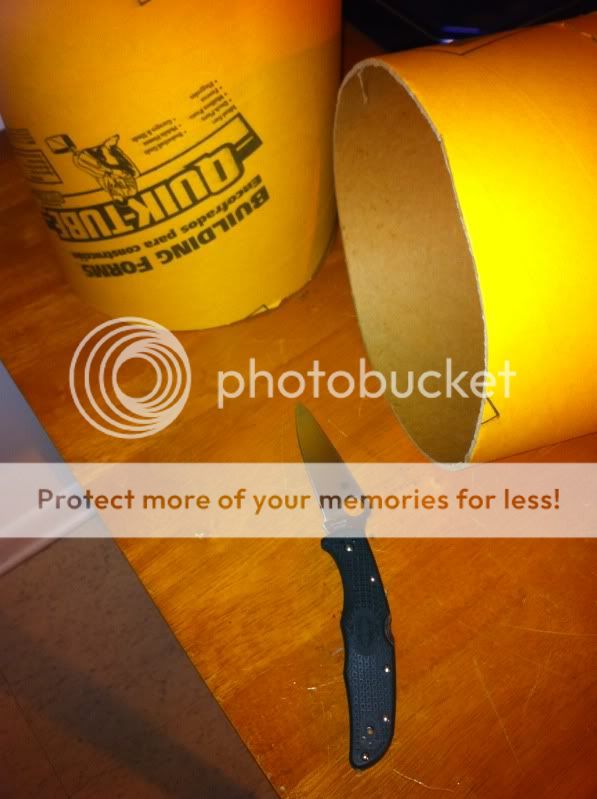

my daughter just asked for a piece of cardboard concrete form. this tube is 8.5" in diameter, the ZDP just cut it easily (after all the steel cuts).
