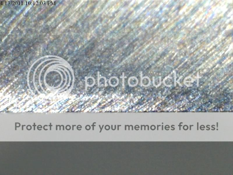

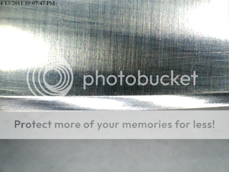

i wanted to see how long it would take me to remove all the chips on the edge and re-bevel it, so i timed myself. it took me 4 minutes and 46 seconds using only my 1000 grit norton water stone. after that i stropped the edge 4 times on canvas (no paste) and the edge was sharper than it came from the factory. i took it one step further and spent 2 minutes finishing the blade on the fine side of my hard arkansas stone (i think it's arkansas, it feels like 2000-3000 grit ceramic). i then stropped the edge 6 times on rubber.
here are edge pics after i sharpened it:
this is 40x-50x magnification:
ZDP-189
this is 375X magnification:
ZDP-189
absolutely. the ZDP did even better than i thought it would. the ZDP didn't showed any signs of damage until i tried cutting through the crimped rim.
those pics are at 40x-50x magnification, to the naked eye, the small dents and chips are only slightly noticeable.

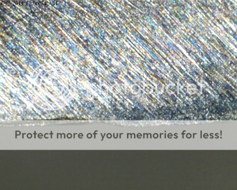

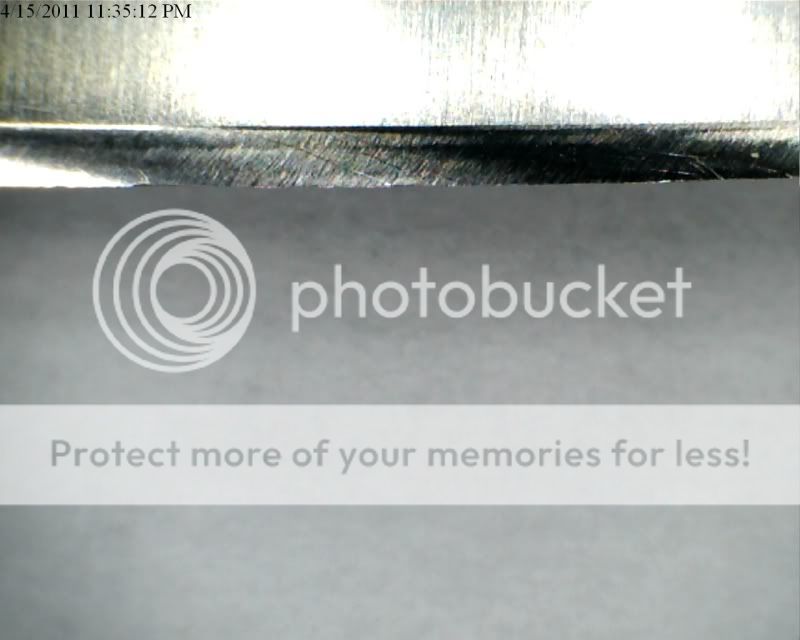

i decided to perform another test on my endura 4 ZDP. i figured the first test was me cutting metal cans why not try something softer. i took an old new balance sneaker (US made), size 12 and decided to cut it up. the edge angle was about 20 degrees per side. the rubber and glue was gumming up the blade, so toward the end of the test i was rubbing mineral oil on the blade to prevent that. i was hanging an inch of the shoe over the side of the table so the only thing the blade was contacting was sneaker. i believe i cut that sneaker into about 27 pieces.
before the test, the knife would easily cut newspaper against the grain. after cutting the shoe, the knife would barely cut newspaper with the grain (have to use a sawing motion). the knife still cuts cardboard decently.
when i was inspecting the blade under the microscope after the test, i noticed a slight trouble spot. with the naked eye, the edge looks fine. this pic is at 40x-50x magnification:

here is that spot at about 375x magnification:
ZDP-189
this had me a little worried. so i took a pic of the other side of the edge to check it. i don't see the lines on the other side which makes me think it isn't a micro fracture. i think that when the micro chips on the edge flaked off, they got caught in the rubber and scored a line in the edge. also, those lines are at the same angle and going in the same direction that i was cutting. i will double check this after i re-bevel the edge.

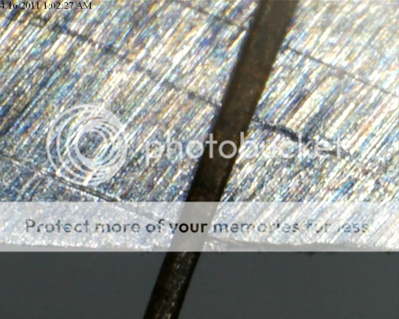

just to give everyone some prospective on how small that "trouble area" is and how things look at 375x magnification, here is that spot with one of my forearm hairs next to it.
ZDP-189

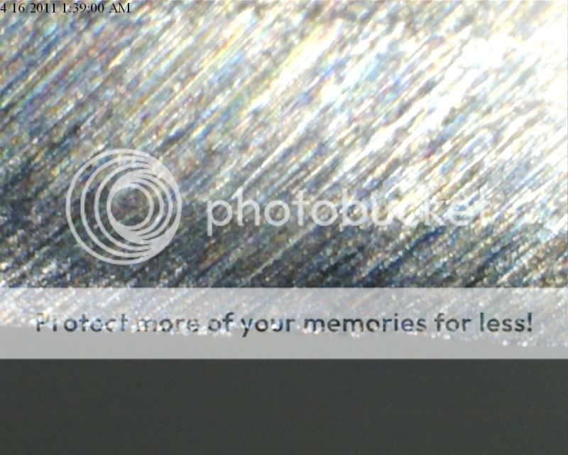

i wanted to see what it would take to get the edge back to good working order. i made 34 passes on my fine ceramic stone in this order 5-5-3-3-2-2-1-1 then i checked the edge and did another 3-3-2-2-1-1. except for 2 very tiny spots, the edge is about as sharp as i started with. i could easily EDC this knife tomorrow and not have a problem. here is a pic of the "trouble" spot after the less than 60 seconds of sharpening:
p.s. those "trouble" lines were just scratches
ZDP-189
