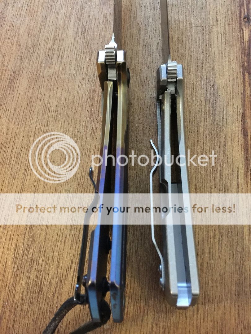

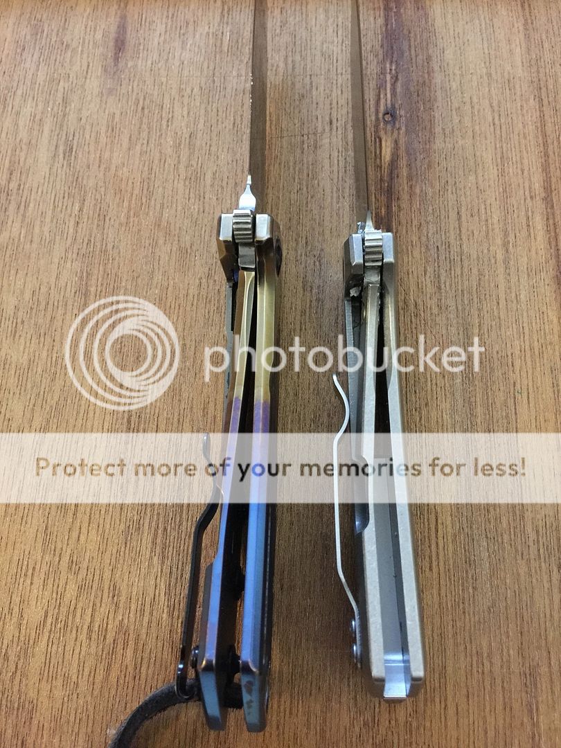

I myself have seen these cheap Chinese Hinderer type clones do this and I'm talking about the ones that cost around 10-20 bucks on ebay, that have a all steel slab frame lock, no insert of course and cheap G-10 on the other side.
Comparison Reate same type steel insert:
Just flipped
Flipped and lock bar pushed as hard as I can with two thumbs.
None of my ZT's do that.
My CRK Umnumzaan can be pushed most of the way over, but that seems to be the nature of the ceramic ball interface.
My Buck/TOPS CSAR moves over a fair bit in heavy use...it has a rather flat tang.
