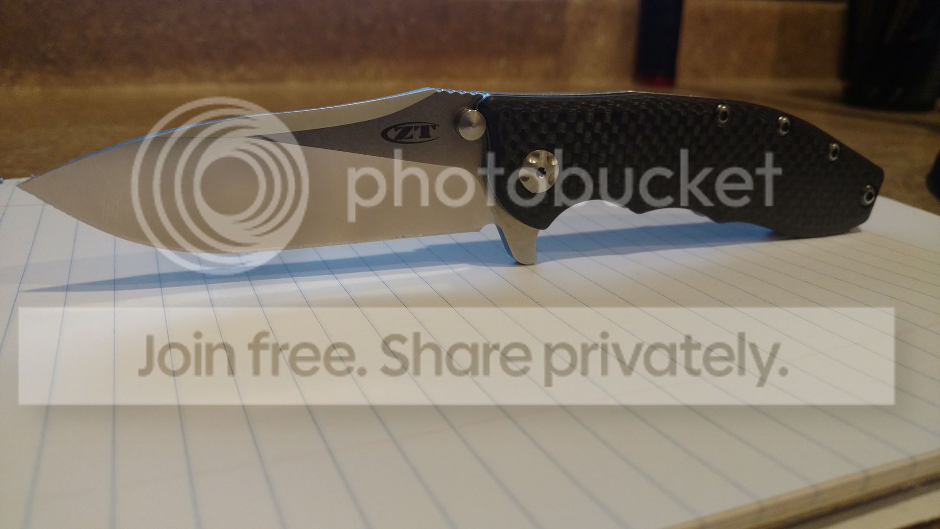

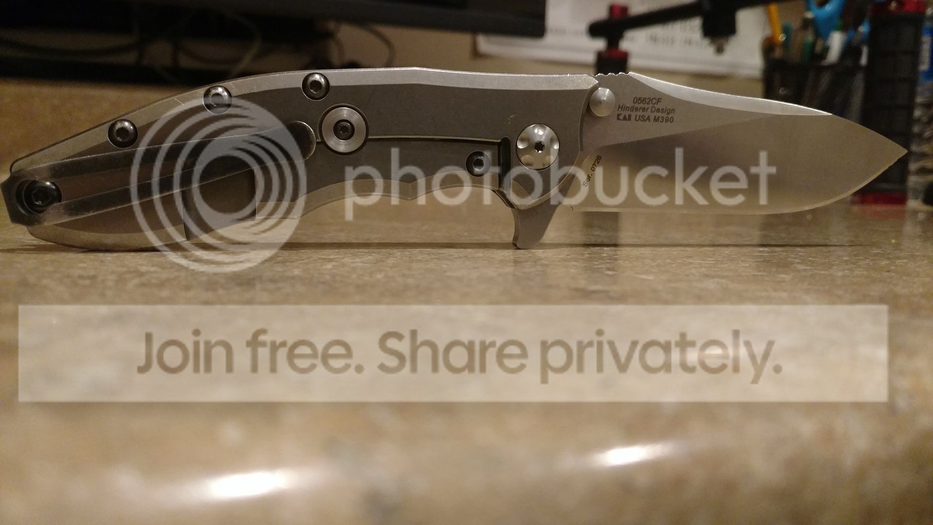

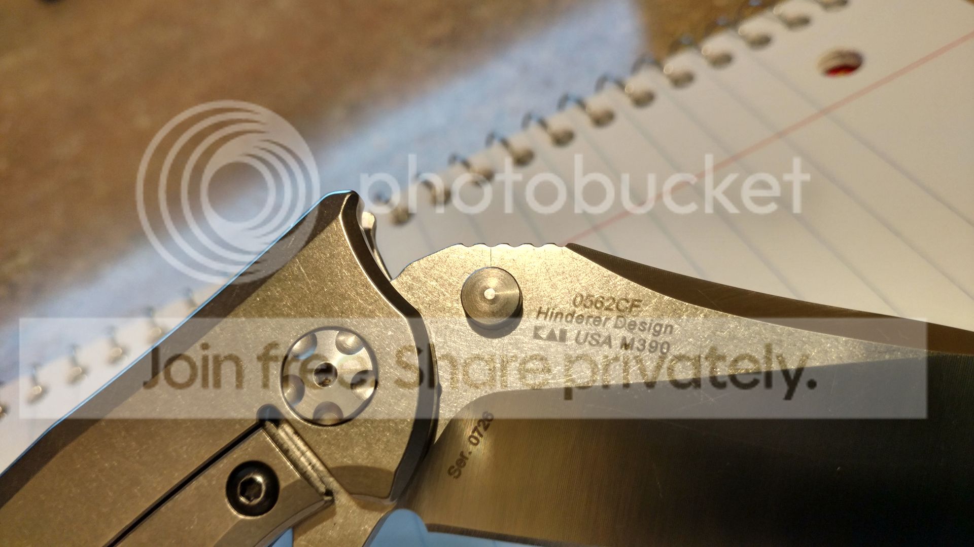

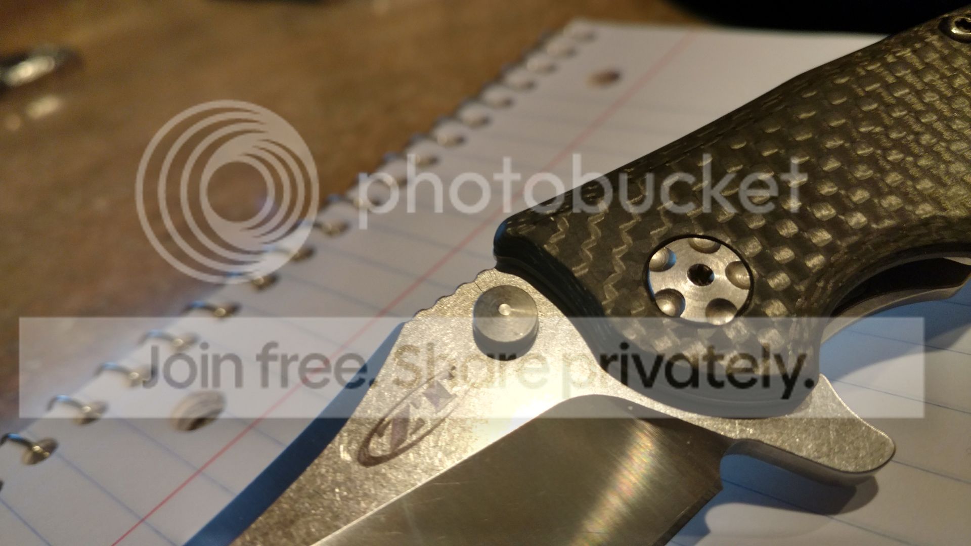

Any one else had there 0562CF M390 blade crack on the spine over the thumb stud? Going to have to send it in for warranty hope they fix it for free. Its my favorite EDC!

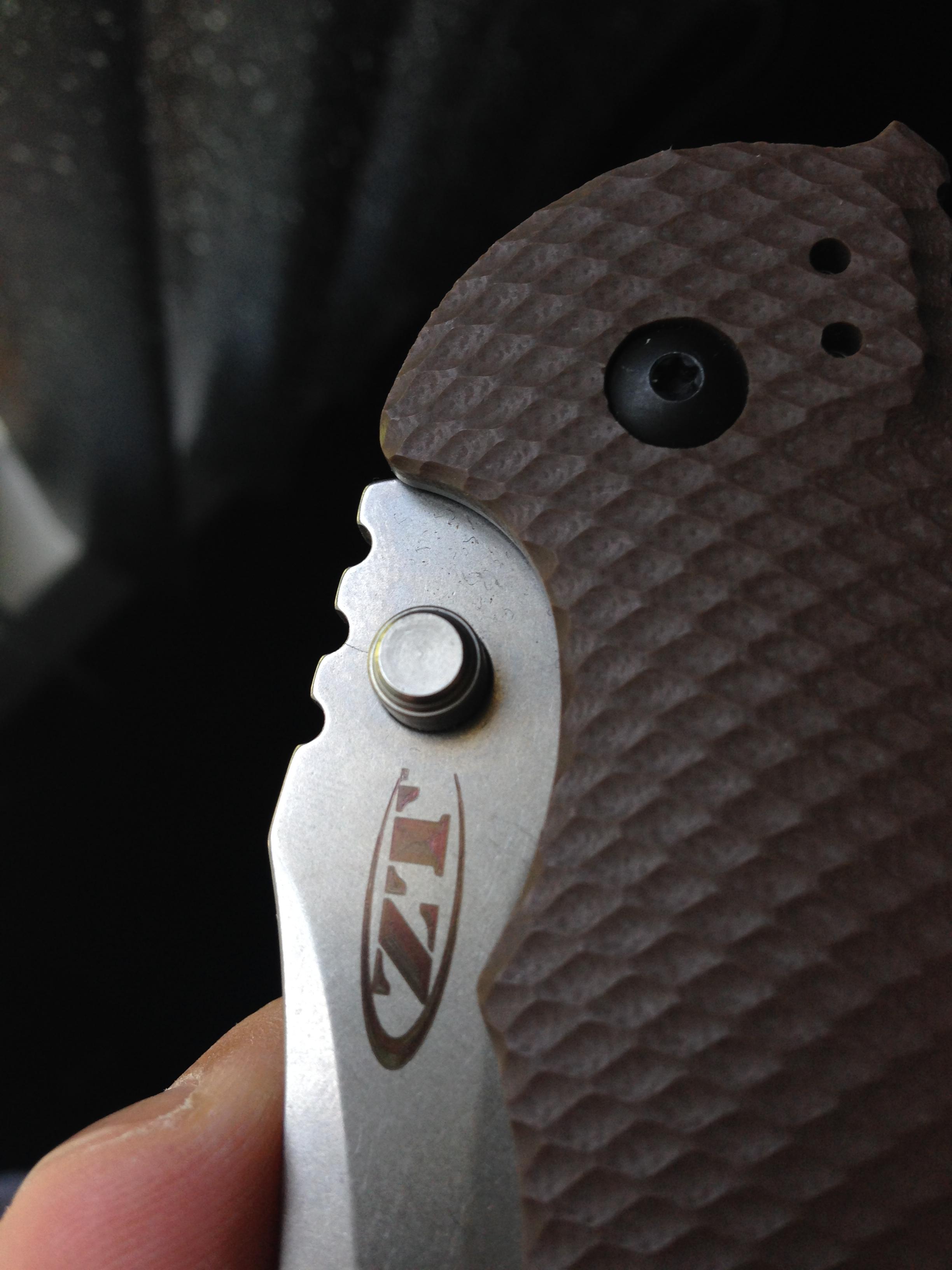

Looks like you're not alone...
From reddit:https://www.reddit.com/r/knifeclub/comments/2d5djn/new_knife_day_is_not_a_happy_dayzt_0561_cracked/
...and corresponding image:

I don't know how or when this happened. Could only see it in certain light. This is my favorite EDC. Used but not abused.
