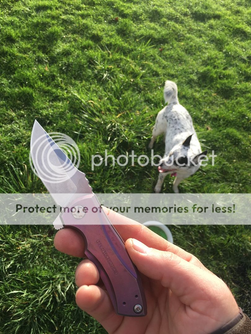

Here's my new grip my dad made me for my 566.
[/URL][/IMG]
Wow, very nice. I have so many knives I'd like to dress up like that. But don't have the fundz to let someone else make them, and don't have the time to do them myself (as if I could even come close to the quality of a real craftsman).
