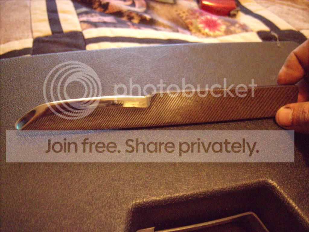

$0.75 Start to finish bushcraft knife in less time then it takes to get a pizza.
Edited as to not continue any felt hostility. Thank you for the helpful comments.
Everybody has to start somewhere, and my first knives were pretty similar I am sure. You came off a bit insulting implying that all of the people in this forum are wasting money on art, when what you made is just as good.
Having ground quite a few blades, I can say with some certainty that you overheated the file and lost whatever hardness it had. You could certainly heat treat it (tempering is merely one part of the equation) and get a usable edge out of it, if you choose. Stick around, and do some reading, these guys are pretty smart.

Why do you assume File = Good Steel?
Some files are case hardened. This means the steel on the outside is hard but the inside is soft.
Call me and I'll give you a free piece of blade steel for you to make a knife from. Have the knife properly heat treated and compare the knife against other knives you have. You may find the comparison interesting.

1. a 4 foot long bar of 1084 steel is less than $20. How many knives can you make out of that? Quite a few. That brings the cost down to compete with old files. Additionally, you then have KNOWN steel with KNOWN heat treating data that will produce consistent, repeatable results. Also, the heat treating regimen is near foolproof which is a plus if you plan to use a torch or a camp fire to heat treat it. You can botch the heat treat and still end up with a decent knife. These facts should totally kill the desire to use mystery steel and yet...........the myth that mystery steel is cheaper or just as good in quality continues.

I have seen blade tempering via propane torch or using a camp fire. I do not have an electronic controlled tempering machine and I am not sending it out to get done any suggestions?
Check out Murray Carter's videos and books. He does it by heating the blade in the forge (a camp fire would work as well) and sprinkling water on it. The way it responds tells you the temperature.
In his book he mentions, if I remember correctly, water pooling and evaporating, sizzling and evaporating, droplets dancing and evaporating and then the drops bouncing off.. each corresponding to a temperature range. I can't off the top of my head remember exactly the reaction you're looking for but I think it's the last one. Try it and test it until you get a temperature that works for you.

Is it possible to make a good knife from a file? You betcha, as long as its made from good steel and you don't get it too hot when grinding it. Bob Loveless made his first knives from files tempered in a galley stove on a ship and we all know how that turned out. I'm afraid that you got the one in the video too hot so I suggest you keep them cool from now on.

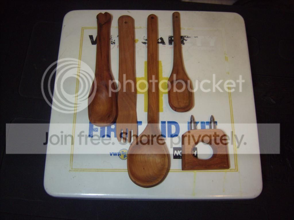

I know its not the same but I made these in the woods with a buck knife and some sand paper and a sharpened screw driver.
