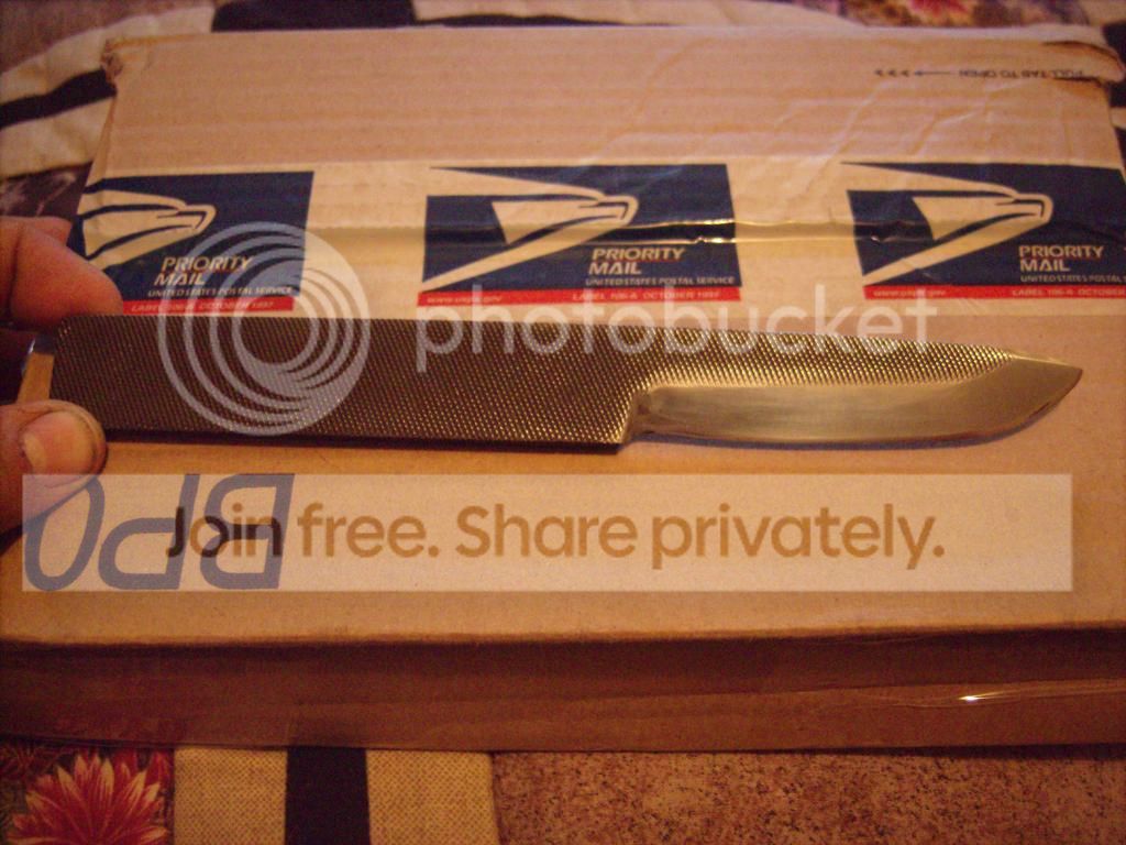

Well, I profiled my file kozuka. Looks good... so far.
I will be sending it in for heat treating thinking of doing something to the handle tho lol
I agree with Rolf, it probably needs to be heat treated again. You can anneal it yourself to make it easier to drill and file. All you need to do is take it up to a few shades above red with a torch or charcoal fire and them bury it in Vermiculite, Lime, or wood ashes and let it cool overnight. After that it should be soft enough to work fairly easily. You can then fine tune the bevels, shape the handle, etc. and then have Shaw H/T it.
The fact that a good known steel you buy from a reputable vendor comes annealed and ready to drill, file, grind etc. is much better for a stock removal knife than a hardened file or any other piece of hardened steel. Its not that the steel is bad, its just that its not as easy to work with hand or power tools. If you're gonna forge it really doesn't matter other than the fact that you're still dealing with an unknown steel.
