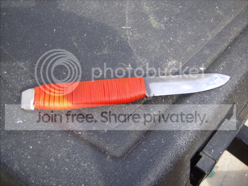

$0.75 Start to finish bushcraft knife in less time then it takes to get a pizza.
I suggest that you make what you want with cardboard or wood and then lay it on top of the billet of steel to get your profile just the way you want it. You can always take off a little more steel, putting it back is very difficult!
Why do you assume File = Good Steel?
Some files are case hardened. This means the steel on the outside is hard but the inside is soft.
Call me and I'll give you a free piece of blade steel for you to make a knife from. Have the knife properly heat treated and compare the knife against other knives you have. You may find the comparison interesting.

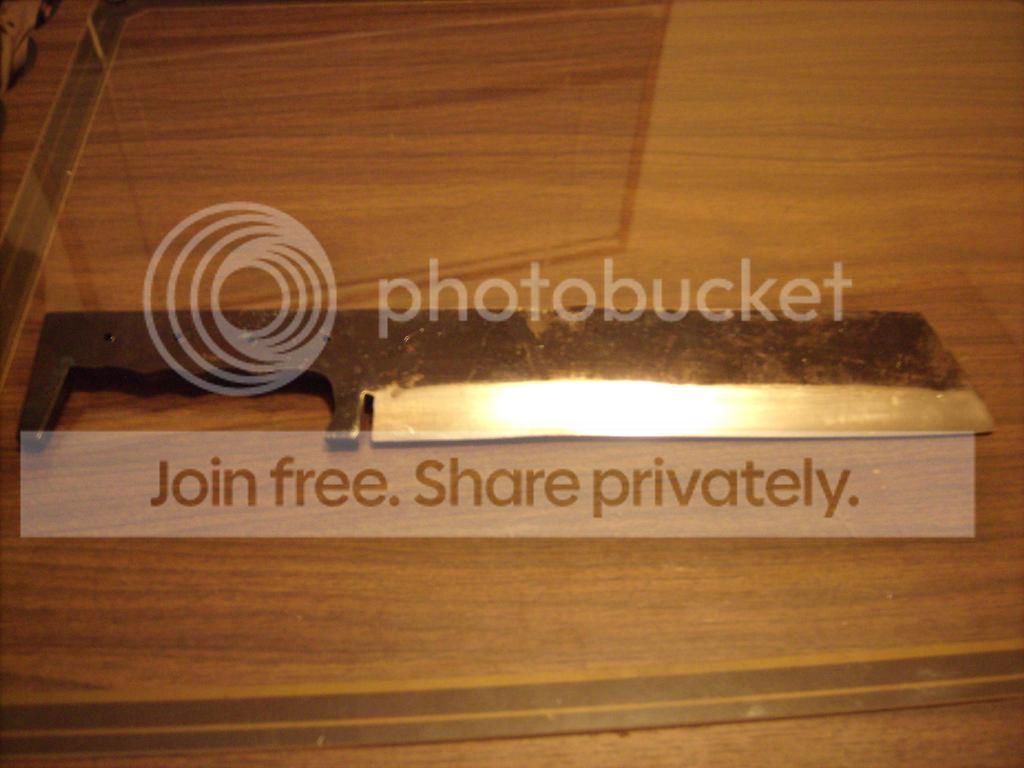

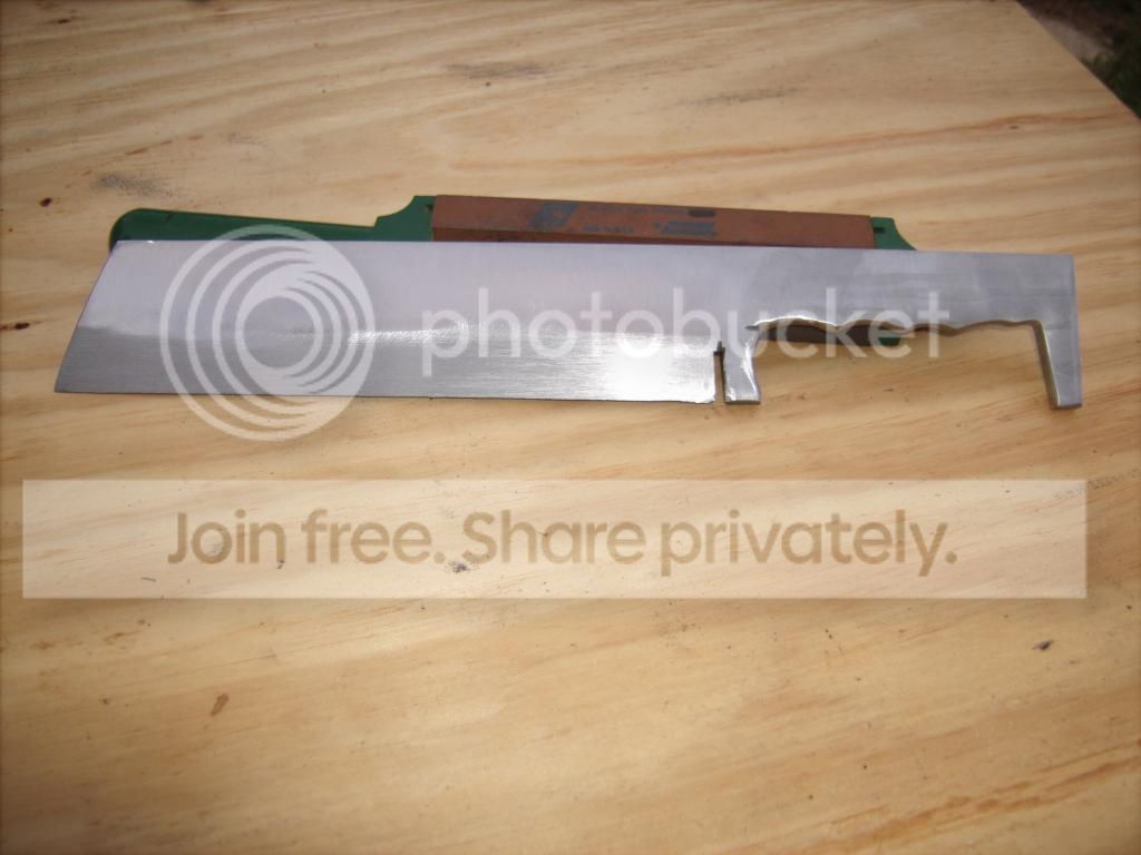

I dub this project Carnivore I think I am done for tonight not bad for about 4 hours of work but I had my girlfriend go get the pizza this time.

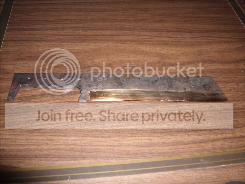

Well I followed the video and did my own heat treating. I have it tempering in the oven right now at 400. I followed the directions and got it hot enough to lose all magnetic attraction yay for magnetic retrieval tools. My buddy had 3 gals of used motor oil worked great did not even catch myself on fire lol. I guess I am just impatient it seamed to turn out well its a lot harder then it was. I think I see what the difference between the 2 types of knife making are. When I made my file knife I did not temper it first it was just as hard as it ever was. Which I think is why it seamed not to need any type of hardening and still holds a great edge and has decent edge retention. I did a lot of sanding to give it the profile which I believe is why it did not get hot enough to kill the tempering. The new knife with the 5160 seams like a different way all together. The knife blank was very very easy to work with like it was annealed from get go and very soft. I did most of the cutting edge with a big metal file it was just like filing wood with the amount of removal off each stroke. I was able to drill the holes through it like it was butter. Once I heat treated it it was like pulling teeth to get the final edge on it. I went convex on it to put some more beef behind the cutting edge. I went 3/4 of an inch back with the primary bevel and brought that all the way to the edge with a convex grind it seams to work ok for this. Thank you for all the help I still have some clean up to do and to put handles on it but I will take some pictures when I get it done. I think I am keeping the heat blueing on the main body of the knife to help with the rustic feel of it. I do not want it perfect I have already proved to my self I can get perfect or close enough to it for me. It is time to put it to work :) Thank you again Chuck from Alpha knife supply and Shaw blades for the offer of the heat treating :)
Right out of heat treat and tempering in the oven
I cleaned up the blade some and oiled it up. I may keep the forced bluing on there I may clean it up a bit with some steel wool to even it out a little but I like it :) I may go with red or red and black G10 scales for it because I am calling this project Carnivore

It is sad that you are in such a rush and don't read the stickys and post drawings, etc. If you had you would have known to drill the holes before HT. Also, you would have known used motor oil is not a recommended quenchant fro several reasons. It probably got your 5160 hard, though.

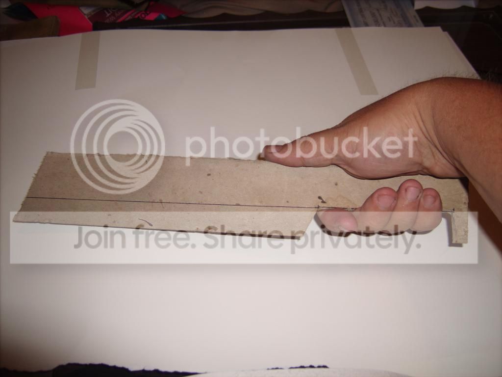

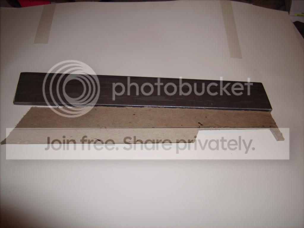

I actually did have a plan I wanted something a cross between a bowie knife and a cleaver. Its perfect I drew out what I wanted before I even got the metal and went with that. I made a knife blank out of cardboard and then changed the finger grips where they would be more comfortable. The holes were drilled before it was put into heat treating. I have read that 5160 can be cooled with used motor oil or vegtable oil. I also heat treated it in the oven for 4 hours at 400 degrees then let it cool down slowly.

"Its perfect"....I can't see many agreeing with that.
"Something between a Bowie and a cleaver".........I would suggest you look at some pictures of both and see where any resemblance could be found.
"I have read...." .....You may have read it somewhere, but I doubt you read it here or in any knife making text or article by an experienced maker. You-Tube is just about the worst place for a beginner to get knife making info.

I see the resemblance. I know its not for everyone and that actually is the point. Its for me and its ment for use does not need to be pretty. Its a replacement for my kukri. The only think I am worried about is from heat treating it bent the sharpened part in the middle of the blade inward. I figure since its going to be used and does not effect use then after a few sharpenings it should even the blade back.

Lets leave perfection out of it. That really is not something you should be concerned with right now.

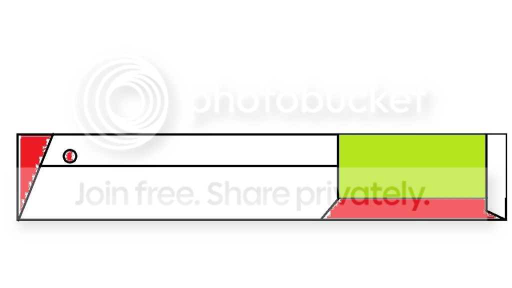

What you should be concerned with is the huge stress risers in that blade at the ricasso. There is very good odds that blade will break right at the peak of that slot.
I was wondering about mabe running a drill bit in there slowly to make it rounded edges instead of a straight edge. With straight edges it puts more stress then rounded. The whole thing is still about 1/4 inch thick and about 1.5 inches in depth at that spot.
