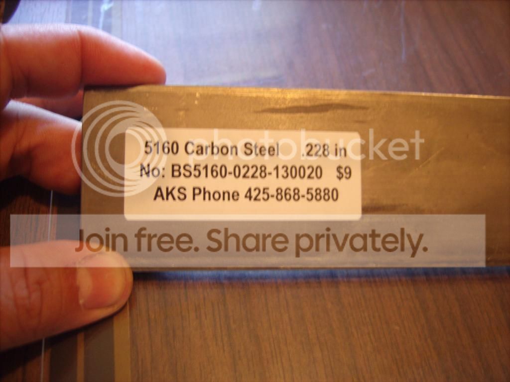

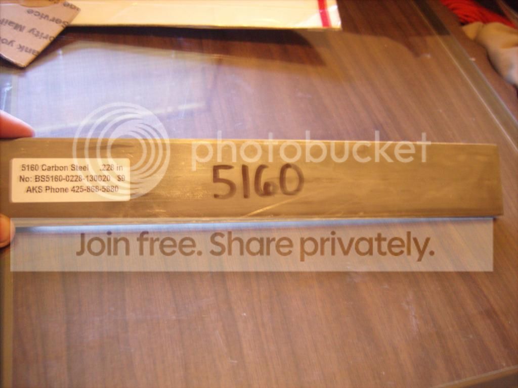

Thank you Chuck from Alpha Knife Supply I was sent out a piece of 5160 its a very large piece I am debating on what kind of shape I want to do so that may be the hardest part.

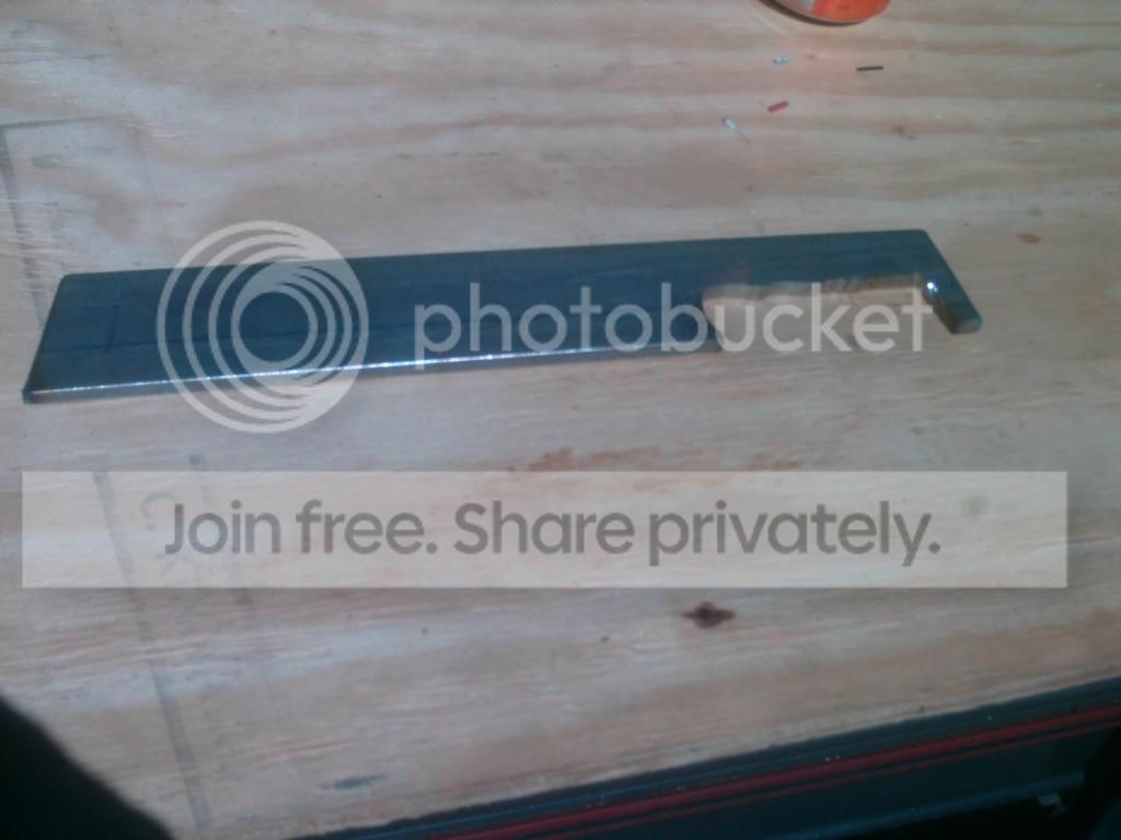

yeah I may have to dull the blade alittle before sending it in or wrap it with a piece of PVC or something when I ship it in. I started on the piece of steel tell me what you guys think so far. I want it to be a cross between a bowie and a cleaver so I can replace my kukri for a large knife for carrying into the woods. It still has a lot of work and filing out the finger indents but feels very comfortable already.
