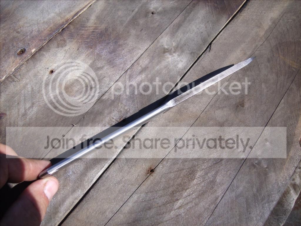

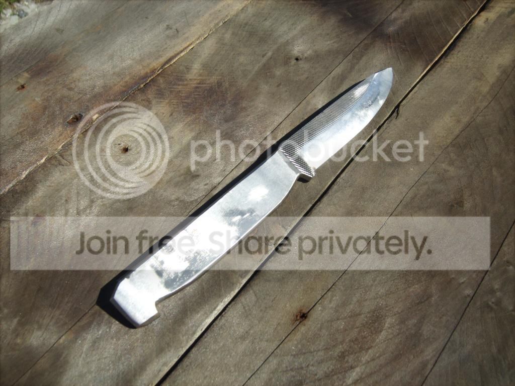

I screwed up must have been tired last night. The knife is still double bevel but I took off the secondary cutting edge and went straight down so its a v edge. The best picture I see resembling it says double bevel sharp. I figure this will be easier to hone in the field and seams to be sharper. Its still on a 3/8th blade so I think its still going to work well for bushcraft.
I got it to useable state within 34 mins. Now is time for the ummm toppings yes I will call them toppings. I spent alittle bit of time rounding the edges if I did want to wrap it in paracord this may be what I do but I am just cleaning it up right now thinking of the heat treating.
I think you're describing a zero edge (in Spyderco nomenclature). Traditional scandi edges are as such. They allow for a more acute apex while still being relatively thick at the spine or wherever the primary starts.
yeah I thought it was scandi just did not want to get that wrong. Same type of grind as my mora it seams to work well on this type of blade. Is this going to have issues heat treating? having a sharp edge and then thick spine its going to have alot of issues with the heat treating. I have seen alot of blanks killed coming out of HT.

I wonder if the teeth on a file knife are stress risers? Anyone? On the files that I made klo's with I ground off all the teeth. didn't matter because they never got a proper ht anyway.
I like the rounding you've done. I'd have rounded the spine instead of the tang, but that's just preference. I don't much care for wrapped tangs and the rounding will make it more difficult to fit scales. On your next knife, should you decide to go with scales, attach the scales first then shape the handle to include rounding of the tang. Don't overheat epoxy though. Are you intending to keep the teeth on the spine? It looks a little weird having the spine above the plane of the tang, but a wrap should fix that. The belly of the tang looks abrupt at the guard and butt. I'm pretty picky about handle & scale shapes, but again, just preference.
yeah it seams to be coming together it does not feel to bad in the hand right now but yeah if I put some scales on it now I may have to make them fit inside a little as the handle is still pretty wide. If not I may wrap it in paracord or even look around see if I can do some leather work and make a handle with a couple layers of leather to build it up but then I would have to worry about water getting into the leather and metal and rusting.

I have been using a HSS parting tool to scrape the high spots on my blades. Since I don't have a surface plate, or a nice grinder for blades, and my grinding hands still wobble, it helps me to find the high spots and sand them down with ease.
I just lay it on sideways and pull, scraping the blade. The high spots are quickly revealed. It is much easier to find them with one scrape than with repeated sanding strokes.
yeah the blade has a couple of low spots I an trying to get to. I am working on a stromp and black polishing compound to bring the blade to a shine and get all the imperfections out of it.
