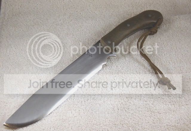

Finished this one a couple of weeks ago for a KITH on another Forum.
I'll finish up the one for this KITH this weekend. This was my first camp knife and about my 15th or 16th knife to make. I will say that joining in these KITHs pushes me to hone my skills and is great fun. Thanks for letting newbies participate.
O-1 tool steel, 3/16 inch thick
8 ½ inch blade, 13 ½ inches overall
green canvas micarta handle
stainless steel pins

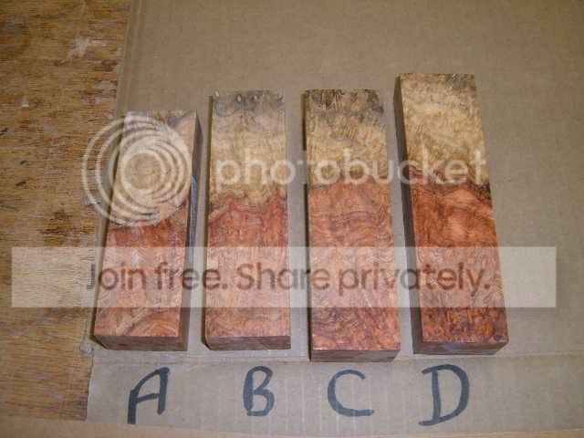

I got the 4 blades ground out today with the the bevels belt polished to 320 grit. I will hand sand tomorrow to 400 grit prior to heat treat. I did 2 blade styles with 2 of each type. The handles will be sappy amboyna cut from these blanks. I am thinking of doing red liners for a Chrstmas touch.
