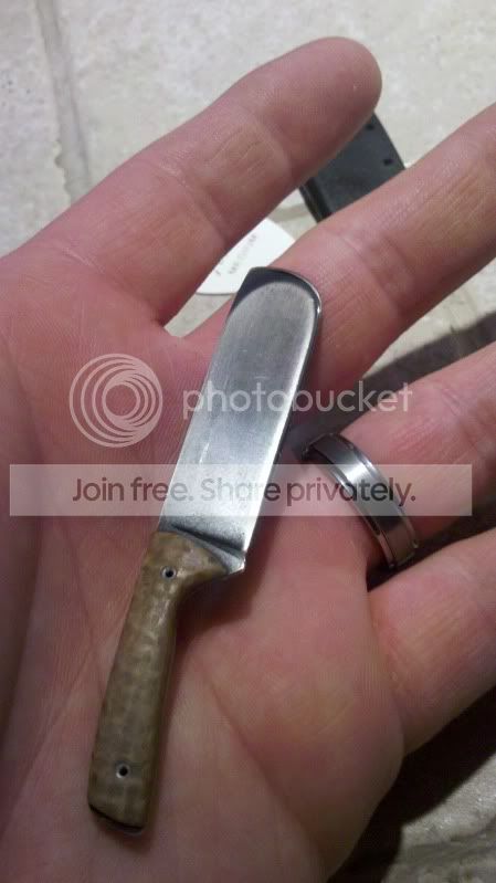

Figured i should check the mail...Lookie what i got!
Daniel....this mini is awesome!!! Great fit and finish on a mini! This thing is super cool!
Thanks for this :D
Mike
Also thanks for the Lapis!!! My wife is going to be stoked!
