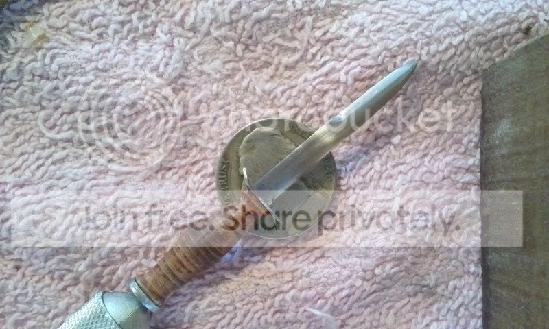

Some more progress today, got the pommel cut out and rough fit, handle is close to final shape, and the guard is getting a final fitting. Still need to do final finish sanding on all metal, finish needs polishing on handle as well. I am thinking about the best way to cut grooves in the handle without tearing a ton of fibers out. I was thinking of using a hack saw blade, but don't know if it will work well enough. I could always leave the handle smooth, but I have tried so hard to keep it true to scale I kinda don't want to skimp out now.
Anyways, here it is so far...
Still not sure what to do about bluing or coloring the metal, three different steels used so I don't know how each will take it.
-Xander

I would give them a ferric chloride etch. It should darken the steel nicely.Birchwood Casey perma-blue would probably be fine,too.
As far as grooves go, the best way would be using a very fine cut jeweler's saw blade. They come in thinness up to 7/0. If not available to you, use a small knife edged file, or a scalpel blade.

Thanx Stacy! Ill stop by Radio Shack and get some Ferric Chloride today. I don't have a jewelers saw or any quick way to get one, but I do have some knife edge needle files. Ill give it a shot, hopefully I don't screw it up! Now on to searching for how to etch and neutralize...

Now on to etching. With the PCB etchant, how long should I soak the mini? Normally, as I understand it, soak and wipe off scale every few minutes except let it sit for last 15 minutes. Then go to 30 minutes at boiling in fully saturated sodium bicarbonate/water solution.
Are there any issues specific to minis I should watch out for when doing this?

Etching is both an art and a science. Experiment and see how it goes; keep your immersion times on the shorter side at first until you are used to the results. The first etch will determine how clean it is so keep it very short.

Dilute the FC from Radio Shack 3:1 water to FC. This makes a good stock etchant strength. To darken the blade, dilute the stock solution 3:1 to get a 9:1 solution. This will darken the blade without etching it severely. Wash it well and don't touch with your fingers. Etch for a minute, then wash off and rub with a paper towel. Re-etch, rinse, wipe.... as many times as needed to get the desired effect. When done, wash well, spray with Windex, and boil in clean water for 10 minutes to set the color. You want the color darker than desired, as the clean up and buffing will lighten it. Buff by hand with a soft cloth and just a tiny amount of Flitz or Simicrome.

My mini KITH US M3 fighting knife is done and ready to ship.
1/5 scale
OAL 2.3"
Blade 1.36"
1080 blade, peanut oil quenched and tempered 2X @ 400*/60min
Guard - mild steel .025" thick
Pommel - mild steel .047" thick
Handle - CA soaked stacked leather 20 layers
Through-tang handle
All metal cold blued
Well I decided not to cut the grooves in the handle because I was not sure of my abilities to do it properly. I think it looks fine the way it is. Included is a special note for whoever gets it, I will let the recipient disclose the surprise when it is received.
