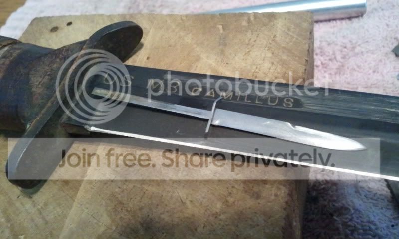

Sorry i have been away for a while. Zaph, the G.I.Joe size knives are crazy! That is freakin tiny! You making sheaths for them? The damascus is awesome, looks like a tiger stripe patina! Really nice. I am on number 13 now.....grrr. Great work. How hard was it to do the guard? I tried but keep screwing them up lol. I finally have one that made it past the HT and fit...might actually get this done yet. Nice work...I would happily take that...G.I. Joe and all :P
Dude, way cool! I was just thinking that the brown handled one looks almost camo patterned on the blade! Awesome that they are damascus, too! Are both of them going to be exchanged as one?

Thank you all, I'm glad you like them. I know I'm still a newer maker who's only been doing this about a year now, but I was getting the feeling that no one wanted to tell me how bad they were and that I should quit entering KITHs. I'm glad I was wrong.
Still not sure that I want to send out the second knife for the KITH. I don't like the damascus pattern nearly as much as the first one, and I'm not sure that the Koa pops enough on that small of a piece.
I'm having an absolute blast forging these minis. I'll make another one and see if I can do better.

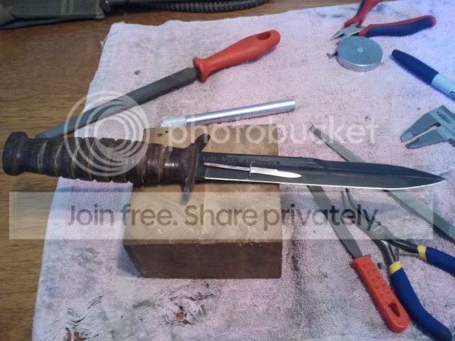

Well with working two jobs, the house, wife and kid, a truck that knows when to flash a check engine light because I have a day off, and jus life getting in the way I haven't hd near the amount of time I want to work on my mini. So today I decided that the truck can wait, send the wife shopping with my mother (they get along great), and take the boy to day care so I can work on my mini. Fitting the guard today. Still have a little finish sanding to do on the blade, shouldn't take long. Went to a couple places within walking distance to try and find some CA glue and neither had acceptable types. Anyways, maybe later ill go hit the craft store. Feels good to sit down, put on a good record, got my rum n' coke and a nice pile of files and sandpaper! Its coming along pretty good. And because I know it didn't happen without pictures, here you go...
And a shot for scale

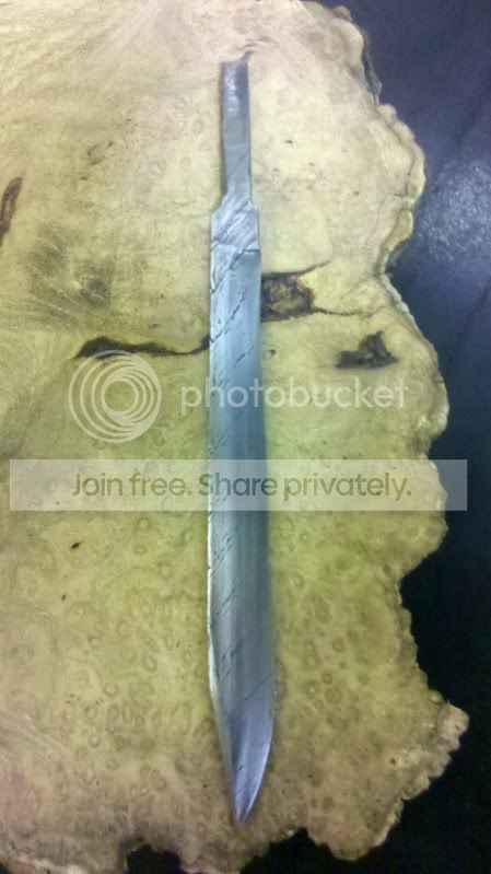

Oh, boy, I'm enjoying making these. Learning new things each step of the process. Then again, I'm still fairly new at making knives. My knowledge still outweighs my skill, but not my desire to learn more. I've never tried a katana. Then again, there are lots of styles that I haven't tried. I've yet to make a large damascus hunter, anything with curly maple, and for that matter I haven't forged the titanium camping utensils that I've been thinking about, either. So, I made a katana. Well, a katana blade, anyway.
I had a piece of 400 layer damascus that someone gave me last year. I cut off a 1/4" piece from the end and welded it to a rod and started forging. Absolute gut wrenching, watching the first hammer strike split the layers into five different pieces, each about 80 layers thick. One piece of the damascus was still flat, the rest were ruined and had to be cut off. Obviously I don't get to draw this out to the length I had predicted. Fortunately, the piece was about 1/16" thick still, plenty to draw out to a 1/32" thick blade. Using a smallish hammer, I forged it out to a nice hunter shaped blade, 2.5" long. There seemed to be a small imperfection in the steel, lengthwise down the blade near the edge. I annealed the piece and cut down the middle, leaving a long, skinny piece. "Hmmm, looks like an itty bitty katana like Stacy makes," I thought. I take it to the grinder and sure enough, I'm able to save a sweet little katana a little over 2" long. HT at non-magnetic for 60 seconds and quench. Straight as an arrow.
Now, how do I make a guard. Normally, I grab a piece of titanium and drill a hole. I grab a piece of titanium and drill the smallest hole I can. I slip the tang into it and quickly realize I need a much smaller drill bit. This isn't working, I realize, and it will never work. I see a picture of the screwdriver made into a punch and give it a try. Way too small and bits of steel go flying when I tap with a hammer. I look at Stacy's katana WIP and realize that it's not steel, it looks more like copper. I grab a pre-1982 penny and hammer it flat. Using another screwdriver, I punch a nice tang shaped hole in it. Nearly perfect. Just a little fine tuning, and I have a guard.
Where the metal flares out even looks like the part of a katana that covers the ricasso. Tsuba, suki, tsu-chi, whatever it's called, I hope that someday when I make a full scale katana it looks as good as this one does. Yes, I know it's called a habaki and should be a separate part from the tsuba and seppas. I don't have the needed tools to do this at this scale. Now, I just need to build a tsuka. (sarcasm)That should be easy, right?(/sarcasm)
I finished sanding the blade at 13 micron and can't see any damascus layers. I haven't etched yet, and don't want to until I'm ready to glue the handle on. But, remember the piece that I cut off the original blade that had the imperfection? Well, I decided to sand it and see what kind of pattern I have. 5 minutes sanding and 5 minutes in the acid and. . . .NOTHING! Well, I know you have to HT damascus to get a good etch, so I HT the piece with a torch and quench in water. 2 minutes sanding the scale off and 5 minutes in the acid. Still nothing. Hmmm, this is weird. I know it's layered, it split into layers when I forged it. I get out my USB microscope and become very happy.
If I get this finished in time, this will be my entry for the KITH. If not, the koa handled hunter will be entered. Attached is the current pic of the blade and the piece of damascus that I test etched.

Very Sweet Zaph, that is some tight damascus! That sounds like a lot of work going on there... can't wait to see the Tsuba, Tsuka and Saya (See Mike and Shep I have been studying!).

I finished the togi on the one I am entering about an hour ago. I will take photos of the blade tonight, and do the saya over the next few days. It is a 1/4 scale tanto. This is the largest mini I have done.
Togi on a full size blade is scary enough....gripping a super sharp blade with both hands and running it rapidly back and forth over the stones and papers. Doing it on a blade with a 3.5" ha is really tricky. There is so litte to hold on to. One slip and the cut could be bad. Luckily there was no blood anointing this blade....yet.
One of my maker friends saw it Saturday and commented that it would make a great pocket EDC. I never thought about it, but it is of a suitable length . I might make one with a non-scale thickness and blade dimensions as my new EDC, since I lost the one I have carried for years a couple weeks ago.
