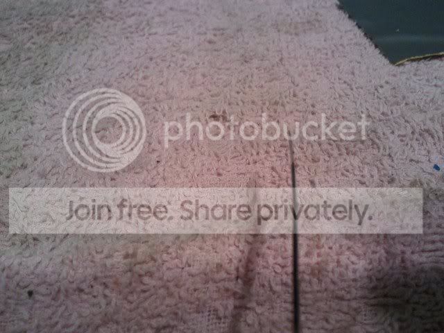

Today I seem to feel good after being sick for 5 days, so I decided to get the mini ready for heat treat. Got all the scratched out I could see, fired up the propane torch in the kitchen, warmed up some peanut oil to 150*, got the blade nice and bright orange and held it for about 2min then quenched. Here it is right out of the oil:

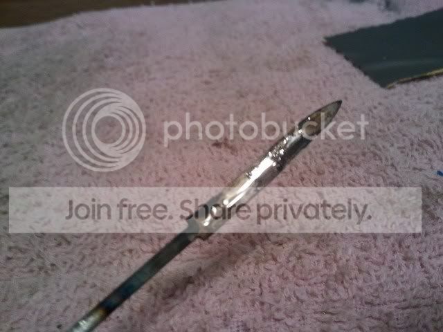

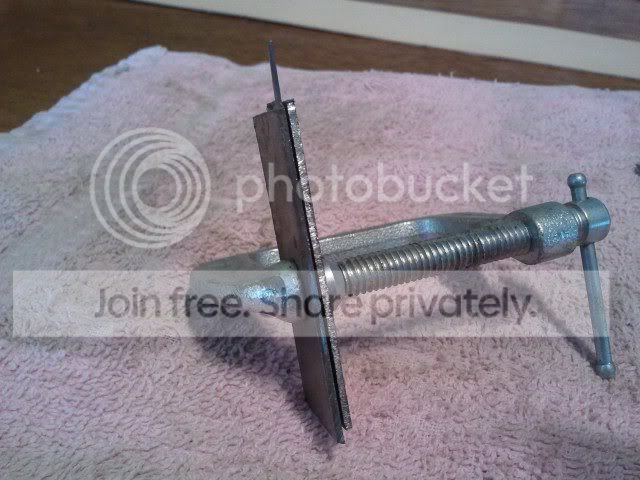

Uh oh! Got a little tweaked in the quenching, a slight bend but no twist. I went out to the garage, cut a couple of pieces of mild steel and found a small C-clamp. Clamped it all up and put the whole thing in the oven.
I have it cooking at 400* for 1 hour right now and will repeat this once more. Is this too high of a temperature to temper 1080? If so its only been in the oven a couple of minutes I can turn it down.

450F is not uncommon. 400 is a starting point.
Good to know. Well two 1 hour cycles are now done, everything came out a nice straw color so I assume it went ok. Plus for the thinness of this I think the little extra hardness will help. Also it came out straight as an arrow! Off to work now, so hopefully tonight I can get it sanded down an polished up. Next up is final fitting of the guard and stacking the leather handle.

Yeah it was nice that clamping worked, this thing is thin and I wouldn't want to try and over bend it to straighten.
