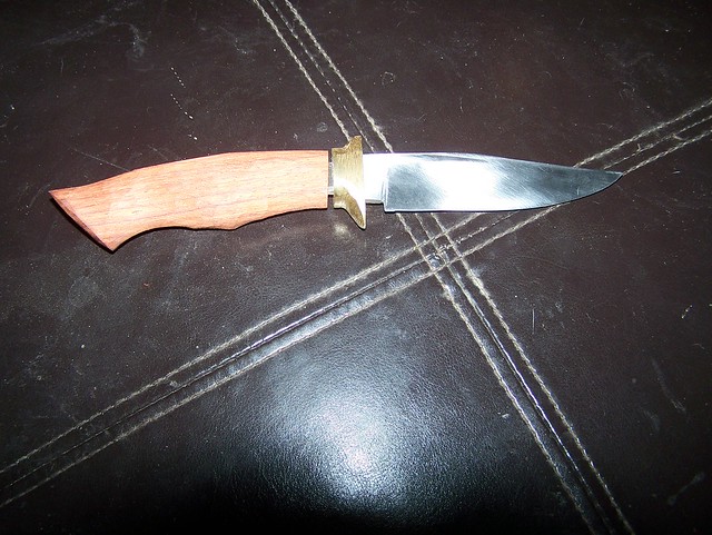

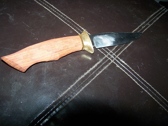

Lousy pics again, but here is the small knife. Guard and handle are oversize and will be blended down once its all glued up. I think I am going to use a unidirectional carbon fiber spacer on this one. I set up my mill this weekend, thinking the guards would be a snap, but my 3/8" collet, the only one I needed was not in the box. There was a second 5/8" collet in the 3/8 package. :grumpy: I tried to use the drill chuck but I ruined two guards that way. :grumpy::grumpy::grumpy: I'll redo the large knife guard tomorrow. I wasn't happy with the plunges on this knife, so I reground them. I am back at 400g, and will get the finish sanding done tomorrow, then glue up the handle. The large knife is final sanded and polished. Once the guard is cut, it'll be glued up as well.

I am nearly finished the small knife, and I have the large knife guard pressed and JB welded on. I have about an hour left on shaping the guard on the small knife (based on previous experience. Silly me, I forgot to drill the pin hole prior to sanding the blade. I did temper the tang back, so I should be able to drill it again, even if I miss the original hole. It would be easy enough to look at the earlier pictures, but I decided that was too close to the guard, so I did another hole a bit farther back, and don't have a pic of it. The handle gets sanded progressively finer with each coat of Danish oil. It is well balanced and feels great in the hand.

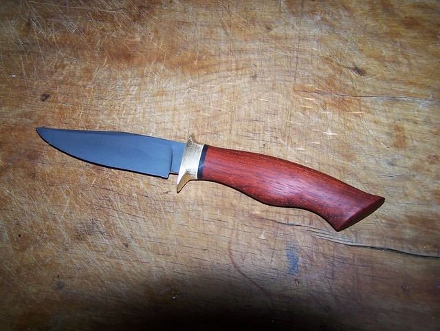

Both of my knives are finished. The handles are still tacky, so I'll get pics up tomorrow. I am very pleased with both, but the larger knife is the nicest knife I have ever made.
