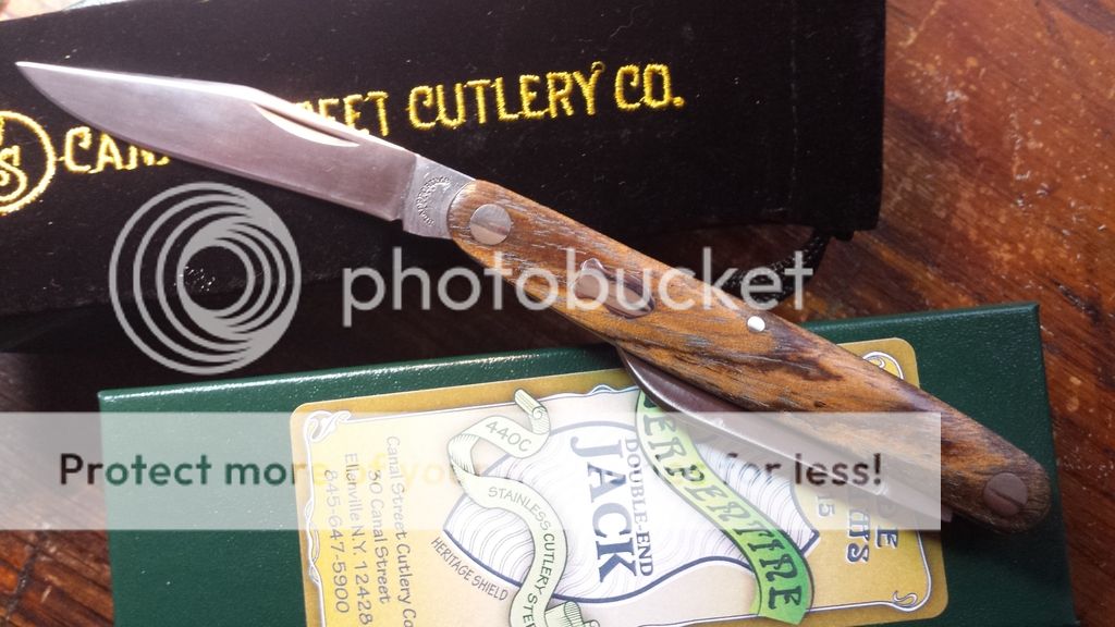

I am guessing the reason the blades may hit is due to a narrow frame if you pean the kick or put something inside you may run the risk of the tip being above the frame, they probably ground the kick so the tip ends up inside of the frame to protect the user
G2
You only put in what's necessary to raise the blade just that tiny amount to keep the blade edge from contacting the spring pin - trim the matchstick or toothpick. Very simple to do with no danger of stabbing/cutting/catching yourself when the blade is closed. It's certainly better than grinding and weakening the spring over the spring pin with a Dremel Tool.
