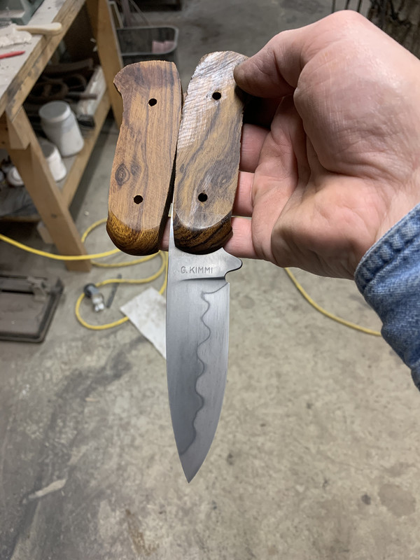

So I just got a 2x72 and will say this sure beats the hell out of my 1x30 but 36 grit is a bit much for me I had to start a new blade because I blew through the steel too fast. But with the time left I should still be on track. Will post some pics tomorrow of the redo
Dude, 36 grit is still to much for me. I’ve switched to 50 & 60 grit - and then just jump to 120. I should probably start using 80 in between, but it seems pointless.
Ever since I built my 2x72 I've been using 60 grit ceramic belts for roughing my bevels. They take material off fast enough for me. I haven't even tried a 36 for bevel work because it just seems like too much. I'm already spending far, far longer working up the grits to get a nice belt finish than I spend roughing in the bevels, and an aggressive 36 grit just increases the odds of me making a catastrophic mistake. (I'm making kitchen knives out of thin AEB-L, ground after heat treat.)

Just because my kydex stuff didn't come in, doesn't mean i need to stop. Got my buffs in, so gave it a final polish with some polish compound and a loose buff, then sharpened it. I know we're not all crazy about mirror edges, it just seemed to fit the satin well. 20 degrees per side for this edc - it's very, very sharp.

Was hoping i took enough off here to have a solid tight fit.
To tight, took more material off, resanded, rebuffed, ran back to my grandpa's to blow it out with his compressor - still to tight. Decided to take it inside, form the thumb ramp, battle with it tomorrow and decide if i need to just scrap it and make another.

Moving they eyelet closest to the handle a little further down the blade should help on the next one. The kydex will be able to give easier.
I have decided to scrap it and re-make it, i'll use this piece of advice on the next one, thank you brother.
