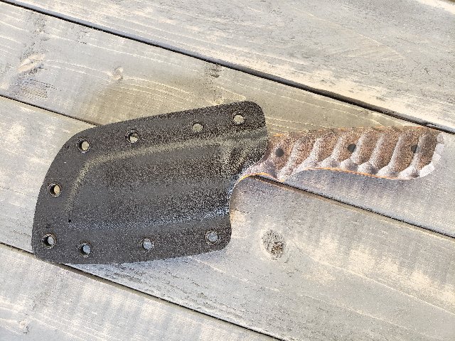

Starting working on the Kydex sheath and realized I didn’t order 1/4” eyelets? But I ordered literally everything else I needed, so I placed the final order last night. Might not have heated the kydex enough because the contouring around the knife looks great, but not the spine. We’ll finish and check everything, might make another though - order some more color options haha. I’ll post pictures as I work to finish. Will be done this week!!

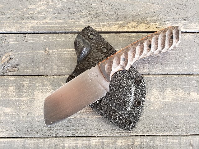

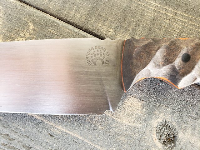

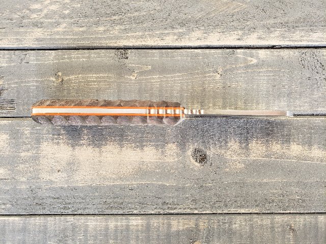

Here is my finished submission. Forged from 1084, the 3.25 inch blade, 8.75 OAL, has a flat grind with a convex edge, hand rubbed with a scotchbrite finish. The sculpted handle is dyed and stabilized quilted maple, with G10 liners and pins. I have included a Kydex sheath that will accept a large Tek-Lok (not included). Comments are welcome. I hope someone gets some use out of it.
Good looking knife! I hope my sandpaper arrives in time enough for me to finish!
