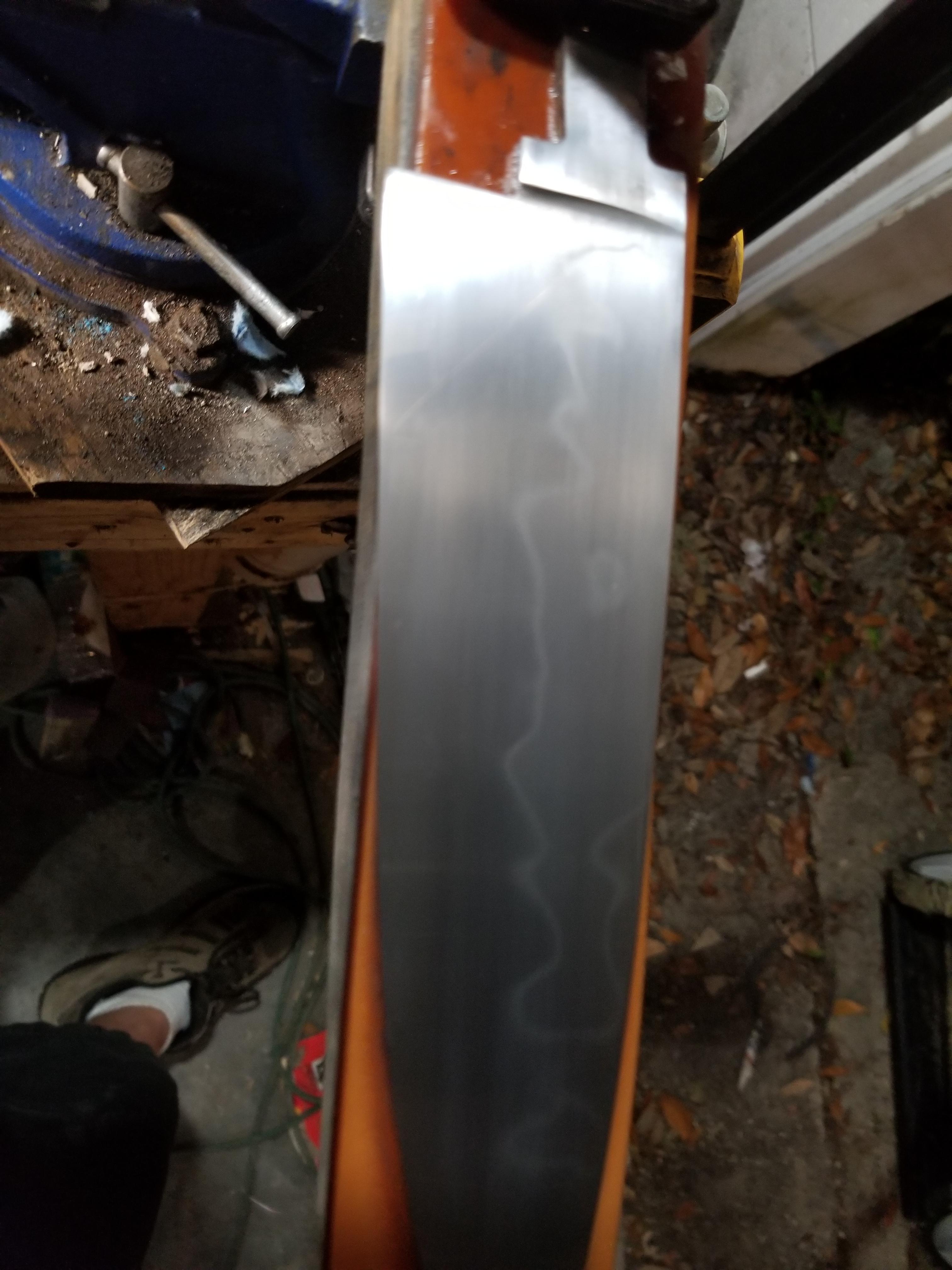

I heat treated a kiritsiku yesterday, corrected a small warp today, and am doing a quick etch to see the hamon after grinding off decarb with a 120g belt. I got Rc63/64 using my W2 protocol, 1460fx10 min, into DT-48, 300f temper. I went lower than the recommended 1475f, to see what type of activity I get in the hamon. I was going for choji. Pics later. I’m going to test heat treat from 1430f to 1480f to see what my optimum temp is in my shop.

I can see a lot of activity, but there is no way I can photograph it at 120g. I’ll post photos when I get it finished better.
Gonna try some different things after talking to Willie71 Willie71 but this is what I have so far

Just did my first HT with it yesterday. 1475°F 10 minutes, P50 quench. 66-67HRC. 2 hour temper x 3 @ 300F and it's about 64-65HRC, exactly what I was shooting for with this petty. I'll be grinding today, and hope to report back what hand sanding feels like. Should be quite easy.
John, that is a beautiful hamon. I like that banding as well. Like yous said, "Light but appealing". Can't wait to see what' I've got.
So how thick do you guys apply your clay on kitchen blades? I seem to have less luck with thin unbeveled W2 blades in that .100 range than I do say with a thick .25-.28 Bowie blade that had the bevels ground down to say .050 at the edge. Do you need to go a bit thicker and higher on the thin blades?
Yeah, I’d go a little thicker and further down. I was surprised because my first hamon was higher than I like, the second one was in a good place on the blade but if you look near the middle of my hamon, it looks like there wasn’t clay in some places where there was.
