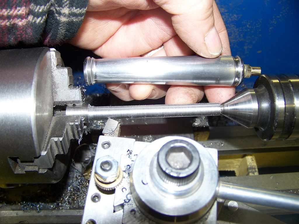

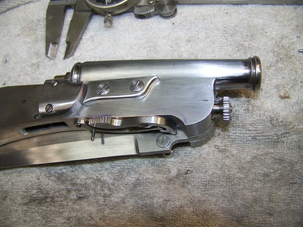

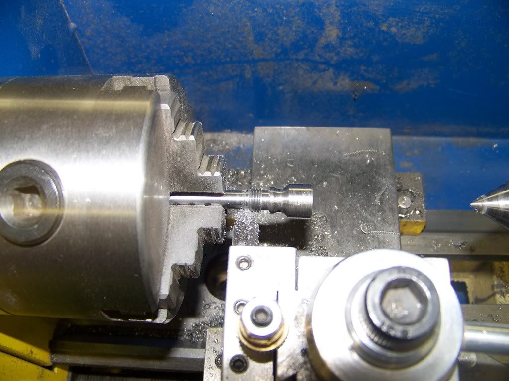

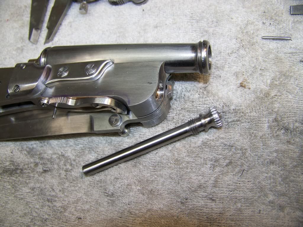

Made abit more progress the last couple days. I drilled and tapped the frame for the ram rod and turned some O-1 stock down until it looked like a ram rod. Also bolted the cannon (barrel) in place.
I had to turn the heads on all the screws and cut them to length for the bolsters. Next comes the ivory grips. I need to get this thing in the mail this week for the embellishments. Just a couple more days of tuning and tweaking first. I'm having a walnut display box with a beveled glass lid made for it already too.

Is that a nick I see in the cannon barrell?
Yep there is a bigger one on the other side where the blade scrapes it when opening and closing. This falls into the "tuning and tweaking" for a day or two. Dont sweat the small stuff. I'm more worried about the assisted opener that is still untested completely or the hammer/trigger engagement and spring pressure.

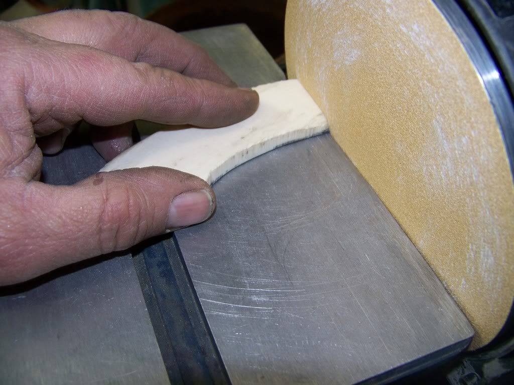

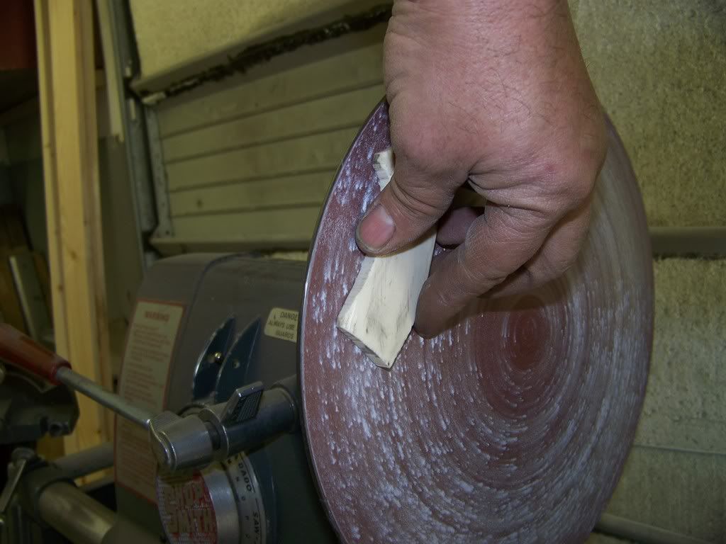

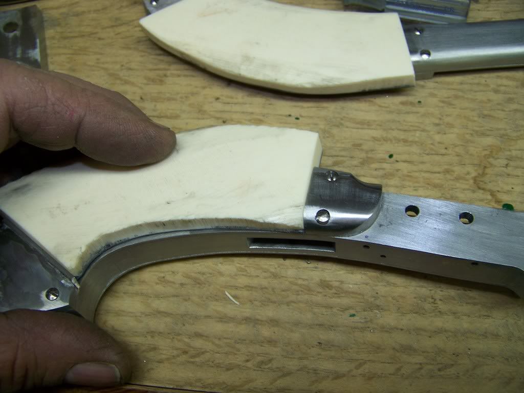

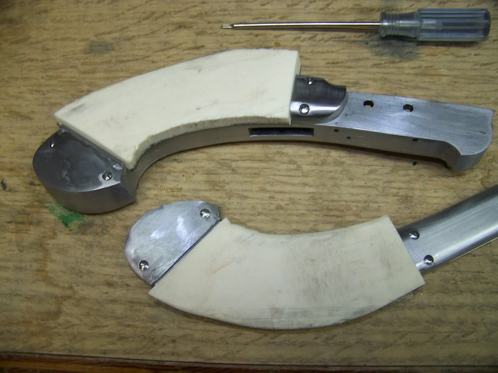

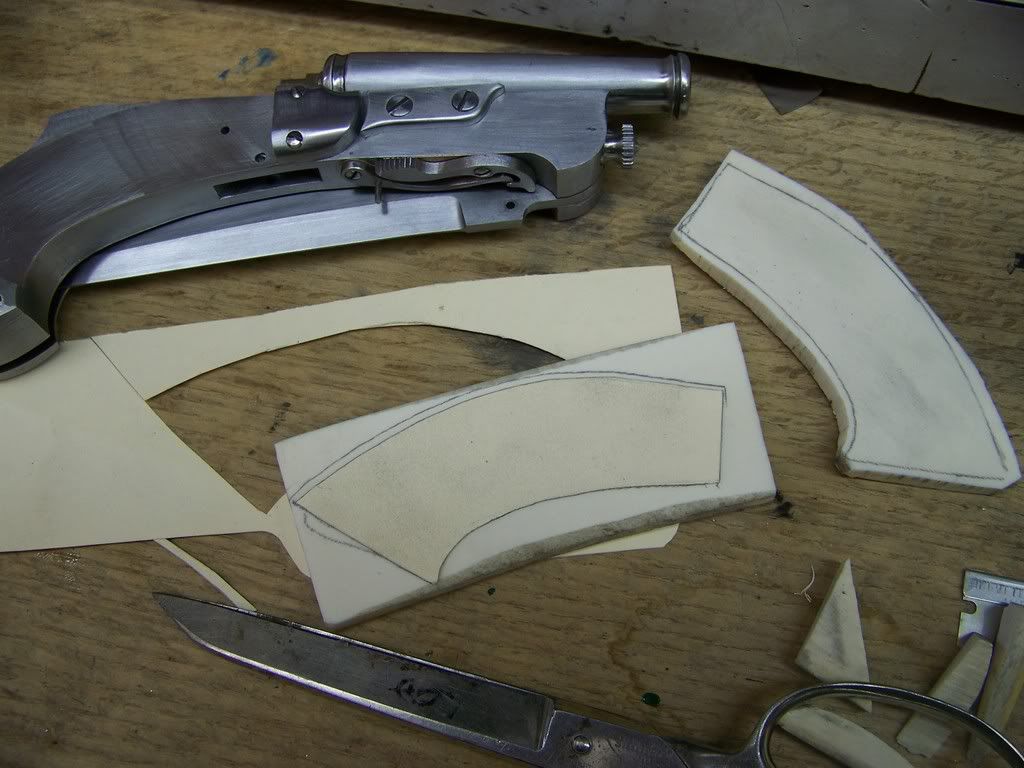

Today I worked on the handle scales. I flattened the back sides and glued a thin fiber spacer on to help seal them from moisture. The bolsters are slightly dovetailed so I had to match the ivory to them. The rear bolsters each have a thin metal spacer that will be file worked and it is pinned and superglued to them.
Bruce, is super glue the best way to attach fiber spacer material to the handle material? I have been using gorilla glue or epoxy, but they both make such a mess. If super glue is good for it i may start using it, sure would help with the cleanup. :D
I only use super glue now. I really think its the best way to go. There is no clean up really. Not all super glues are created equal though. I hate that cheap stuff from the dollar store. I like EZ bond as it will give you some time to get things put together and clamped. I also use the accelerator for instant drying or the de-bonder if things go wrong.

Looks great, Bruce. I assume that you are making this a take down construction?
Yes, it pretty much has to be a take down because there are so many parts. I could permanatly attach the scales but I may as well just drill them for screws. I thought about tig welding the barrel in place too but its easier to remove and clean by just removing 2 screws.
