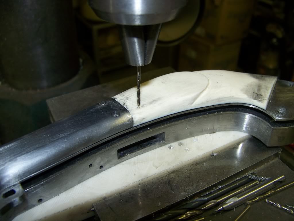

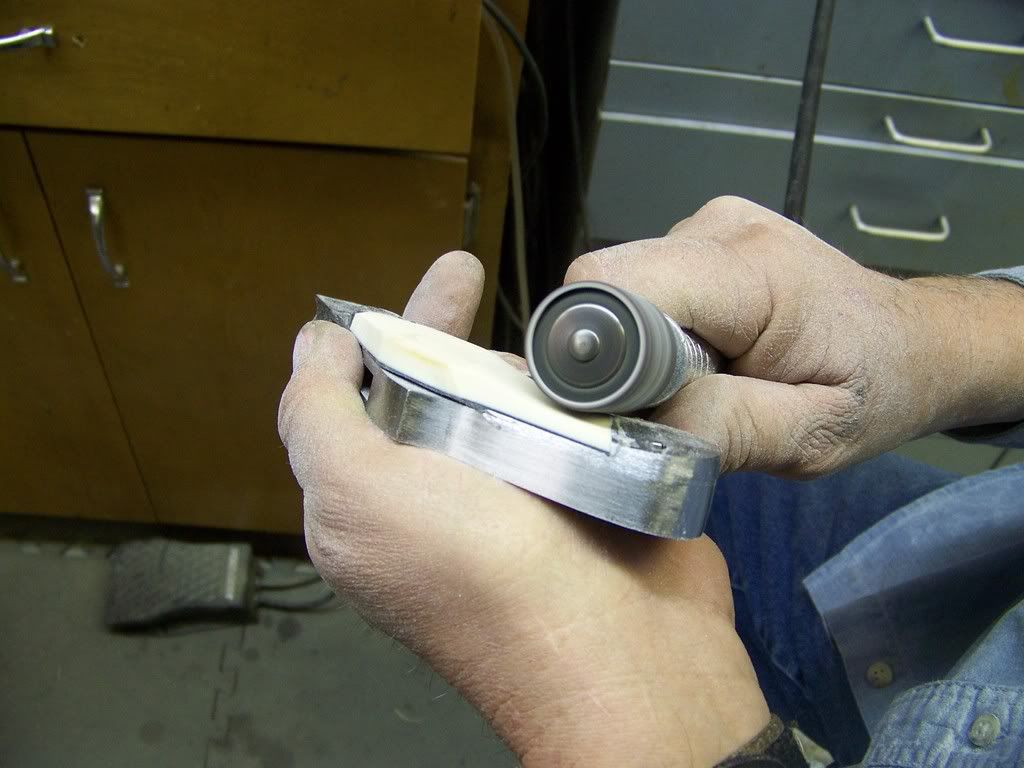

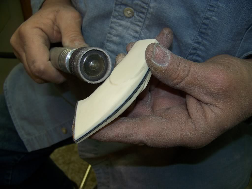

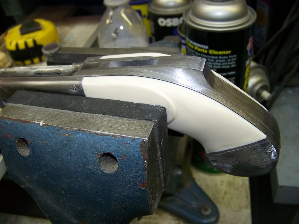

Here I am contouring the ivory scales with a Foredom and 1" sanding drum.

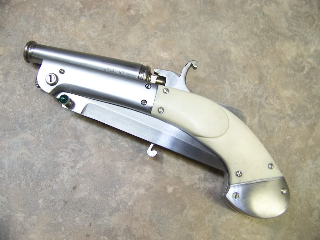

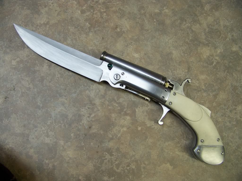

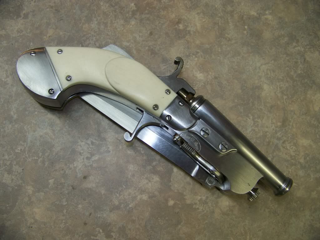

OK more progress, in fact its going out for a few weeks for the engraving in the morning.

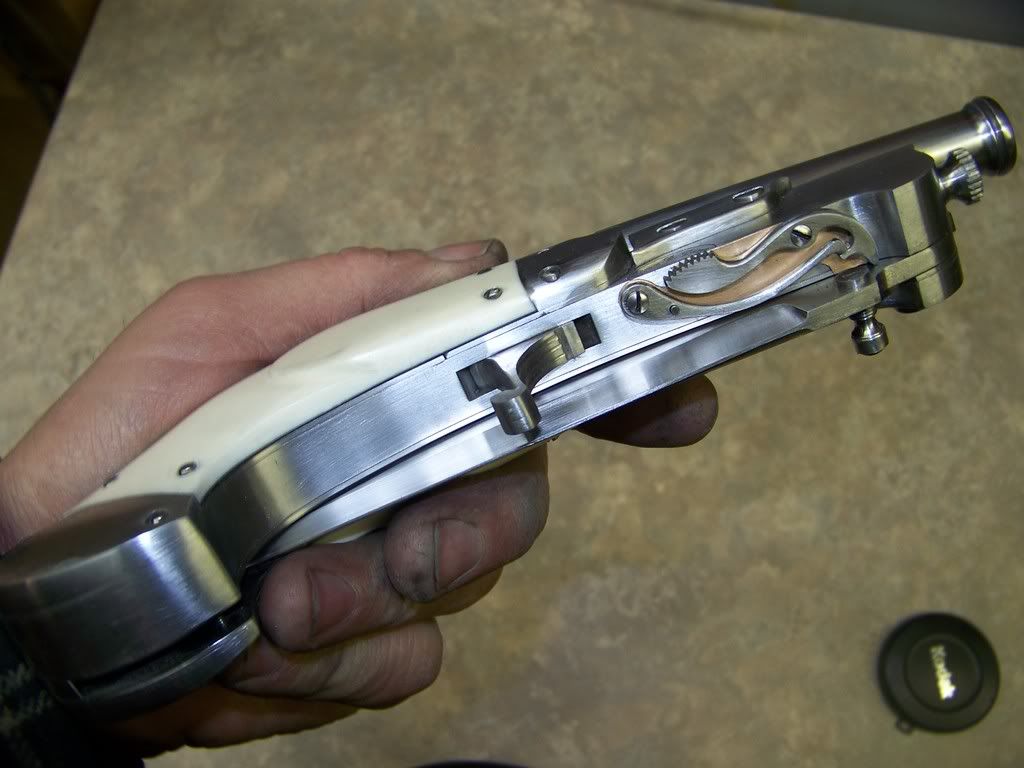

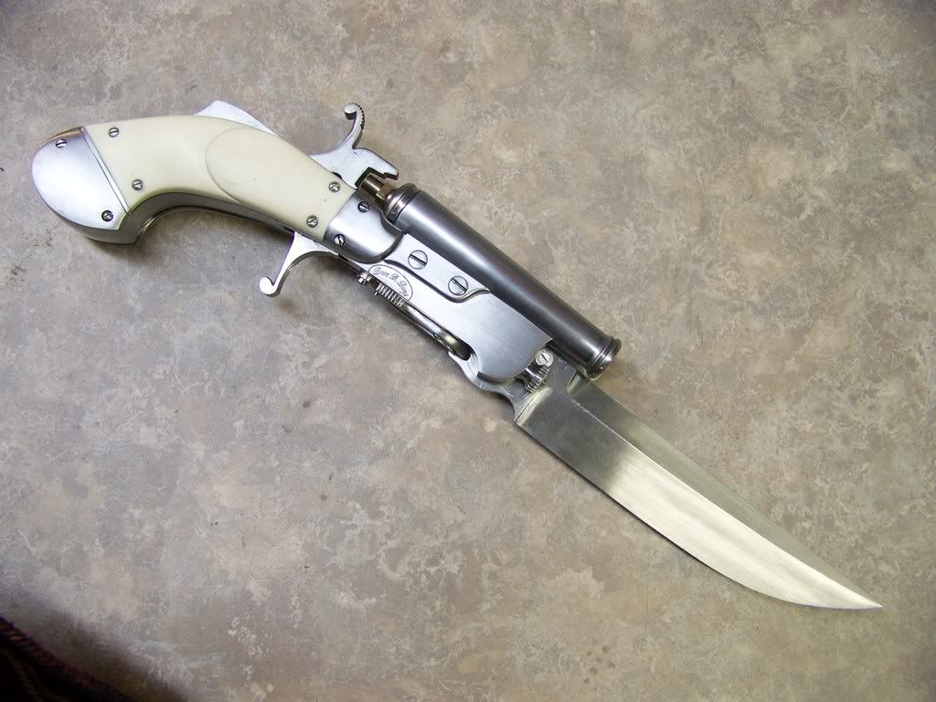

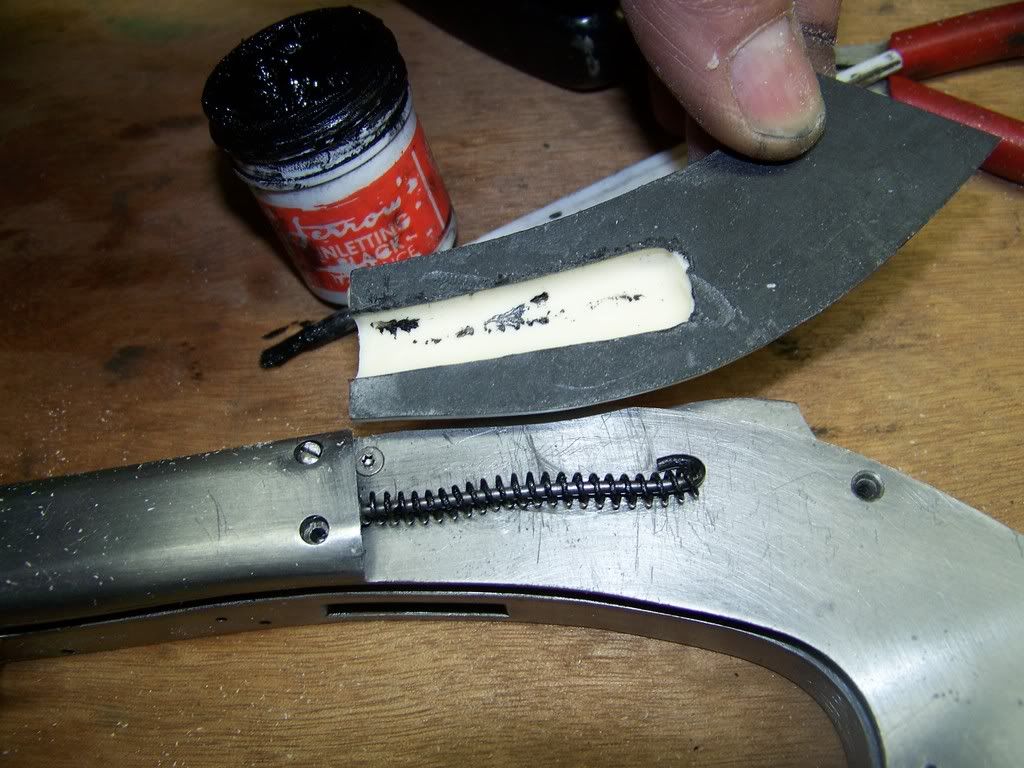

The blade is assisted by a 3" long coild spring under the left bolster and ivory scale. I used "inletting black" to show me where all the high spots are so I could remove material from both the bolster and scale to give it and the rod some space for traveling.
I also finally got around to proofing the barrel. I know I know why didnt I do it before now? Because I knew it would pass the test, thats why. I used 138 grain lead ball with 24 grains of pyrodex powder and touched her off 3 times. The ususal load is 16 grains but I adjusted (by grinding off the spout) the powder measure down to 14 grain for a sweet shooter.
I spent all day sanding things down and matching scales and bolsters. Its down to 600 grit and ready to send to Tom Ferry. I cant wait to see what he does with it.
