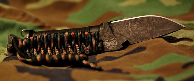

Is there ever a problem with rust on a forced patina blade? I want to try this but if it will jeopardize the "rust prevention" characteristics of the initial coating, I don't think I will. Also, how durable is this patina? Will it get roughed up with use or is it fairly durable?
The coating is more protective for the blade, but a patina does an adequete job especially wgen oiled occasionally, or ren wax used. Ive been using the ren wax on some and oil on others and the renwax protects for longer. The patina will wear off with hard use but can easily be re applied, or if bored with the patern you can just change it up. Or just use it and let the patina change itself with use over time.

Damn man, those patinas look AMAZING. I've been looking for ways that I want to patina my blade with, and your method has won my heart. thank you
Holy shiite! :eek: That is AWESOME!
THAT is what i'm gonna do to my H•E•S•T, too. That MAKES the knife.
That is just friggin' awesome!
