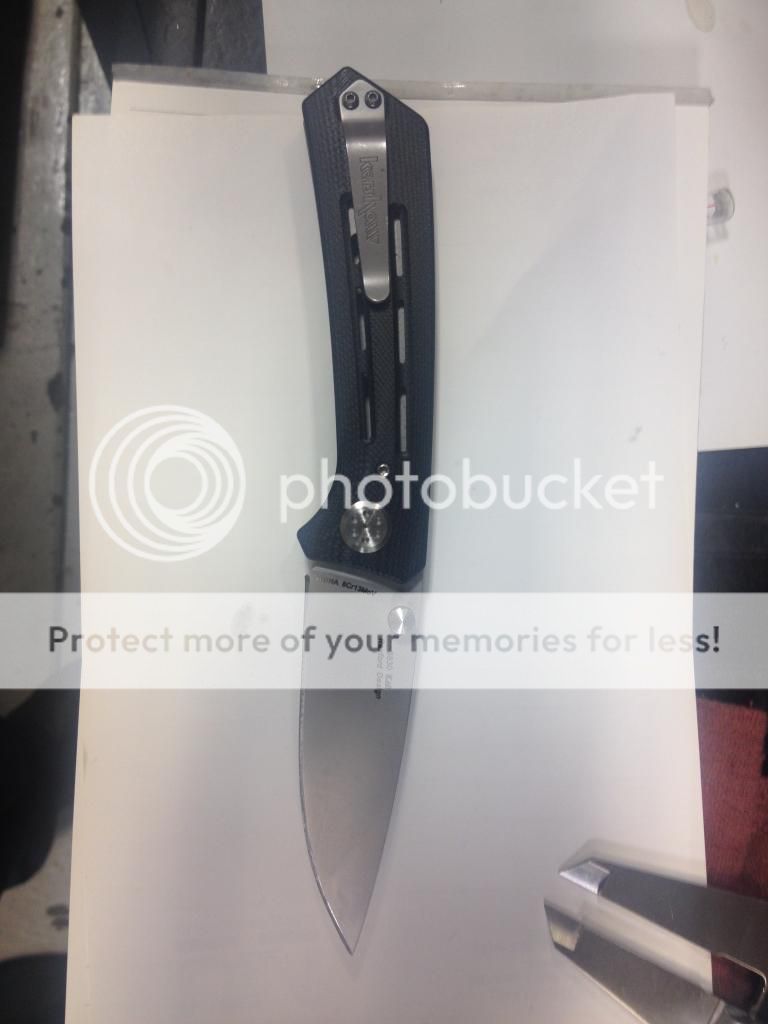

My work edc for the past two months.
Holds a serviceable edge for a decent amount of time and a quick strop maintains it.
Of course, I would love this knife in any steel, but 8cr is fine with me. I do find it interesting that it is starting to develop a patina of sorts but then again it gets exposed to different chemicals and stuff.
