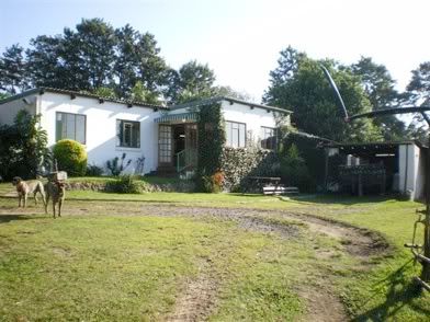

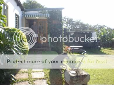

Burger knives are located +- 2 hours drive South of Durban, in Munster on a Banana Plantation KwaZulu-Natal in South Africa. Their workshop is a former house that was build on their plantation (Co-ordinates in Google earth are: 30°59'18.67"S 30°15'3.47"E I think? It is somewhere in that area). When reaching the Burger workshop you are greeted by the following sight:
Greeted by Mr. Fred Burger the founder of Burger Canes and Burger Knives. This is their outside shop where you can also purchase the knives in showcased in their display area.

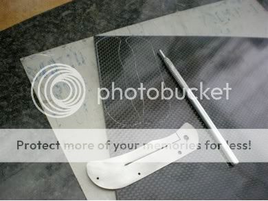

Scribing the various components for the knife. This EXK has full carbon-fibre scales

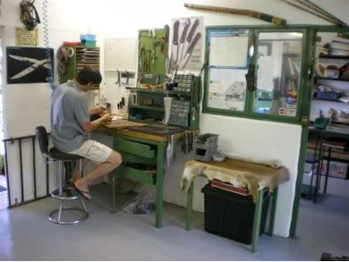

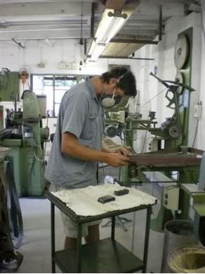

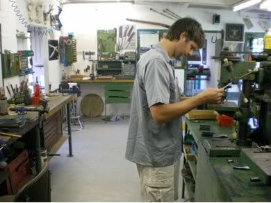

Trevor Burger at work on the knife.
Maker at work

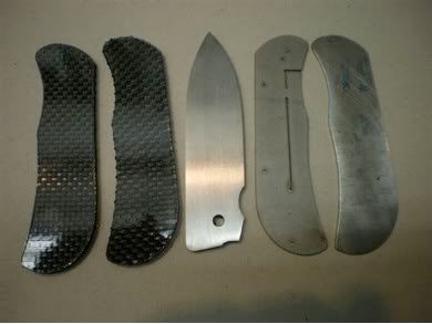

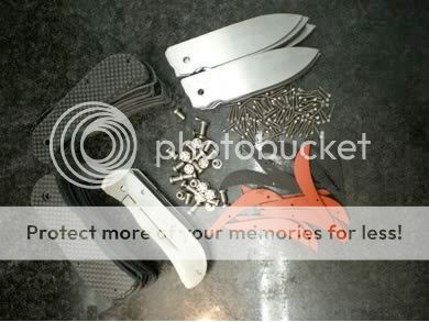

Various EXK components. (The red piece in the picture can be seen in one of my later photos where I show the backspacer).

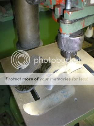

Drilling

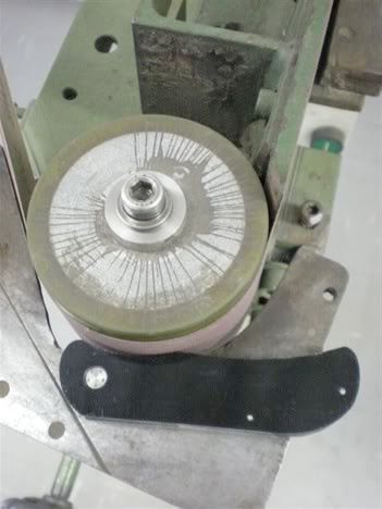

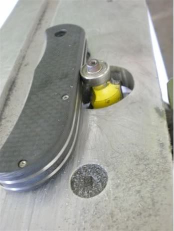

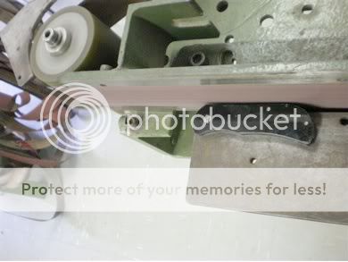

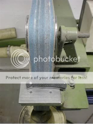

Profiling periphery.

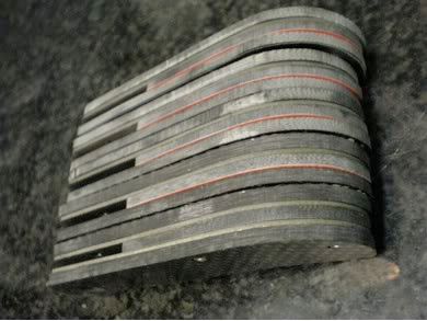

Some more carbon goodness!

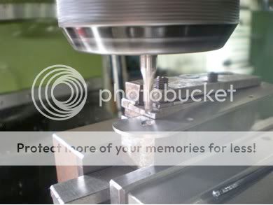

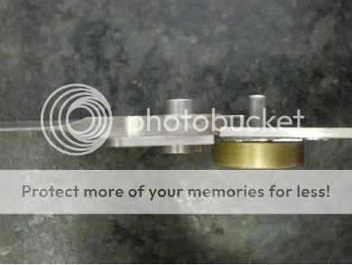

Milling spring lock face

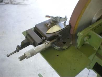

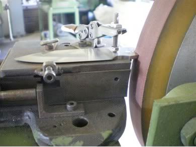

Final lock sitting, grinding blade lock face
Checking blade attitude and lock

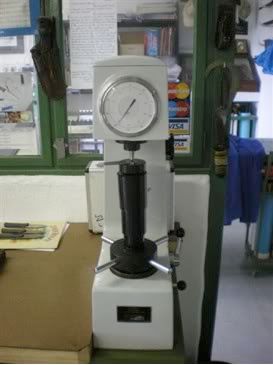

The picture is the Rockwell hardness machine that Trevor uses to test the blades with.

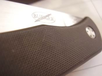

First a look at the G-10 on the handle.
Nice and grippy!

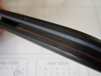

The red line in between the backspacer and the liner is the red piece in the photo of the various EXK components

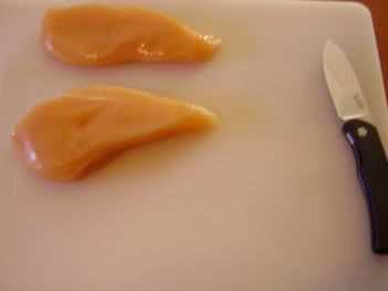

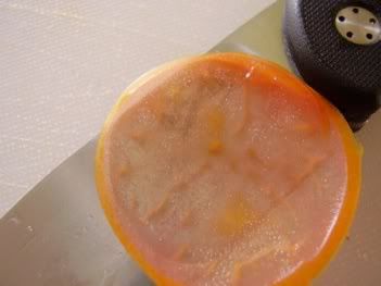

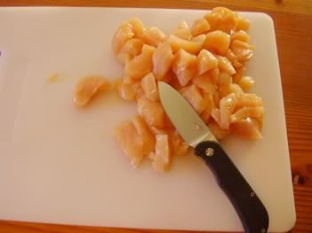

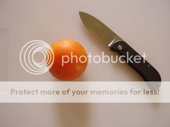

First task was to make some lunch. Tomato, chicken and mayo sandwich. This was obviously an easy task for a knife with such great slicing ability.

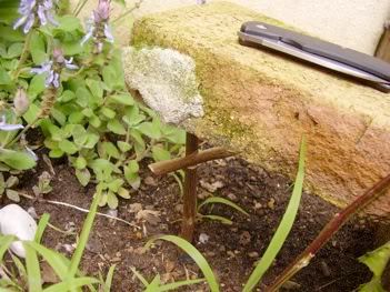

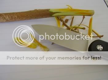

Next up was to practice my figure 4 trap making. (I am still learning this one as I usually use another trigger system)

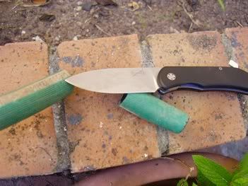

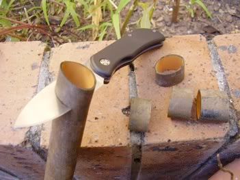

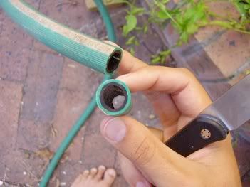

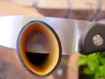

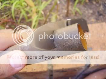

Next up I got some irrigation pipe lying around and some hosepipe that I found very easy to cut with the EXK due to its nice profile.

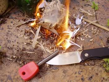

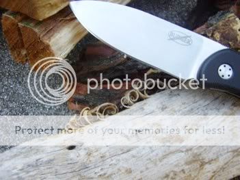

Next up was time to do some fire practicing. The blade gives off a nice spark for me and I like that the spine of the blade near the pivot is square and forms a nice 90* edge to use as a striker on the flint and near the tip the spine starts to be rounded like on a Sebenza.

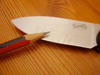

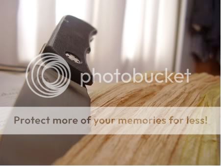

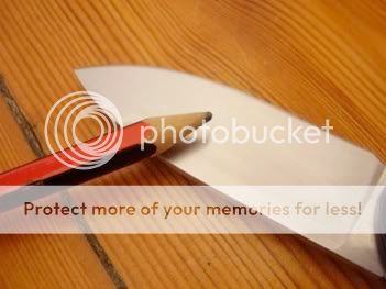

Next up was to sharpen my pencils:

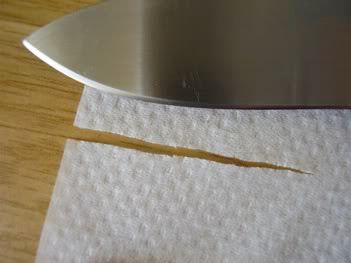

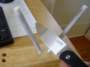

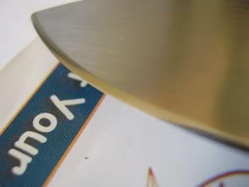

After all of this I finally decided to touch up the edge a bit. I use my Lansky crock stick (TurnBox kit) to maintain my edges. About twenty strokes on the fine rods and it could cleanly cut toilet paper and with some leather stropping got a nice keen edge

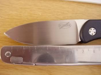

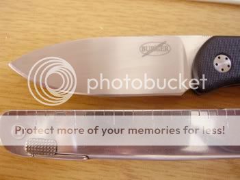

The following photos are to show the blade length in inches and millimetres. These photos are a bit off centre as I could not find my ruler.

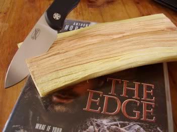

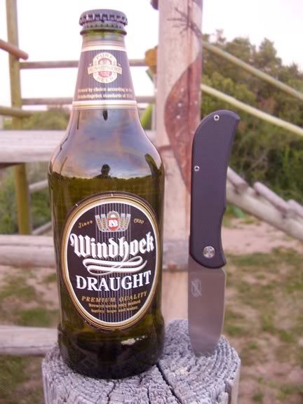

And after a long day what better way to relax with a great movie?

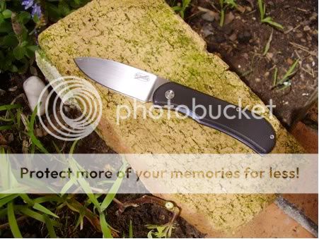

Conclusion.
This is a great knife for EDC and camping purposes. I am extremely happy with the fit and finish of the knife and it has proven itself to be a fantastic companion. I recommend this knife to anyone that want a good quality working knife that appreciate the fact that it is made by hand and it is something you can be proud to own.

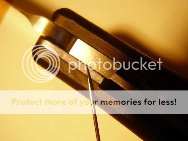

Are you at all concerned about cleaning the knife? If junk gets collected in the pivot or between the liners, do you need to send it back to Trevor to get it cleaned?
Wow, thanks for the photos and impressions. I especially liked the tour of the workshop. Very cool.
I have used the knife for dressing dear and around water, only maintenance I have done is just wash it with dishwashing liquid and a sponge and then apply some machine oil, or lansky hone oil, what ever I have with me.

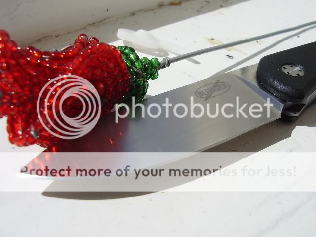

There was one time sand got lodged badly into the liner area, I just loosened the back screws and took a business card and went in between the liner and the g10 scale. Got rid of the sand and was perfect again, I have not had anything gotten into the pivot. Here is a picture of the smallest needle I have in the Little navy sewing kit to show how close the tolerance are:
