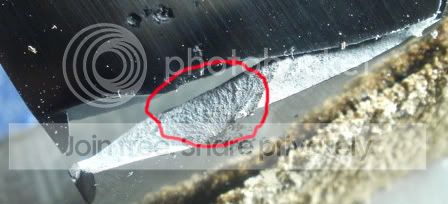

A rather blank stare I imagine. I had a feeling it would fail this part of the test..... just when was the question I had.
I was pretty confident in all other parts of the test.
I can tell you, there's technique involved with this test. Its a test of the blade and the user. I can obviously use some practice cutting hanging rope... my aim sucks. I could likely benefit from some chopping practice as well!!
My wife wonders if anything would have been different had I clamped the blade a bit closer to center-blade in the vice. I don't think so, but......??

Some thoughts...
First, what was your normalizing process. I couldnt' find it in the post.
Second, in this picture of drawing back the spine, you got it to blue. That might not be hot enough for 1084 since 425 degrees will produce blue/purple on polished 1084. The best guess is that you didn't draw it back nearly enough

I wonder what would happen to the blade, and where on it, if you clamped it again right above the break and gave it another flex/bend test? Would the results be consistent with the first break or different?
...picture of drawing back the spine, you got it to blue. That might not be hot enough for 1084 since 425 degrees will produce blue/purple on polished 1084. The best guess is that you didn't draw it back nearly enough.
Interestingly though, the edge, which was not drawn back, did not break. What does that show? The spine got harder? The edge was softer? Or more likely, the value of thin edge geometry? I still wonder what would happen, and where, if the remainder of the blade was flexed/bent again?

For the love of (place Deity here) sand the blade edge dull before doing a bend test !!!!!!!!!
Besides this, It is clear that the blade failed at the vise jaw, and that the break is from the spine. You normally clamp 1" of the blade in the vise, BTW.
I think the spine was overly hard for this type of test, but was right on for a real knife. Remember that the ABS test isn't for a knife that will be used. For an ABS test, draw the spine to soft pearlite.
The fact that the edge is better than the spine at bending may be the thinness, or that it is a consistant martensitic structure.

I think I will break it again(sanded dull first). My vice is to small for this so it will have to wait till I get to Glen's shop again, or possibly at the CBU Metallurgy Lab. I'm getting the blade hardness tested there as well, something I'm particularly interested to see the results of.
Overall, I am happy with the performance of the knife. It performed the tasks a knife should be able to perform. The big question I am left with is: Why did it crack on the spine and not on the edge... isn't that the reverse from what is expected?
In my ABS class at Old Washington, 3 of 9 blades failed the bend test, and they all fractured at the spine, just like yours.
Yours broke almost immediately -- maybe 30° bend?
We did triple spine tempers (in water). If you overheat a spot on the spine to get red (a hot spot), that'll leave a hard spot. I also did a 375°F temper for 2 hours before the spine temper (5160).
You really can't over-temper it in water, but it's important that the water level only come up about 1/4", because the water is a tremendous heat sink, and your spine temper will approach ~ half that distance.

I would have the blade tested right next to the break area and from edge to spine at 1/4" intervals. That should tell you a lot.

That fracture is exactly like I would expect, starting at the ridges of the harpoon tip. It looks like it started at some hammer/slag marks on the surface as well, though that doesnt necessarily mean anything unless you can see some slag or some other flaw hammered into the bottom of the mark. As long as the hard portion is thin enough, edges can be much harder than most people think. In a bend test, the location of maximum strain (stretch) will be at whatever location is furthest from the center line of the blade. The strain at the center line will be zero. The crack looks like it started at or near the ridge line of the harpoon tip, which would qualify it as the point furthest from the center line in the location of the fracture. You need a very ductile (soft) spine to get the crack to start near the edge and work toward the spine.
Very interesting results and sad to see the knife smashed.
This is very interesting.
The grain looks quite large in this area but not either side of it and it seems to have a radial pattern from the scale pitting. I wonder what happened there.
