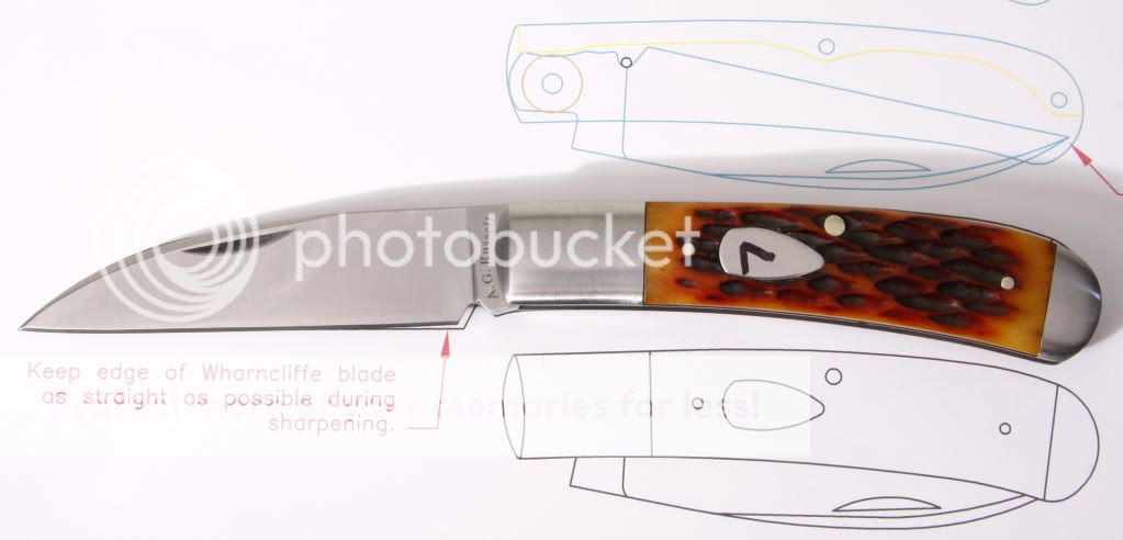

A.G. Russell Curved Regular Jack
I think the "50% thicker" Wharncliffe blade" is not a worry. Wharncliffe blades are usually secondaries on production knives so tend to be thinner in that situation. I think this is what AG is saying ??

I'd like to see a pic of knife closed. Maybe a sunk joint ? Don't know if it's feasible for this pattern, but a sunk joint would be very 'classy' (and save the pockets).
I think this will prove to be what some posters were asking for in the threads about the new BIG folders from AGR: same exacting tolerances and quality materials but in a smaller knife.
I also think AG is really onto something here. These might start showing up in quite a few different patterns and will quickly gain a piece of the folder 'market'. If you like knives, you can't help but be impressed with all the ones seen so far.
roland
Roland, I enjoy a well done sunk joint on an unobtrusive gentleman's knife. You will not see them in the designs i am doing now because I am focused on WIDE blades. This particular knife would ride spine down because the curve would fit the bottom of the pocket, with the sharp corner up away from the bottom of the pocket.

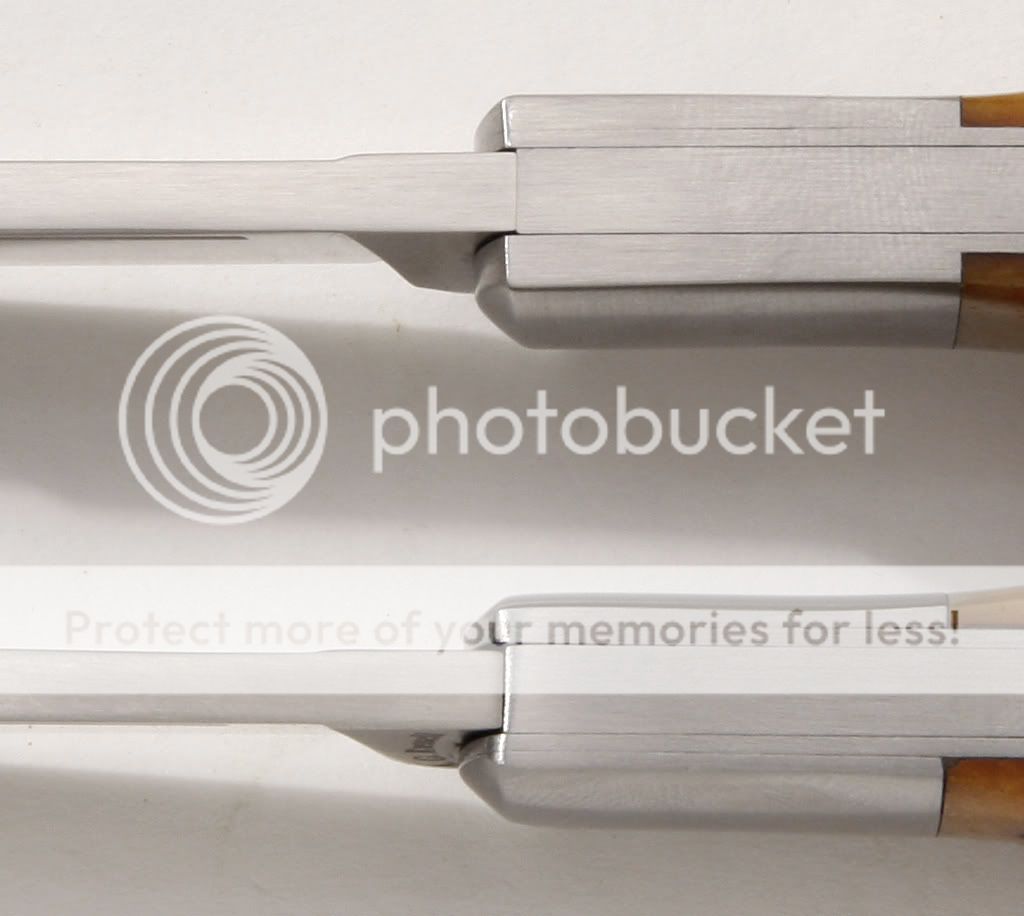

Unfortunately the entire first shipment of these knives has been rejected during our Quality Control Inspection!
This pattern was our first project with a new factory.
The samples were excellent; the production was not.
Here is an example of the discrepancies; the top knife was a sample, bottom knife production.
As you can see, definitely not AGR quality.

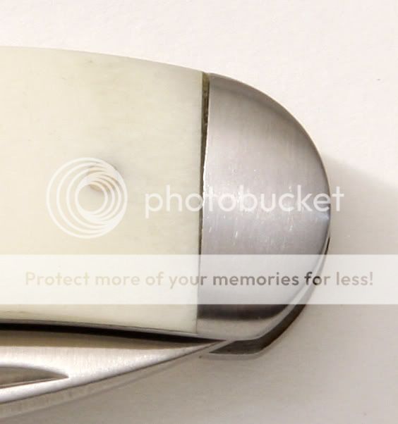

There were also too many other defects to discuss here:
We have advised the factory & we are anticipating a new shipment in several weeks.
I will personally be inspecting each and every one at that time.
Our apologies to those of you that have them on order.
