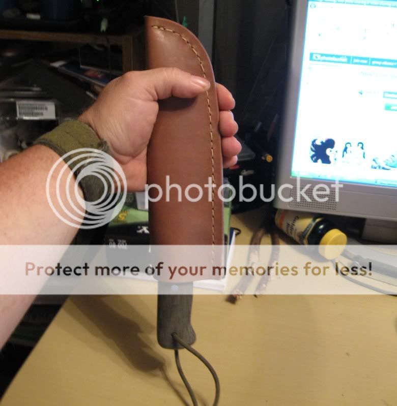

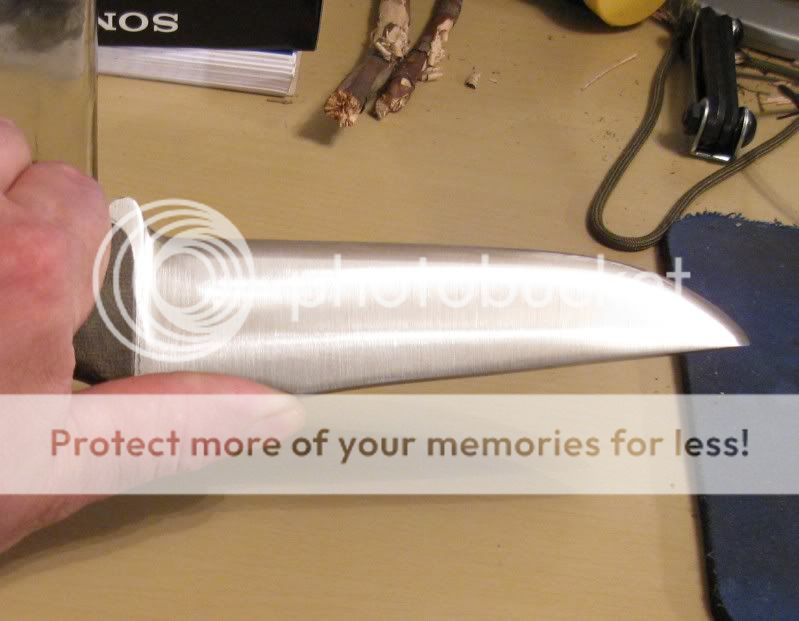

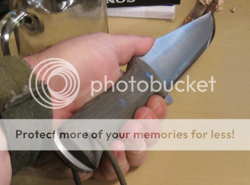

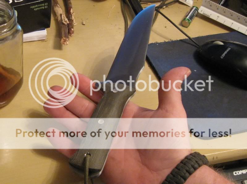

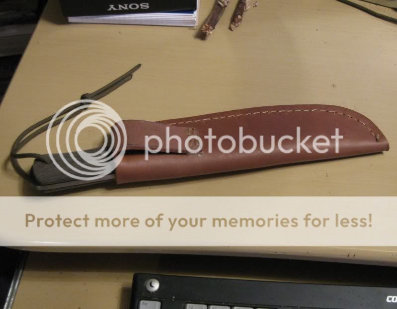

This is what it looked like out of the box….I wasn’t expecting it so I didn’t check my mail till late and it was after dark so I didn’t get to work with it any until today. Just cut a few pieces of paper in two length ways last night just to watch the other half fall away. It has a six inch long , 3/16 thick blade made of 01 steel, convex edge with no ricasso…cutting edge shaving sharp all the way to 1/8 away from the guard. It has a green canvas micarta handle, black liners, and a 3/16 tang extension, with an over-all length of 10 7/8 inches. The sheath is heavy weight leather, that rides very comfortably on my belt.

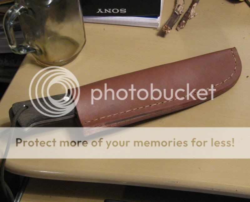

The sheathe is a nice tight fit.

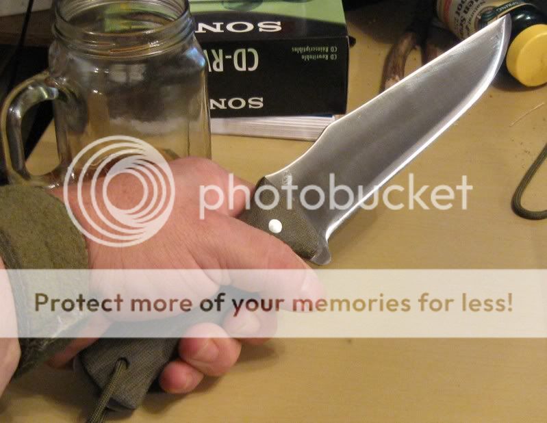

The knife looks and feels fantastic, it has a great grip, and a great balance centering on the first finger. The scallop in the spine is great during push cuts.

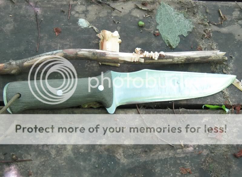

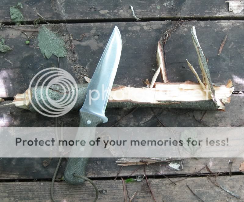

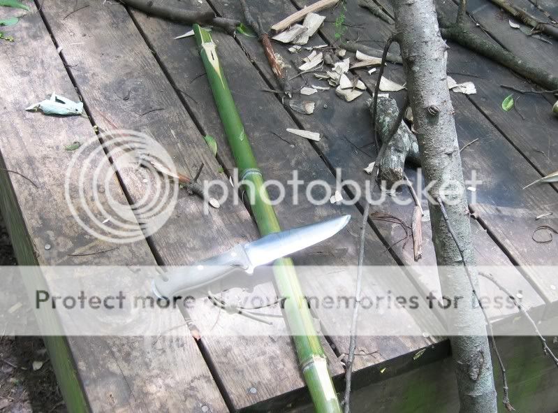

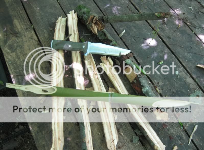

The first thing I did was grab a piece of Bamboo and a piece of Apple wood to see how the knife handled.

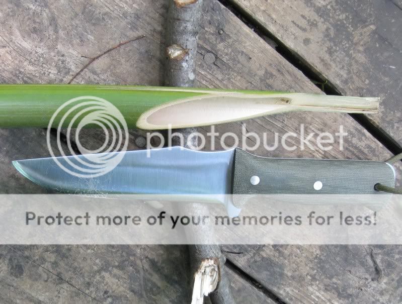

and just cleaning the limbs off the bamboo, and cutting it down some I knew I was going to like this knife!
This is one cut with a steep angle chopping cut while holding the bamboo out with my left and.

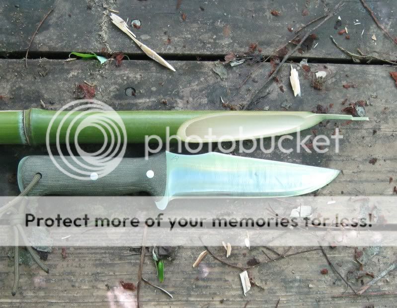

and this is done with one single push cut, I love the scalloped spine for this,

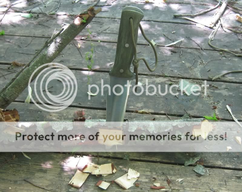

Chopping the Apple wood was easier than I expected for such a thick blade, this knife is scary sharp!
Then to see how strong the blade felt I made a couple of deep angle cuts and pried the wood away.
Then I batoned the three sections I’d chopped and the blade cut right through with barely any resistance at all.
Speaking of batoning I really like the tang extension, it really works great for batoning the tip into wood for notching,

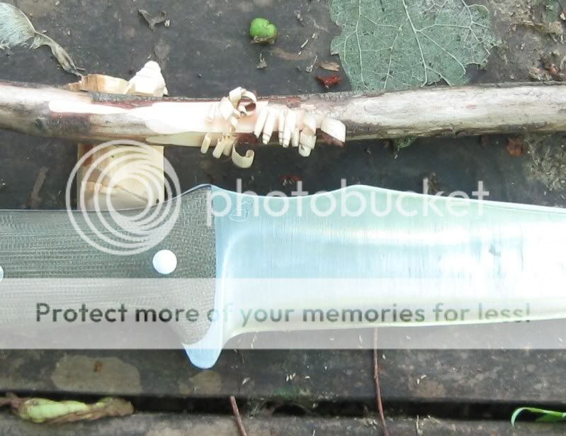

Next, after I had it warmed up a little I tried the edge at making some fuzzies. The edge, still felt as sharp as it was before I started and made some nice tight thin curls.

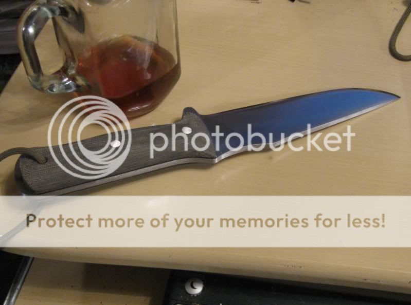

So…after today’s bit of fun with it….
It still shaves hair very easily. And I was right when I thought looking at the drawing that I’d love this knife…I think it is absolutely awesome. Fantastic job Bryan, very well done, thank you!

Thanks Alex, we really like it. We designed it to be a woods knife that would definitely work in a fight, but If you happen get one with the intentions of CQC you might want to have him put a choil or at least a flat spot in front of the guard, I'm used to combat type knives and hooked my index finger around the guard ONCE (like you might during extrication of the knife from a body if hung in bone or cartilage)...feeling the edge slicing through the first layer of skin from just barely touching the edge I learned very quickly not to do that again.

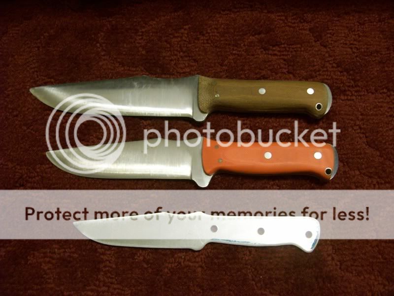

Here are the three sizes currently in the works. He made the orange handled six inch first, then he made the seven while he was making mine, and then we both decided we wanted smaller ones as well for more bushcrafty type stuff and to carry around in places a large knife really doesn't go so well with.
