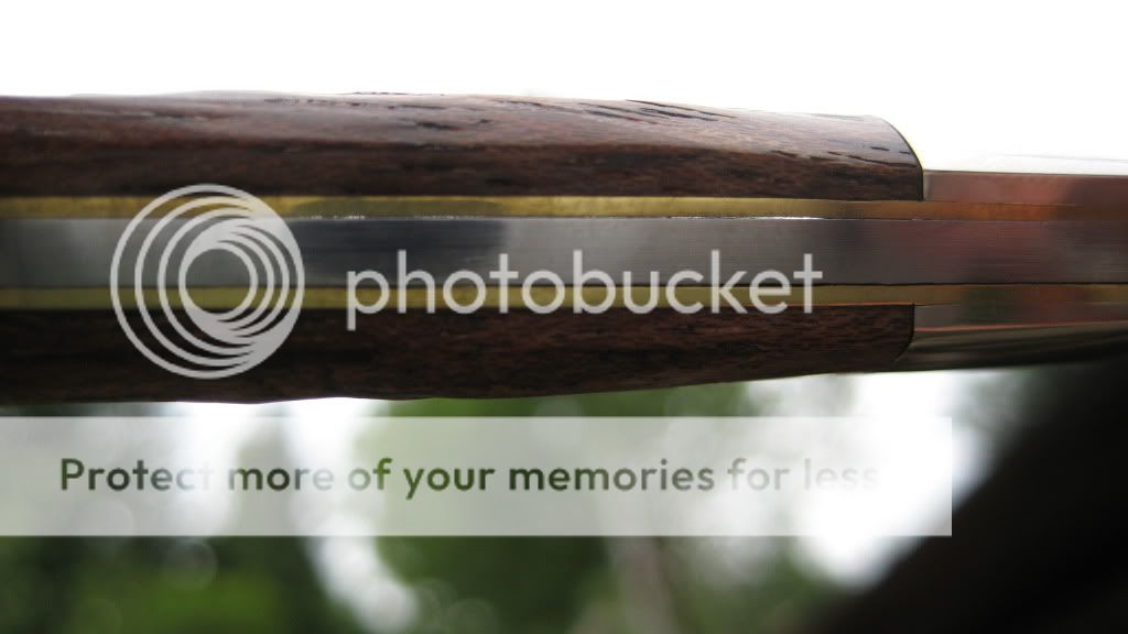

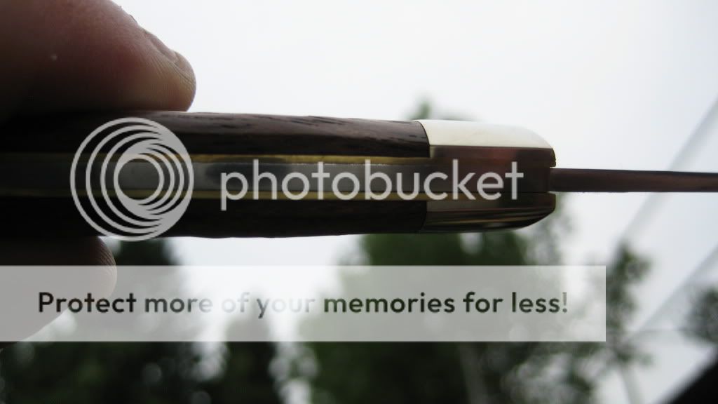

Yesterday I realized that there´s some blade play at that knife. Holding it against daylight, a little gap was at the liners. The sun shine through. But today there was a large gap between pivot pin and middle pin (I hope you know what I mean). The blade play got worse. No it wobbles like a cow-tail (as we say here in Germany).
Here´s a pic - daylight through the liner and the backspring.
It has the same gap on the other liner, but I couldn´t catch it with my camera.
Do you guys know, what to do? Can I fix it up my self or should I send it back. After only days of using it in normal EDC tasks the gap got bigger and the blade play was worse than the day before.

I would be willing to bet its from the wood in a way. The only 73 I have had issues with like this is my bloodred 73. Sometimes the bone warps so much from moisture and temp changes that it bends the entire frame/liners to the point the blade is off center and hitting one of the liners. I don't know a lot about the type of wood on your knife but I have a feeling it could be warping the liners.
As for the blade play, as long as there is room at the pivot to compress the bolsters/liners tighter to the backspring and tang of the knife then you can fix it. If the tang is simply too thin you may not. The first step to try would be squeesing it in a vice. You can wrap the bolsters in leather or use slabs of micarta etc to keep the teeth from digging into the bolsters. If you can compress it back snug with no blade play then you NEED to peen the pin to keep it from looseing right back up. If you have an anvil and small metal working hammers you will be able to easily do this. If you put a small amount of tape on the anvil it will take less skill to keep from scratching the bolster on it. With a good eye and control you should be able to peen the pin very smooth and tight without damaging the bolster. If you get any light scratches just do a satin finish at 320 and follow it up with a buffer and it will bring it right back to a mirror finish. Nickel silver is really easy to work.

if you have calipers measure the spring when it is position up above the handle, then measure the tang of the blade. If the blade is more than about .001" thinner than the spring you may not be able to remove all of the play.
I have tightened up a few slipjoint knives, and a Buck 110. As stated, you will need an anvil that is harder than wood. It needs to be at least as hard as the pin material, at least in my experience. If you have a vice you can make an make shift anvil by putting a spare hammer into a vice, and then using that hammer's face as your anvil. Alternately, you can use the poll end of an axe or maul, or really any scrap piece of smooth steel you have handy. If you don't have a vise, well, if you have a hatchet or axe you can sink it into a chunk of wood to hold it still, then use it just as described previously.

I just looked at the knife very well. The blade is exactely as broad as the spring. So maybe the wobbling should be able to get fixed.
When I held the knife against the light - I could see pivot pin, even pretty good. :(
The thing with the axe in a block and use it as a anvil is very good! Thank you. I have several axes, hatchets and whatever. When I understand you guys the correct way. Cleaning the knife very well. Using the anvil (axe in a block) and a little hammer are the right tools. Wraping around the bolster an old leather belt to protect the knife. Use the hammer very lightly. So that the pivot pin will get closer into the whole knife.
