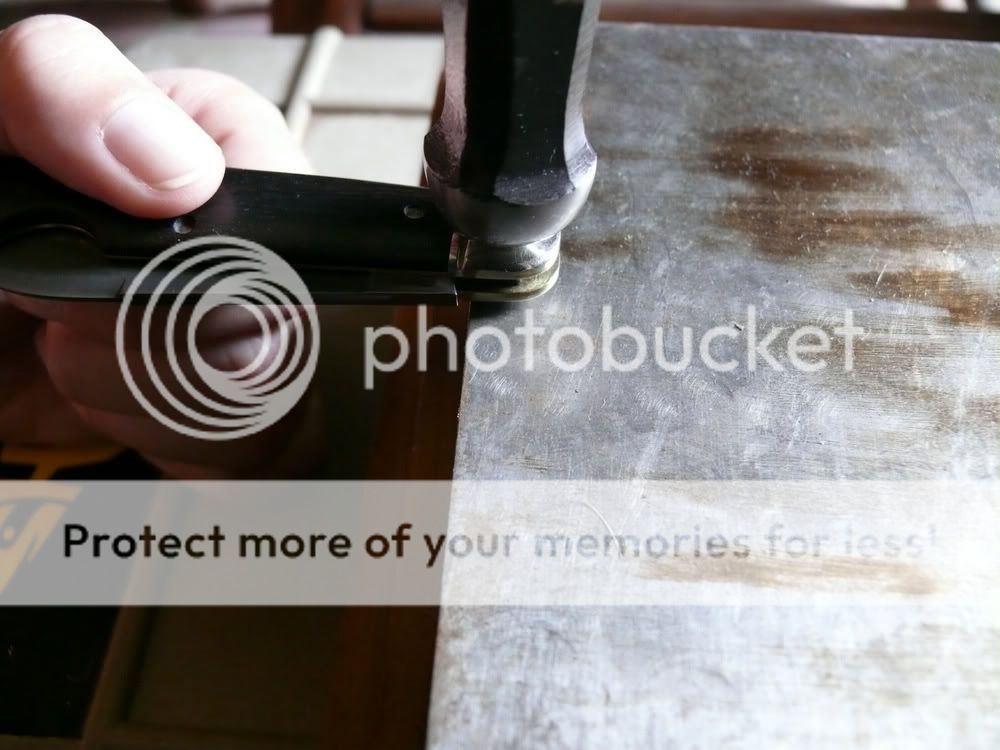

its a hot day again so I figured I would take a moment to do a few pics.

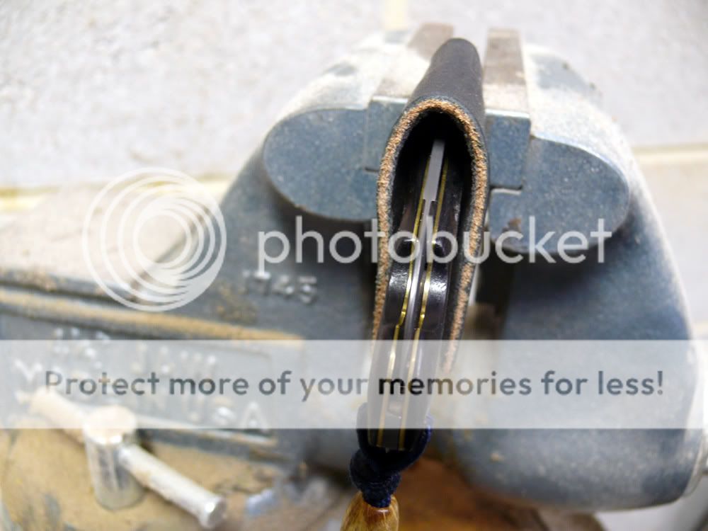

Here is what I mean by squeezing in a vice:

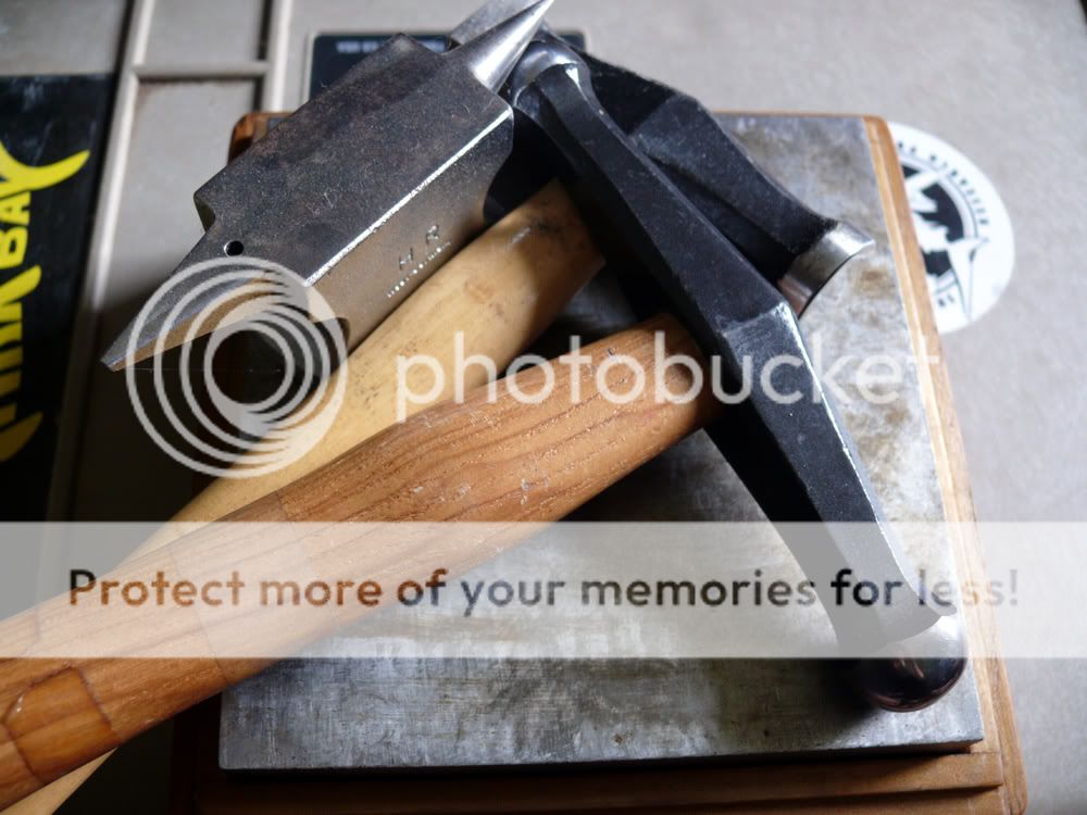

Next are the tools I used (minus the mini anvil)
I threw in the mini anvi just for fun :-p
Next I asked my girlfriend to hold the knife and hammer how I peened the pin. Just watching her do this and scratching the bolsters and ebony all up I can see why people would be hesitant to do this. I would NEVER ask her to actually try to hit JUST the pin with that hammer. Good bye bolsters and ebony...
Anyhow, you probably have lots of dexterity and control from all of your years working with your hands so I trust you can do this perfectly.

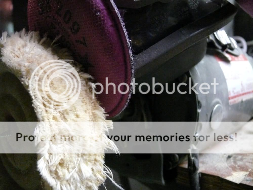

Finally if you do gain any light scratches just sand them off lightly or buff them out. This wheel is new and I have been using it for the last step on wood carvings..but you get the point..
You can do it Andi, but I don't see how you could peen it with leather between the hammer and the pin.
Best regards.

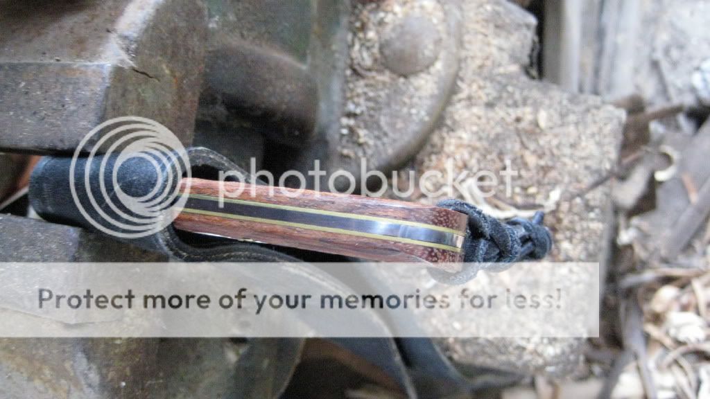

Well... I did what you told me to do, my friend!
The old (pre WWI) vice from my greatgranddad did the squeezing job very well and easily...
After squeezing the pivot pin appeared at one side of the bolsters/pivot

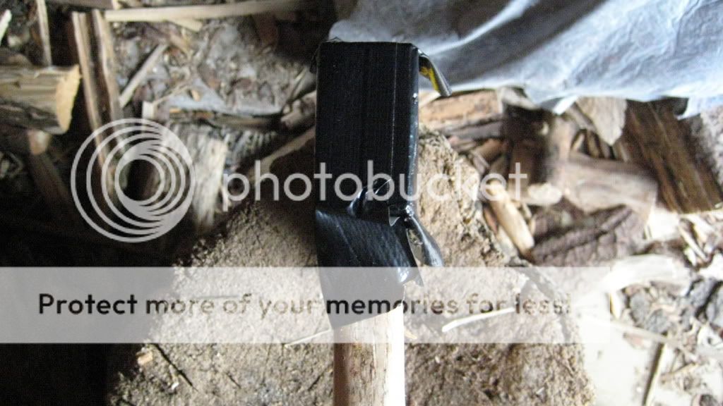

And the "anvil" ... I put some black structure tape around the back of its head, because there were some breakouts and deep scratches...

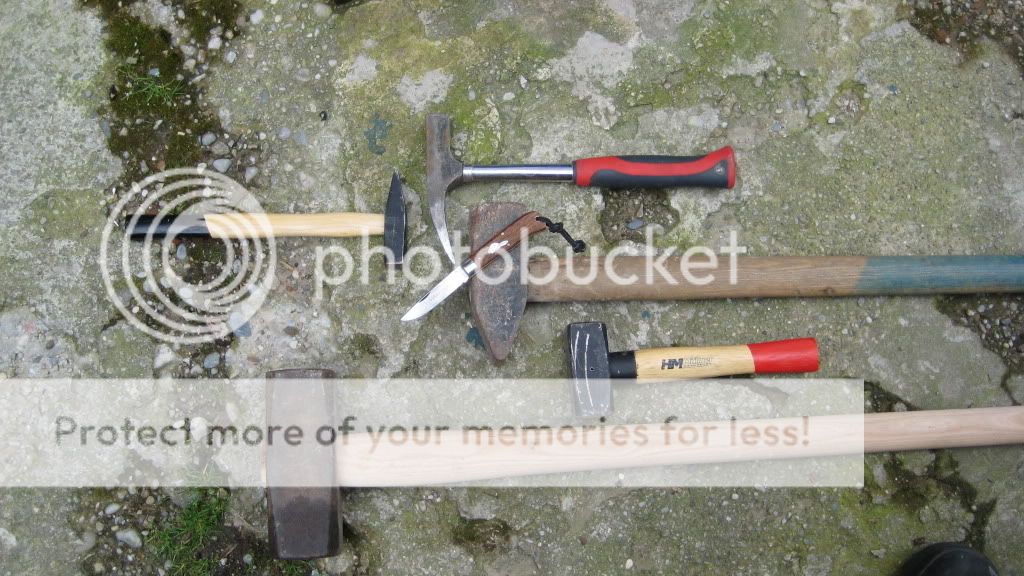

That was the most difficult thing at the whole repair session ... WHICH HAMMER TO CHOOSE?!! :p (I hope the small #73 is to see on that pic)

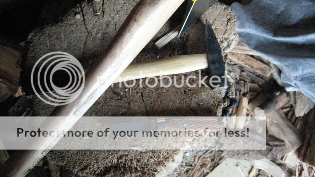

The tools for the last workout on the #7
After using the smalles hammer I had, I used it several times on one side of the pivot (that which stood out of the knife)
I didn´t do much polishing work on it, yet. That´s a job for another day.

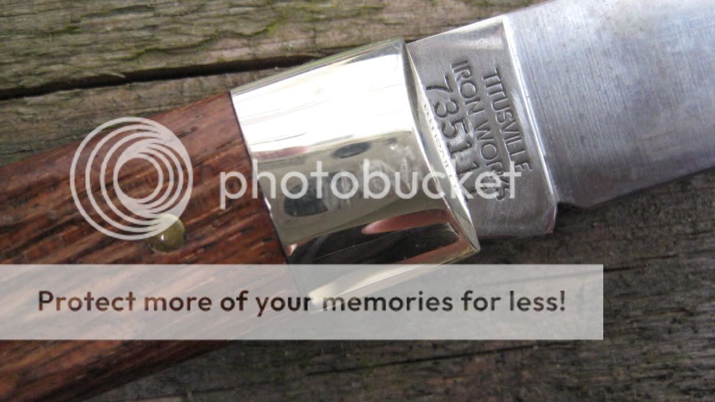

Here´s the result.... Problem solved :) :D
Well... the whole work was done within about 10 minutes. The result - now there´s no gap or blade play. And it was great fun doing it. But I would be happier is there wouldn´t have been any gaps or blade play on that knife. I hope, it was the first and the last time doing it on a pocketknife. Maybe my #73 was a lemon. But that´s not really the problem. I can do it again, if it will appear again.

Awesome Andi!! Those scratches will take nothing to get out. I'm glad it worked out for you.
As for the multiblade, I don't know. I would assume it would work but I haven't done it. On my Buck 703 it was the single blade end that was loose and it worked great.
I don't want to guess and have It screw up on you :)

When I did it I used the ball hammer first to get the pin hammered into the bolster nice and tight. Then I used that flat hammer in the pic that's mirror polished smooth to gently shape the pin nice and flat and smoot to the bolsters. I think if you pick up a couple metal working hammers it will make the future attempts even more refined and less chance of needing any polishing.
Either way, I'm impressed and congratulate you for such finess with the tools you have available.

@ Kevin: Well, you´re right, two little metal hammers would be a use addition. Maybe I can find one with a round end at one side and a flat side on the other. (Another reason to haunt the hardware store) ;) Thanks for compliments!

For using to much power/strength while using the vice was the thing that frightened me most. So I decided to use a pretty thick leather belt. For absorbing too much power on the bolster, in case I would have pulled the vice too strong together.
