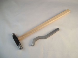

I'm thinking of picking a ball pein hammer and a small vice just for this kind of job, and have some questions ...
What hammer weight would be best, or is not that relevant ? (4 8 16 24oz) leaning towards the 8oz myself.
Would a small vise work ( let's say 2 inch opening) or i'll better find access to a big strong one ?

Bought a small clapping vice and an 1 oz pein hammer, some sandpaper, and fixed the blade play on my case medium stockman and queen canoe, hopefully for good. The only problem is that after all the squeezing and hammering, though light, the blades are harder to open, but i'm hoping they will break in after some use.

Which hammer did you get? This seems to be the key (for me), not scratching the bolsters very hard. I don´t have small hammers, which would be right for that work. But I think, that would make a nice addition.

i've used a small 1 oz pein hammer, i think is pretty common in jewellery making. It's similar to this one right here :
I did scratch the bolsters a bit, but the sandpaper took care of that. I guess it's very easy to make them mirror polished too.
