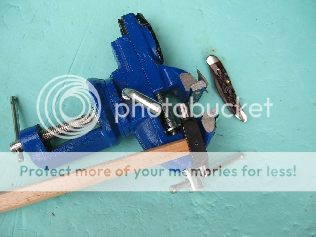

Andi, those were the tools used, and a leather belt.

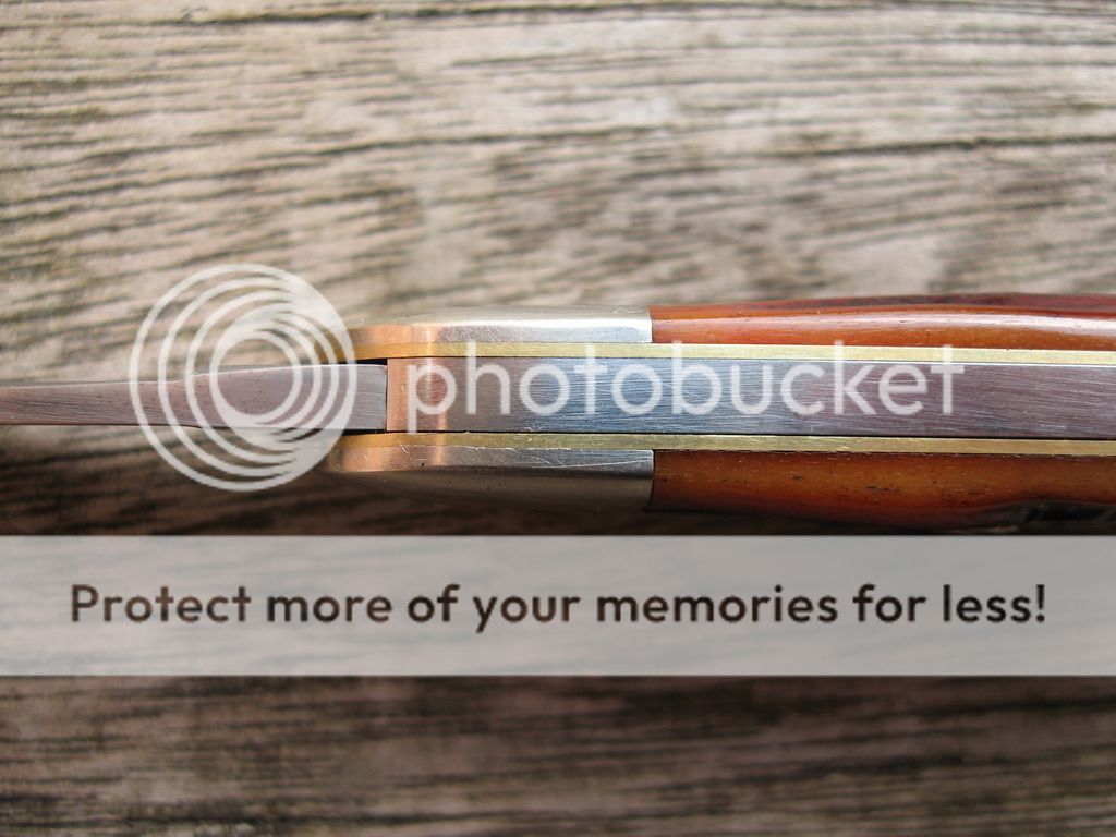

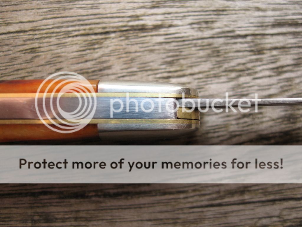

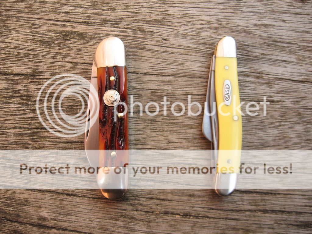

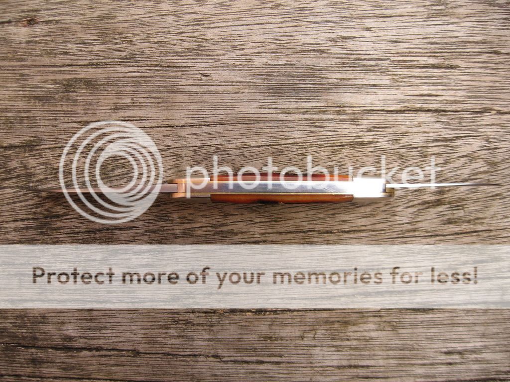

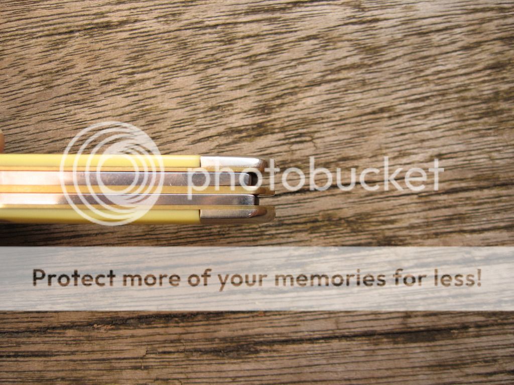

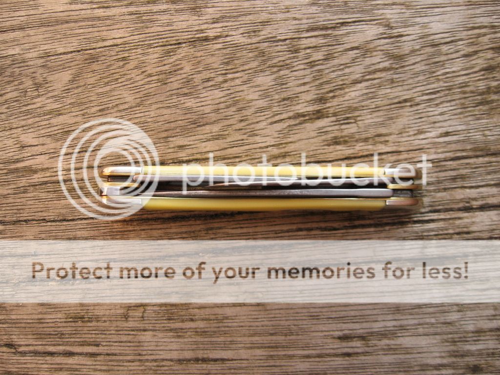

Ok, so here are the results.

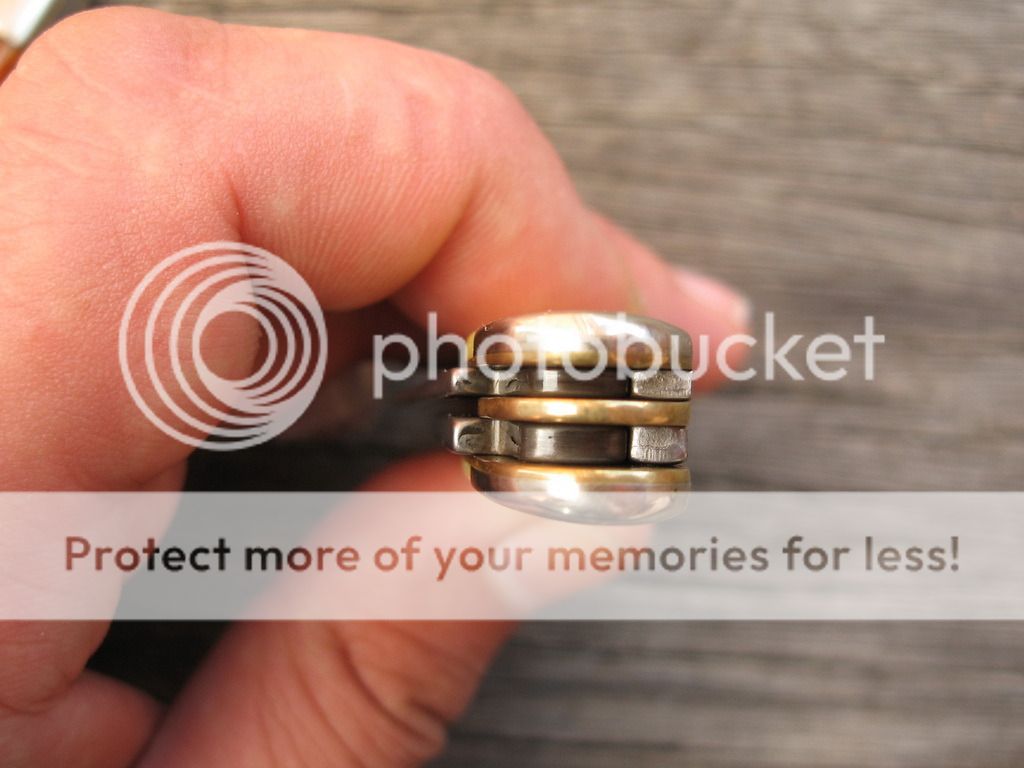

The stockman had some gaps and a little blade play, well, not anymore, and now it's smooth and feels very strong.
The canoe main blade is not binding anymore when closing, but it's rubbing a little the small blade, which is touching the liner a bit. Not perfect, i know, but the blade play is gone in both blades, and the huge gaps also disappeared.
Stockman
Canoe
Both

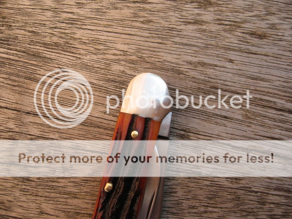

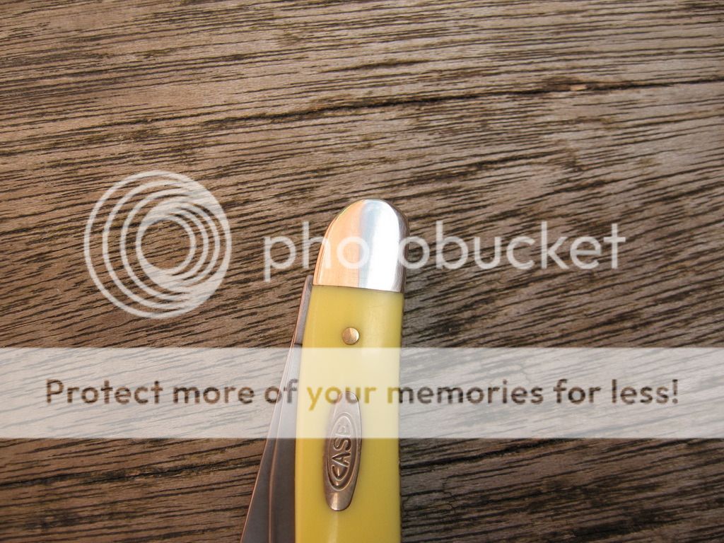

I like it, how you polished the bolsters. They seem to be mirrorpolished. Did you use a fine steelwool for the finishing or something else? I tried that once on a nickelsilver bolster and there were ugly scratches within. Bot very beautiful...
I haven´t it done with my #73. But I doesn´t matter to me. A working horse is a working horse. I have to do it, when I have more time.
Kind regards
Andi
Just some sandpaper, 600 grit i think, and some white abrasive paste (more like a block than a paste) on a cloth. I've put some scrapings of the before mentioned abrasive block on a cloth, put the cloth on a bench, and rubbed the bolsters on it. It took about 20 minutes for both knives. They are not mirror finished though, but good enough for me.
