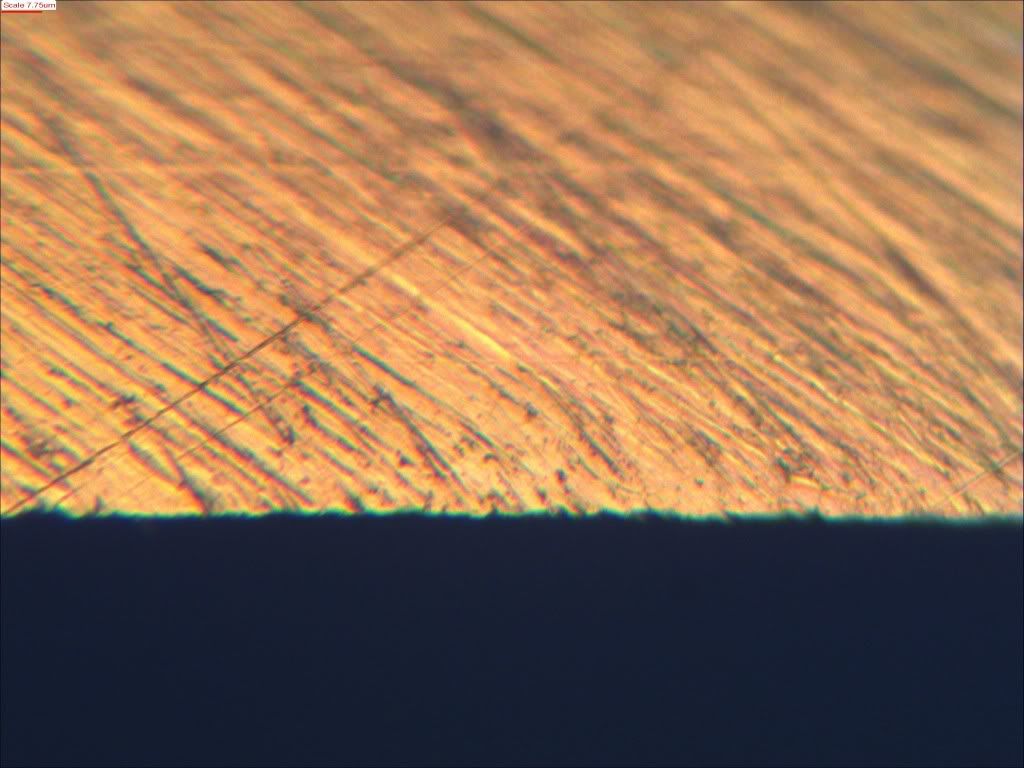

Here's the update to the update. Redid the Aus8, Carbon steel, and Sandvic on the edge of my newer Pyrex (not borosilicate, but soda-lime glass).
I thought this would be very interesting as I can see how it went to work on these edges and I still have pics from their last test.
Here's the Aus8 - not a lot of visual difference - you can see where the steel appears to be piled up a bit as it comes off the worked apex and back down to the stone-ground region. A further improvement in fine cutting - this knife and the others I did this too could all whittle a hair with just a little draw along the edge - this knife in fact split the hair in half the instant it caught. Pretty good for two quick steps removed from a combination silicon carbide stone. Entirely possible the steeling step could be eliminated and then you're going straight to the glass from a fairly rough stone and splitting hairs....
Aus8_Glass_640.jpg~original

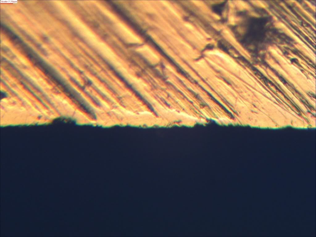

Here's the carbon steel edge - seems to have undergone an improvement in apex "cleanliness" - a bit less irregular and cuts a bit better as well. Evidence of the metal being worked is not as apparent - there are fewer irregularities to be smeared.
CS_Glass_640.jpg~original

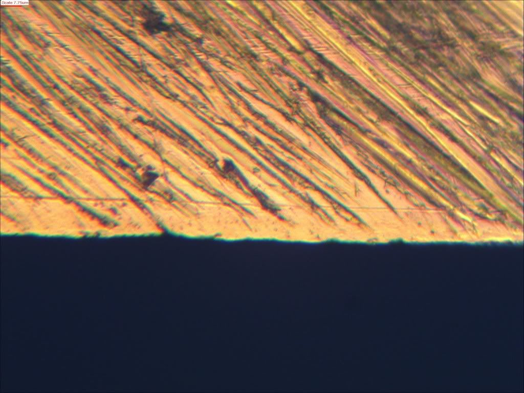

Now for the Sandvic. Much like the Aus8, not a lot of visual change, but an improvement in fine cutting based on hair splitting.
EKA_Glass_640.jpg~original

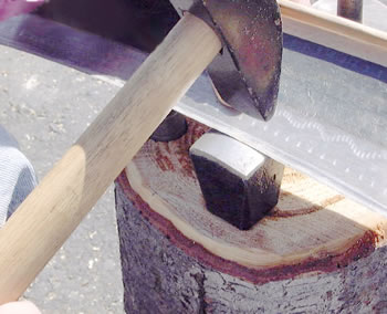

I also came across this when looking into some natural stones for scythe honing that another member posted about. I had no idea these tools were sharpened by peening and then a light job with a honing stone. With the right jig or hammer/anvil you could probably do a good job on a machete or other large chopper. I have no idea what the RC is on a scythe. There's always more out there to learn.
http://scythesupply.com/workshops/peeningWorkshop.htm
