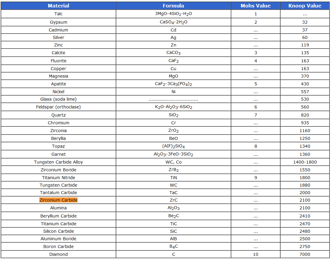

btw, I still do not agree that zirconium-carbide is second in hardness to diamond. Here is a chart that shows zirconium carbide has roughly the same hardness of aluminum oxide, which is much less hard than other materials such as boron-carbide and cubic-boron-nitride. The right most column is Knoop hardness, which is different, but very roughly similar to Vickers Hardness. From this chart, you can see that zirconium carbide has a Knoop hardness of about 2100, and boron-cabide has a Knoop hardness of 2700. And cubic-boron-nitride (not in this chart) is even harder, at around 64 percent the hardness of diamond (in the Knoop scale). This translates into a Knoop hardness of around 4500, which is more than twice the hardness of zirconium-carbide (in the Knoop scale). For details, see this article on CBN: http://www.gearsolutions.com/article/detail/5499/hard-choices-diamond-or-cbn
http://www.tedpella.com/company_html/hardness.htm
The chromium carbide wear-plates that I am talking about are not a thick chrome plating. They are actually sheets of chrome carbide used in industry where there is extremely high wear. In other words, it is not a thick layer of electro-plated chrome. Instead, it is a completely separate slab of chrome-carbide used as an ultra-wear-resistant shield.
http://www.cladtechnologies.com/Articles/CrCarbide/article.htm
http://www.mc3wearplate.com/
http://www.appliedalloys.com.au/composite-wear-plate.htm
Chromium carbide gauge blocks from Starrett-Weber can be found here, including mention of their extreme hardness and stability:

Where to start? I stand corrected on the relative hardness of ZrC. At least I was correct that ZrC is much harder than ZrO. Silicon carbide was developed in part to sharpen Tungsten carbide tools which come in at about 72 HRC (hardness Rockwell C scale). Titanium nitride has an HRC of 82, about the same as Vanadium carbide, which is why I like Vanadium in my steel blades. I apparently had the refractive index mixed up with the dispersion index on the cubic Zirconia. My memory is as good as it used to be, but it's not as long. The Washita guys, if I understood them correctly, said that the lower grit equivalent stones had a coarser grain structure, but the particles were the same size (just spread out). I don't know if I've convinced anybody to try a ceramic blade as a finishing steel. I have used these for years on Stellite, S90V, Cera Titan, and TiAlN coated (chisel sharpened) blades. The TiAlN coating, which is exposed on the micro edge, has an HRC of 92. I also use the sides of PVD coated blades (TDLC) as a finishing steel.

The hardness of SiC, TiN, etc. are plotted in the graph I already posted earlier in this thread, which is taken from http://www.gordonengland.co.uk/hardness/ehe.htm It is interesting to look at the numbers, as mentioned by yourself and me2. On the Vicker's scale there are, at first, many materials of a given hardness. But as the hardness increases, there are fewer and fewer, until suddenly there are almost no materials which are half the hardness of diamond (except CBN). I have also found this huge drop-off very interesting. It shows how exceptional diamond has been over millenia. It is only very recently that research into carbon nanotubes and other exotic allotropes of carbon, has found materials that fill the gap between CBN and diamond, and possibly go beyond diamond in hardness.
btw, I don't like the Rockwell C Hardness scale because it's "non-linear" in the following sense: an infinitely hard material would have a hardness of 100 HRC. In other words, no conventional material will ever have a Rockwell C Hardness above 100. If this does not seem weird to you it should: An HRC of 99 is very very hard, but still finitely strong in the engineering sense. But an HRC of 100 means infinitely hard, and in the engineering sense, infinitely strong. How did we go from finite to infinite when changing by only one point of HRC hardness? And if anything did go over 100 HRC, then the material would expand as you applied compressive forces. That would be exceptionally weird. Notice that in practice this is not an issue, because HRC is not used for materials harder than about 70 HRC because it becomes too difficult to measure accurately/consistently. At high hardness, the HRC micro-indenter pushes into the material such a short distance that it is hard to measure accurately and is easily affected by many secondary effects. (Note: In the above I'm slightly over-simplifying in that I'm ignoring the pre-load weight in HRC measurement, but even if you include the pre-loading weight, what I'm saying is still technically completely true.)
In contrast, an infinitely hard material would have an infinite Vicker's Hardness. The makes much more sense to me.
The reason Rockwell C Hardness is popular is that it is easy: HRC is computed directly from how deep the micro-indenter pushes in to the material. So, HRC is simply read off of something analogous to a dial-indicator or dial-depth-gauge. But Vickers hardness is more work to measure: typically one must use a microscope to optically measure the size of the pit made by the micro-indenter. This is too difficult to do efficiently for industrial mass-production. Although, now with advances in automated computer-vision, this may change.

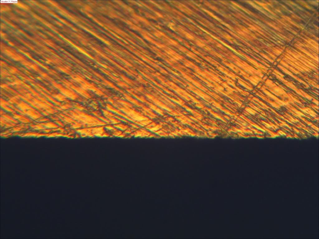

OK, here goes the last test for the foreseeable future.
Test knife is carbon steel from Jarvenpaa, I have no idea what grade. Had been sharpened using Murray Carter method, could shave facial stubble dry with just a bit of catch yet is still rather "toothy" - quite sharp and cuts very well despite having a Scandi grind at 27 degrees or so.
Using the now pretty smooth steel I gave it ten passes. Saw a very small burr and couldn't tell if it was from the original grind or the steel, so I gave it a few more passes with a drag across some endgrain hardwood. Burr gone.

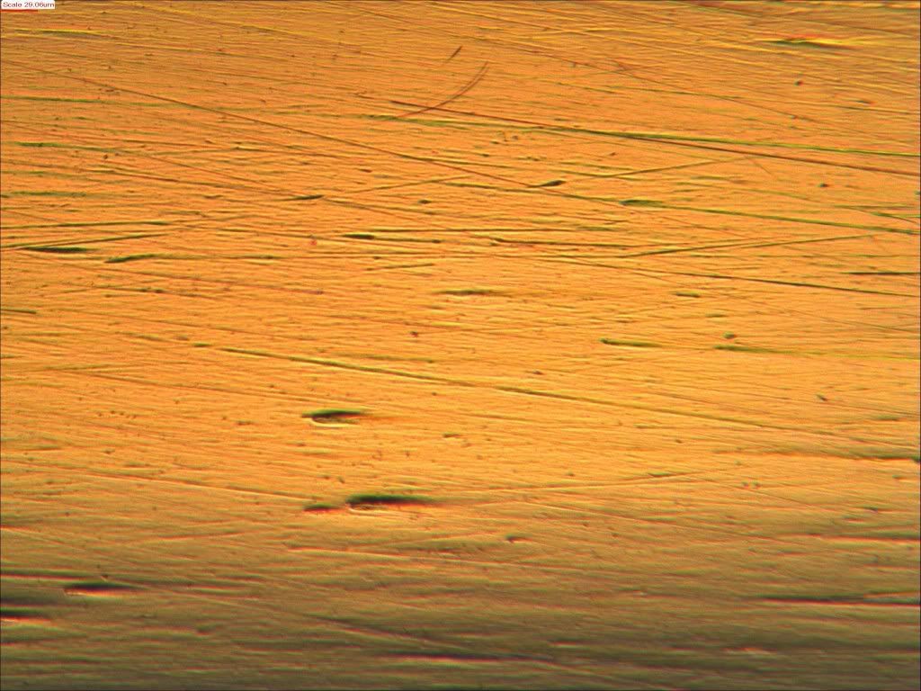

Here's the steel
Steel_3.jpg~original
and the knife edge to start
CS_160_1.jpg~original

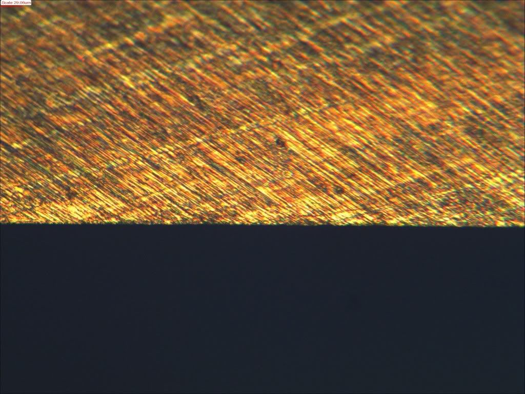

and again a bit closer
CS_640_1.jpg~original

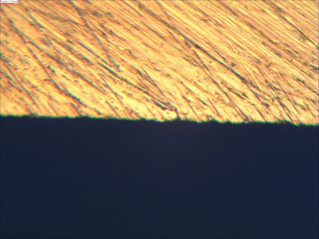

Here it is after the dozen or so passes. Note the very consistent grind pattern angle from the waterstones (if I do say so myself) is becoming erratic - clear evidence even the smooth steel is getting busy.
CS_160_2.jpg~original
And closer
CS_640_2.jpg~original
Now it could dry have with almost no felt tug at all, skin was very smooth where it had been. Couldn't whittle my hair, but very close based on how much the hair was dancing along the edge. another twenty or thirty passes on newspaper or plain leather and it would likely have been there.

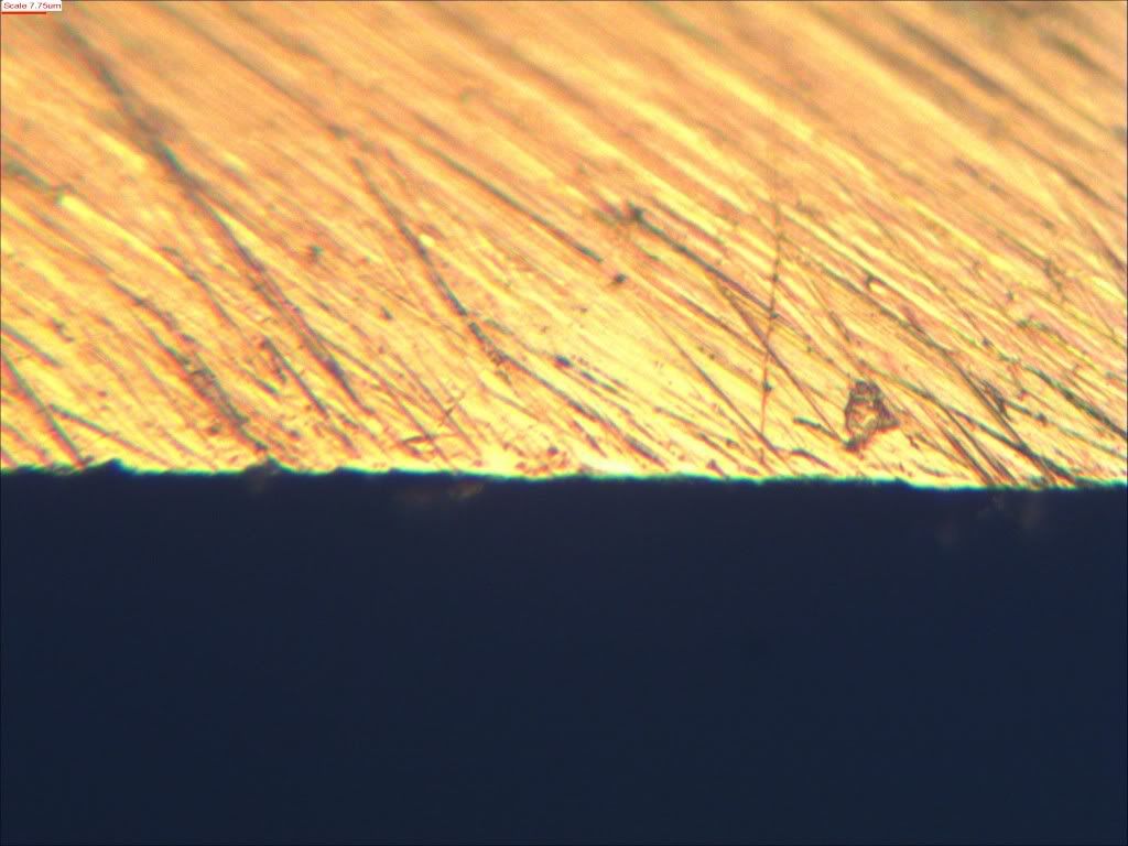

I gave it another twenty five on the steel
CS_640_3.jpg~original
Edge quality is going downhill at this point, tho still very sharp - could dry shave facial stubble nearly as well as the original condition and crosscut newspaper with a whisper. The pics tell the story pretty well. Edge doesn't look as good as it did off the waterstones and cut quality has degraded a like amount. You can also see further degradation of the once-orderly grind pattern.
Here's what the steel looked like after about 70-80 total passes - pretty rough but not really surprising at this point in the conversation. Keeping in mind pressure was as light as possible and still maintain contact.
Steel_4.jpg~original
Overall I have to say I prefer the results from the rougher steel. The smooth one took it up a notch, but couldn't keep it there or improve beyond a small amount. This is as far as I can go without spending some money on a top shelf smooth steel, and I already am feeling entitled to buy myself a new knife to make up for the unnatural wear and tear I've inflicted....Thanks to Stitchawl for inspiring this and everyone else for keeping it informative and useful.
