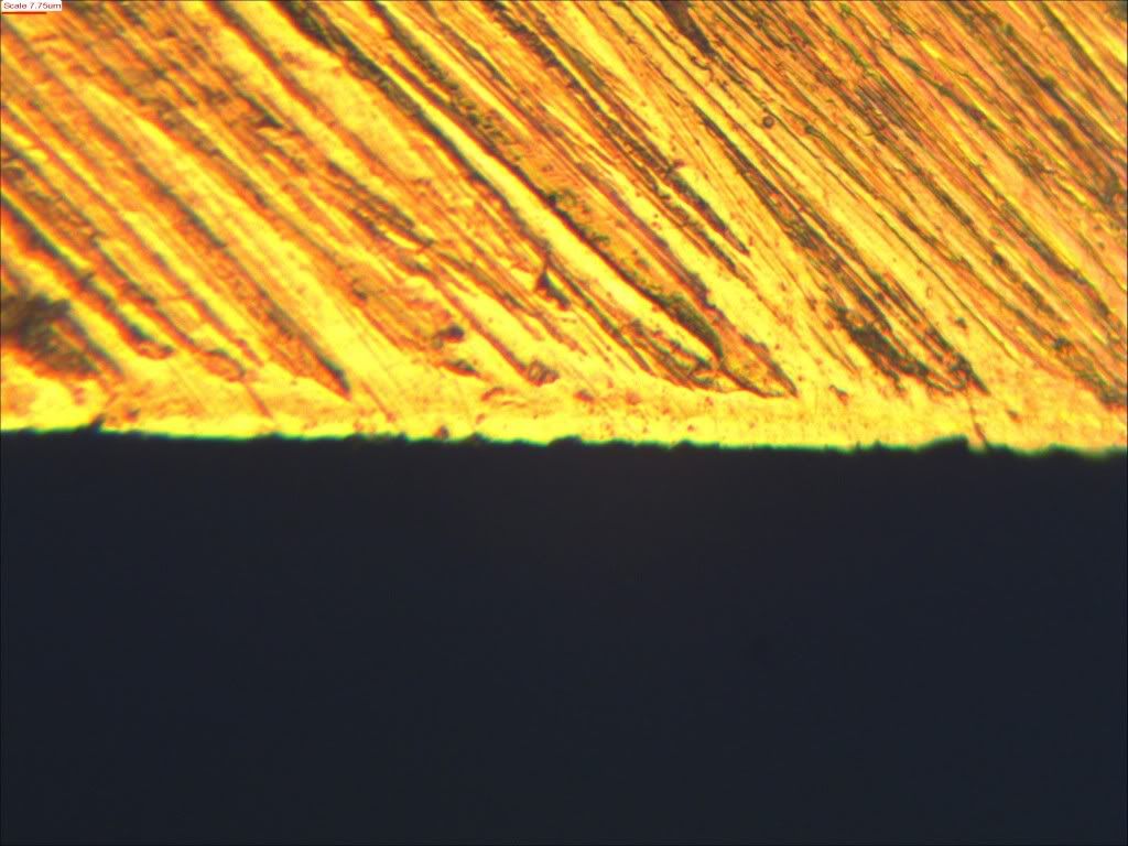

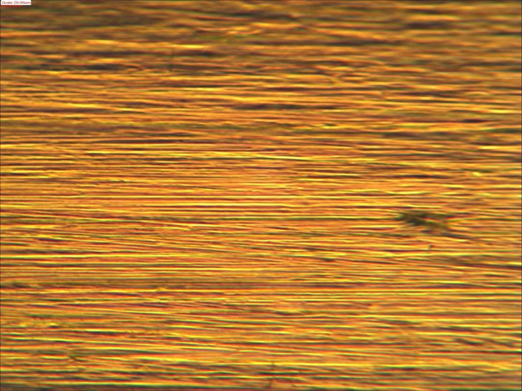

First pic is of the reconditioned drill rod, I polished and finished it exactly as I did the Foster Bros, but have gotten very different results.
Steel_I_160.jpg~original

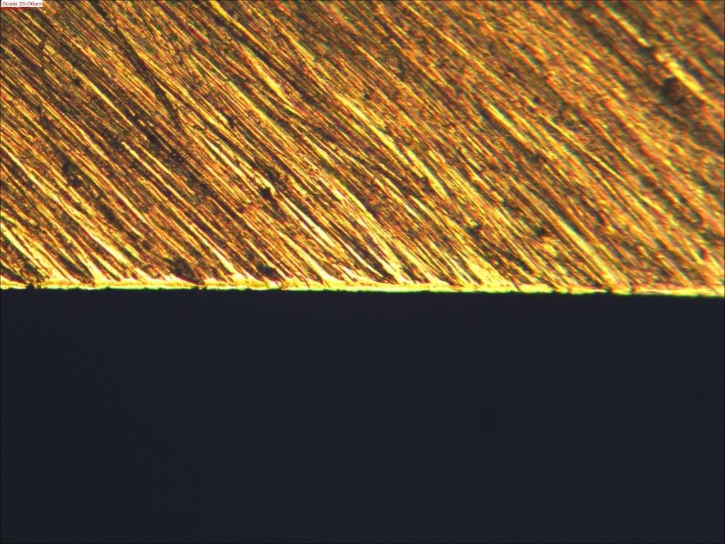

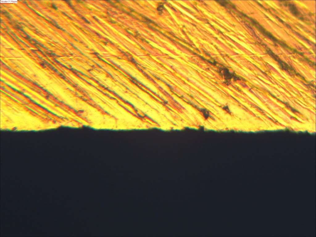

Second pic is of the Aus8 with 5 passes on this steel
E_640_1.jpg~original
Third is with 50 passes - starting to look pretty rough
E_640_2.jpg~original

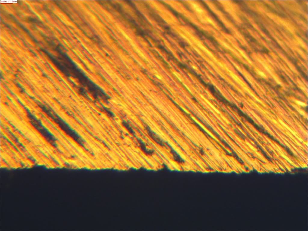

Fourth is after 100 passes - now very rough and with what I would consider an unacceptable amount of burring - visible at this magnification as that sort of leafy effect - far more visible to the unaided eye, This edge needs repair. I may have to put it on the Foster Bros and see what happens...
E_640_3.jpg~original
Wanted to have something known to compare it to, sooo, put my freshly resharpened EKA to the steel once more
First is with no steeling prepared as before. I'm getting better at this, could just tree-top some leg hair off the fine Crystalon and stropped on a mix of swarf and oil on newspaper.
F_640_1.jpg~original

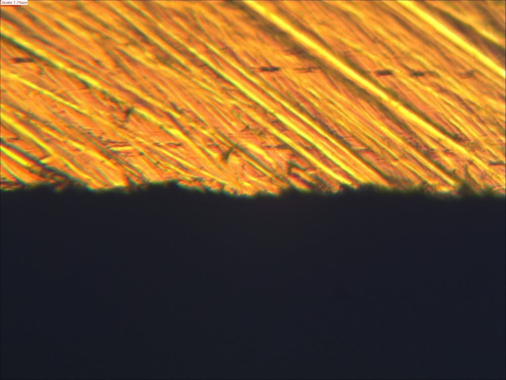

Now after 6 passes on the steel - I caught sight of some interesting metal formation. Dead center you can see where the metal has been swept up and is partially burying the original grind. Scratch pattern is smaller, but apex is less uniform.
Second pic with focus shifted to make the formation more easily recognized. This is looking more like the rod has enough abrasive quality to push the steel around and produce some deformation, but not enough to carve the affected metal free of the surface.
Tentative conclusion, different steels can work an edge differently not just based on surface prep (both steels were finished identically - pics of the first one to follow). The second series with the same knife from the original pics looks totally different. Based on this I cannot even say that the Aus8 is behaving any differently than the Sandvic on this steel. If one is going to improvise a steel, it might be best to do as Stitchawl did and go with unhardened steel from the local hardware store or go right to a very smooth laboratory glass. Just have to figure out why the other steel produced a desirable result and this one needs to go in the scrap bin...

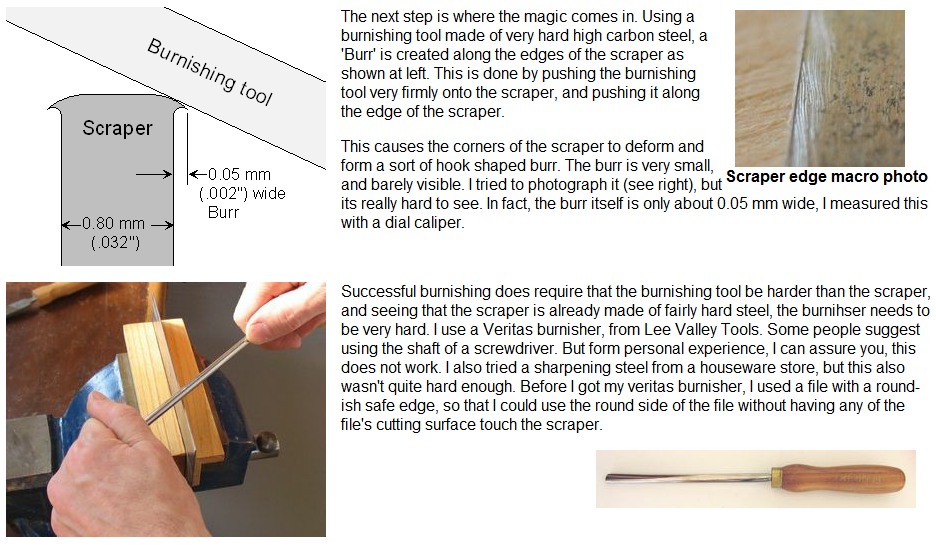

You guys probably know this, but just in case you don't:
Wood-workers use a burnishing tool on their cabinet scrapers. This is very similar to steeling, and is discussed in the book, _The Complete Guide to Sharpening_ Leonard Lee. This book is mostly targeted at woodworkers, so this makes sense.
http://www.amazon.com/The-Complete-...=sr_1_1?s=books&ie=UTF8&qid=1337831507&sr=1-1
You can also read about burnishing a cabinet scraper in many websites on woodworking. For example, here is a snippet from the website www.woodgears.ca:
http://woodgears.ca/scraper/index.html
It might be worth seeing what woodworkers have experienced and advise about burnishing scraping tools. And I wonder if a burnisher is significantly different from a smooth knife steel.
This could also be similar to bluntcut's request that we steel a corner edge of a knife, such as on the spine. Steeling the edge of a scraper is not the same, but it may be closely related.
Sincerely,
--Lagrangian
I believe that the goals the woodworker and his cabinet scraper are actual deformation of the edge. In the article you quoted;
www.woodgears.ca:
... it states; '...this is done by pushing the burnishing tool very firmly onto the scraper, and pushing it along the edge of the scraper.'
This is in direct opposition to the use of the steel with a knife edge. We don't want to press them together 'very firmly.' We want very light contact. Now, this could be because when sharpening a cabinet scraper, one first forms a square surface, then draws a burr from a corner of that square, rather than first starting with an acute apex edge. I can certainly imagine what would happen to said acute apex edge were I to 'push the burnishing tool very firmly into it!'

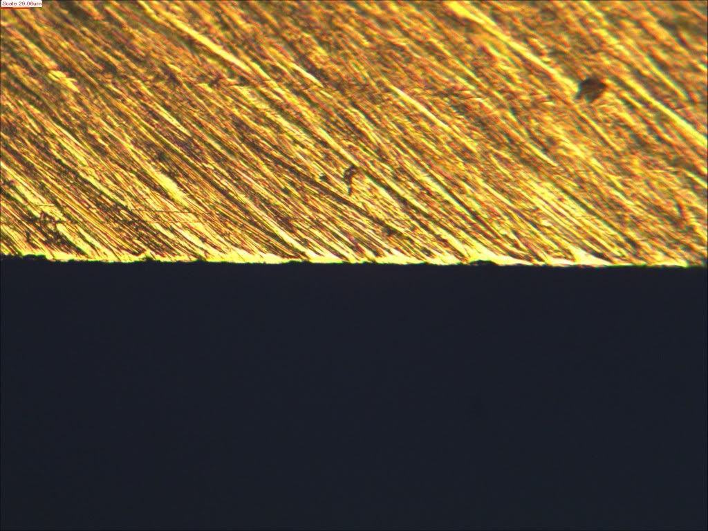

OK, here's the latest. I took the Aus8 blade that had been abused yesterday and gave it another go on the better steel, after I gave it a few lengthwise pases on a finishing wheel (Norton Bear tex 1-8SF). This eliminated all radial scracthing from my first "reconditioning". I later did the same thing to my drill rod 'steel'.
This allowed me to do some very nice recoveryy with the Aus8. This pic at 160x is the exact same from the last set of pics, the only thing I did was about 50 passes on the steel and few swipes on paper to clean it up. No burrs in evidence. looks a lot like the first series on pg 1
Aus8_160_1.jpg~original
And at 640, the edge seems to have recovered nicely and cuts very well. It may be weak as can be, but I don't think so. Any process that can remove the old burr can certainly expose fresh steel at the apex - time will tell.
Aus8_640_1.jpg~original

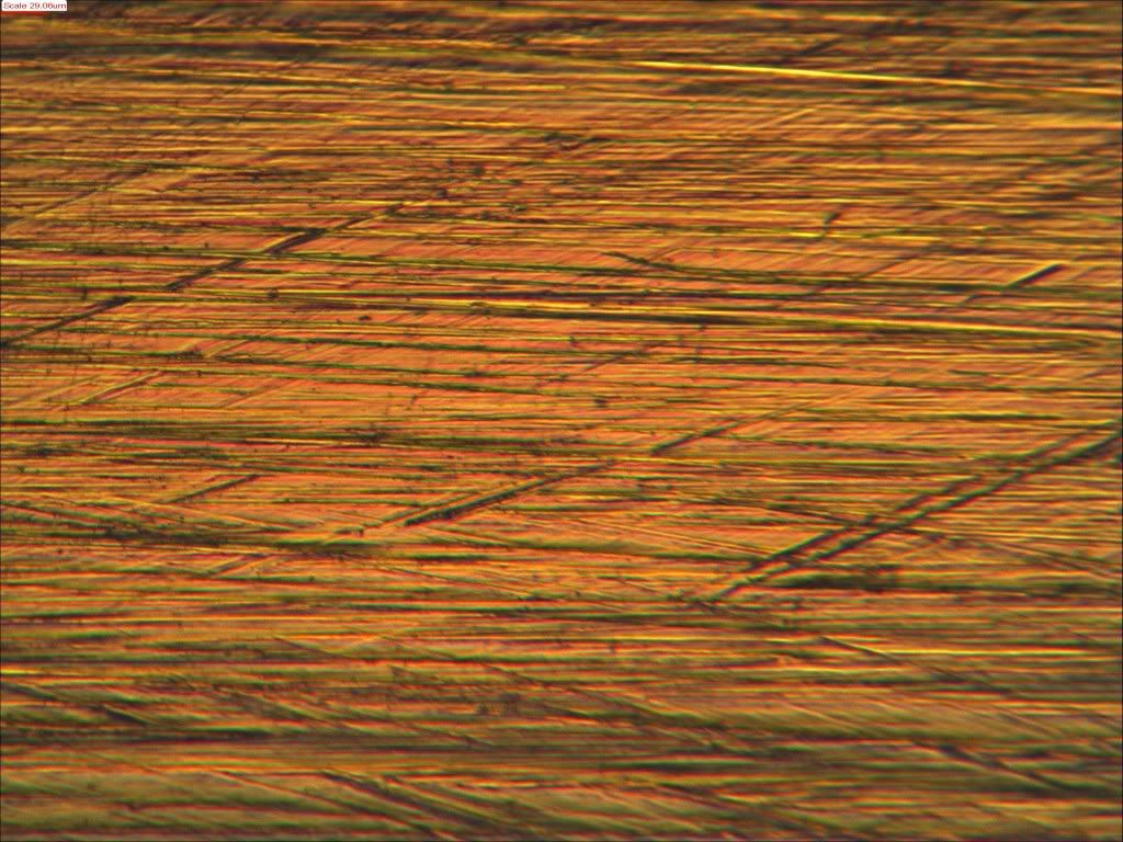

And here's the steel before
Steel_I_160-1.jpg~original
And after. These are of the drill rod, but the Foster Bros looked identical so didn't bother.
Steel_I_160_2.jpg~original
Tentative conclusion - the steel is acting a microhone, whether it be using plastic flow or not, the huge difference in results based on alignment of the grooves/ scratch patterns on the steel made a huge difference. I now wonder if any of hte commercial "smooth" steels really are - might be nice to take a close look at a high-end one out of the box.
